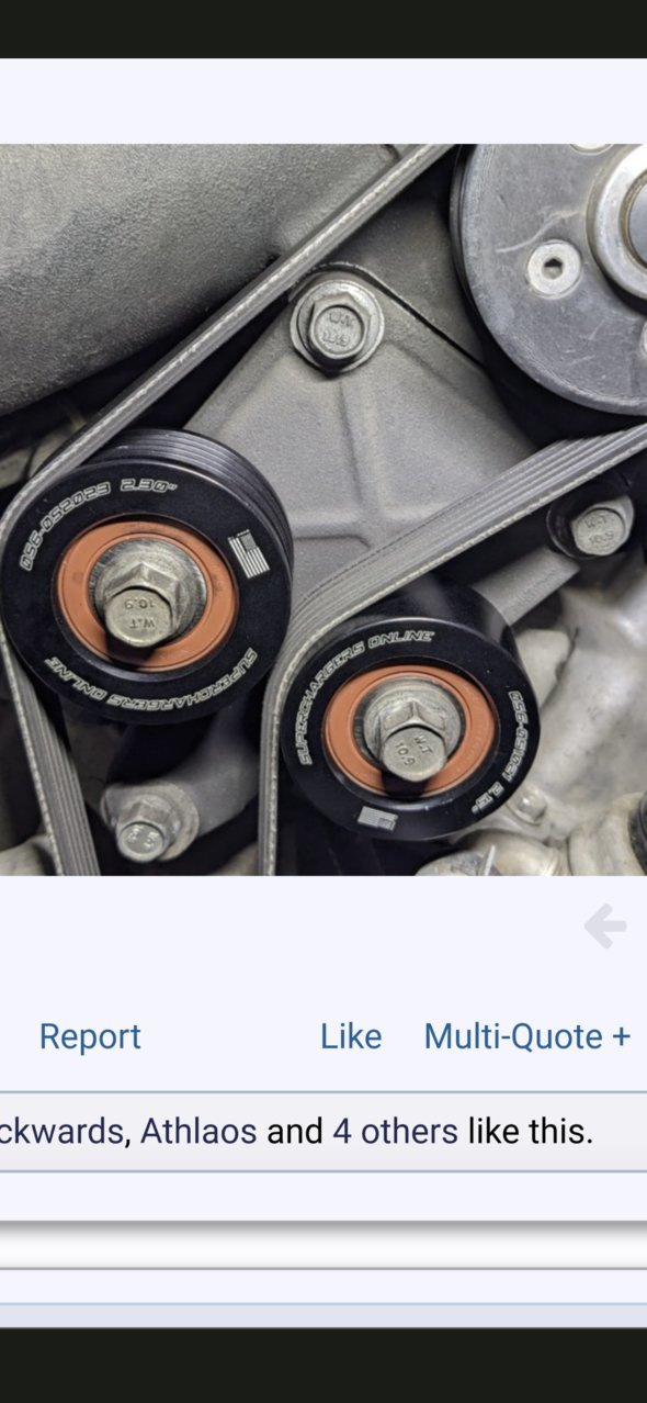

    Screenshot_20230118-001841.jpgMy idlers are failing. Page one has ceramic bearing replacements for these, but have we determined if it's possible to replace the bearings without buying the entire thing from SC online?

    I haven't quite gotten to the point of replacement on these yet. You may want to hit up SCOL for info on bearing replacements because they indicate that they are double bearing rollers, and when I looked at them prior to installing them, they seemed like they were special. Not your typical double bearing style rollers where they are literally using two, bit more one case with two rows built into it, hence the "double bearing" name they gave it.

    I must have missed that SCOL has replacement idlers. Is there a link to these or can we add to sticky page?
  10. Jun 11, 2023 at 7:17 AM
    wrmathis
    wrmathis Dark Lord of the Sith
    Sep 10, 2008
    #9126
    9,460
    Bonaire, GA
    2006 Tacoma TRD OR 4x4
    parts and stuff
    u gotta email/call them and ask to get them. not on their website

    cool, if it’s like other items we have bugged them about like crank pulley pins they will add later after we all have them

    Yeah, right now they are not the hottest of items on their site as far as sellers are concerned, but after running them I definitely feel more comfortable about having them over the OE idlers.

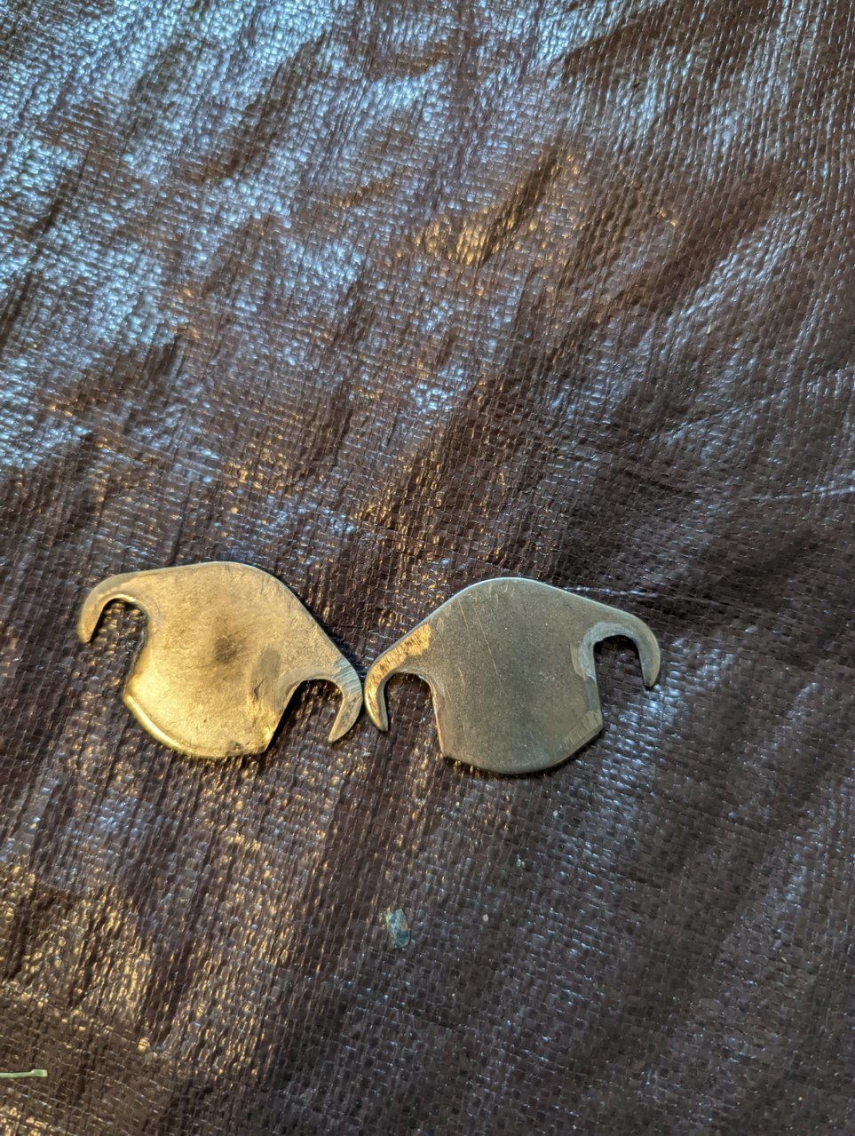

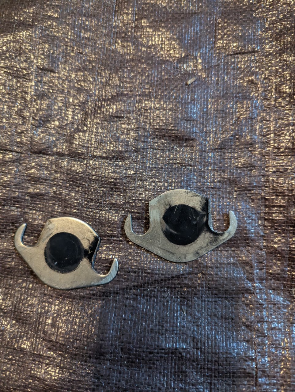

    SAIS Header side block-off plates
    $5 shipped
    TheFang likes this.
