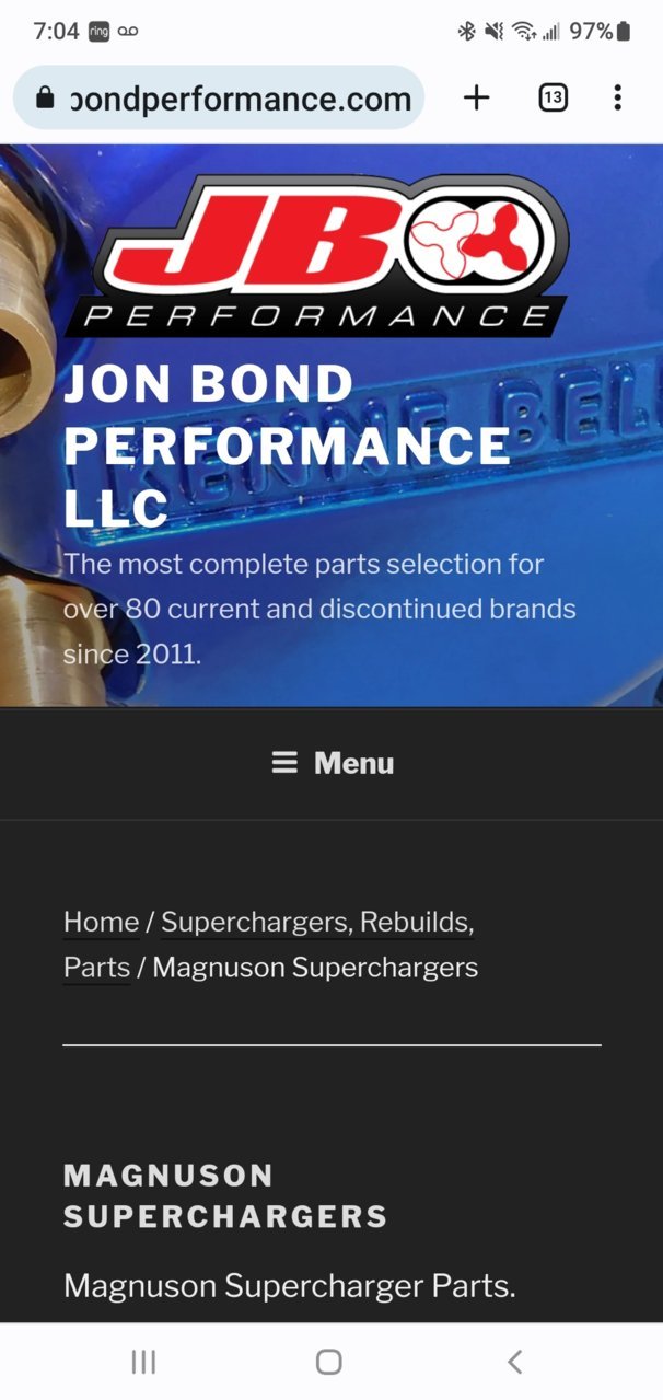

    Screenshot_20230620-070428_Chrome.jpgWhat about this guy I think they do the same work as SCOL for way les.
    Maybe because SCOL is in California and everything overtheir every thing cost way more!

    Done of the 1st gen guys use JB. I have no experience though.

    Jon Bond did my s/c rebuild a year or two ago, Quality work but not the greatest at communication or timeline. Per my back and forth with them only one guy in shop did our model and I got the impression he didn’t work full time so it took a while longer than expected when he got busy.

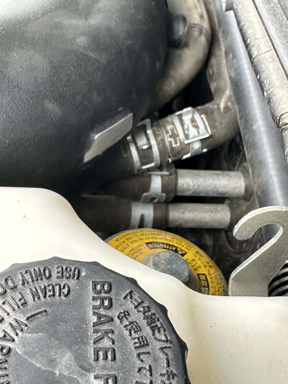

    Should I just rotate this clamp or should it be zip tied to the hardline coming out of the firewall?

    Rotate the clamp

    Thanks @Lucario Runner, wasn't sure if I should zip tie it too...belt and suspenders since it still sits close with the clamp rotated.

    I rotated the clamp and put some thick almost padded electrical tape around them for good measure too.

    That the one that has rubbed into some people's SC bodies? I rotated the clamp and covered mine with a cut up chunk of hose.

    I rotated and added a zip tie. On my truck the hose was rubbing through, on my dad’s truck it wasn’t. So I would just check it out and see if you need something to stop it from rubbing on the housing.

    Yes - it had rubbed at small noticeable area through the SC coating. Luckily not deep or through it yet.

    Mine was rubbing ever so slightly. I never had a big issue with mine like some of you did yours.
