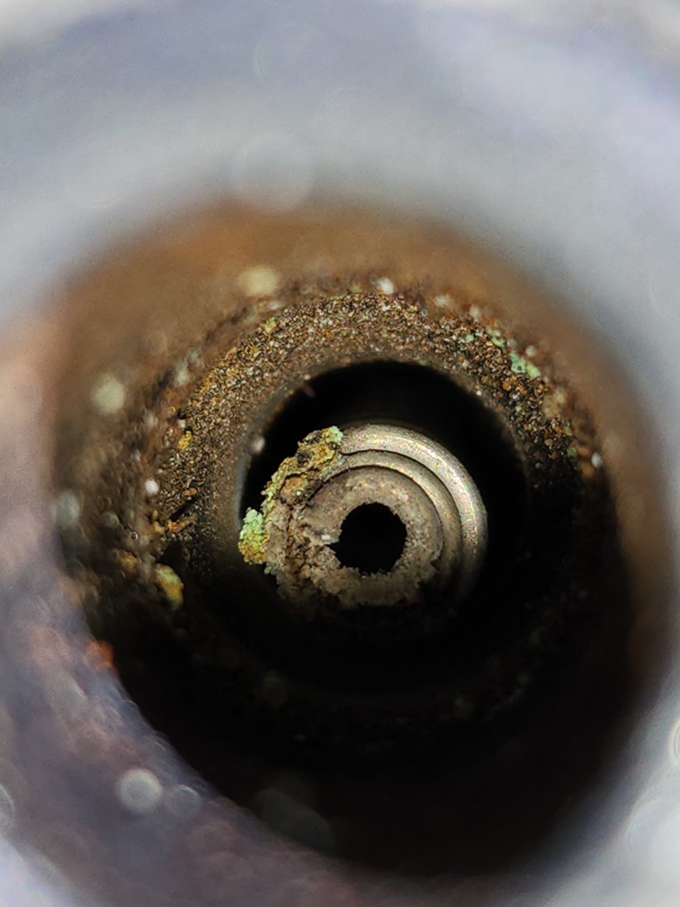

    Ok @12TRDTacoma ..... you friggin' jinxed me.
    As of a couple hours ago, I'm 99% certain I have a bad RIPP coil. Truck popped a P0305 code after a fuel fill up. Check engine light was on, truck was sluggish, engine idled super rough, etc....
    Picked up a single ngk LFR7AIX-11 plug. Cleared the CELs, installed new plug in CYL5....and it popped the P0305 code within a minute. Killed the engine.
    Installed stock coilpack back on Cyl #5....kept the new ngk spark plug. No CEL...smooth idle... going to go test drive.
    :angrygirl::annoyed::frusty:
    Update: drove around for <10 miles... back to normal.
    RIPP coil pack were installed June 2022 and had about 7k miles on them.

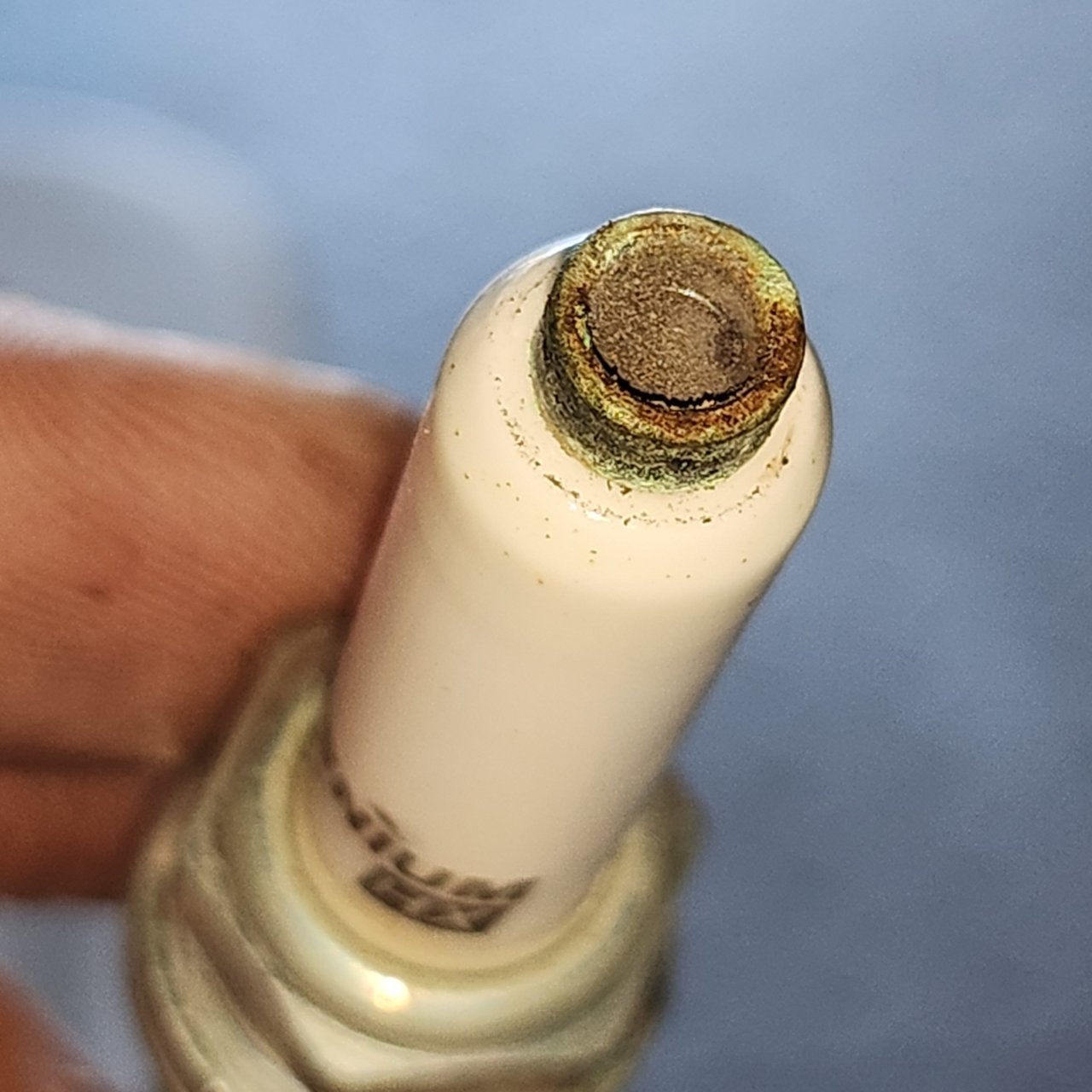

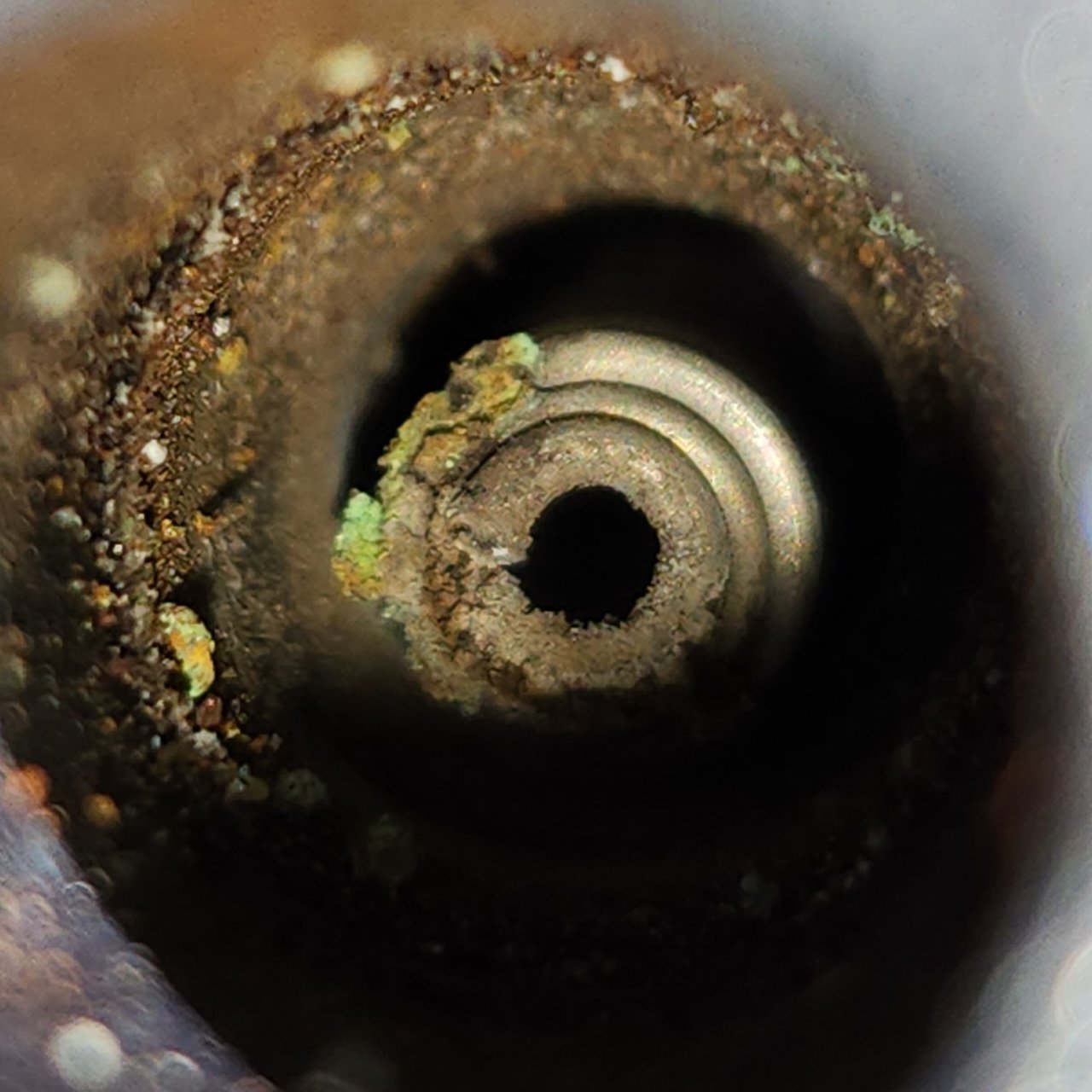

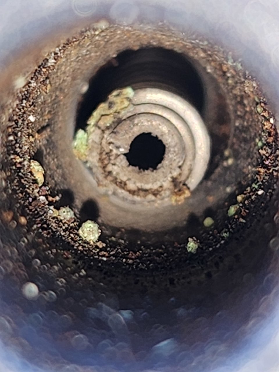

    This is what I see when I peer down the coil boot of a RIPP coil pack that gave me P0305 (CYL #5 misfire) problems.

    eeek that is not looking great. Any though of just RIPP packs or RIPP and the Ruths? I honestly do not have many miles on mine yet but that does not look good. Surprised for you @SUMOTNK you have not had them that long.

    I'm surprised that it looks so yuck for something that fit so snug. Really don't think that it was caused by moisture or dirt, etc..
    As for the Ruths....I'll be switching them all to the ngk that's in CYL #5.

    @SUMOTNK that looks like the terminal is long arcing /too hot based on all the splatter and not necessarily a failure in coil other than the distance. You could technically clean with contact cleaner and reapply die electric. Or listen to everyone about dead coils..
    But I've always been skeptical that the ruthenium terminal could be short ended yet people ran them with success
