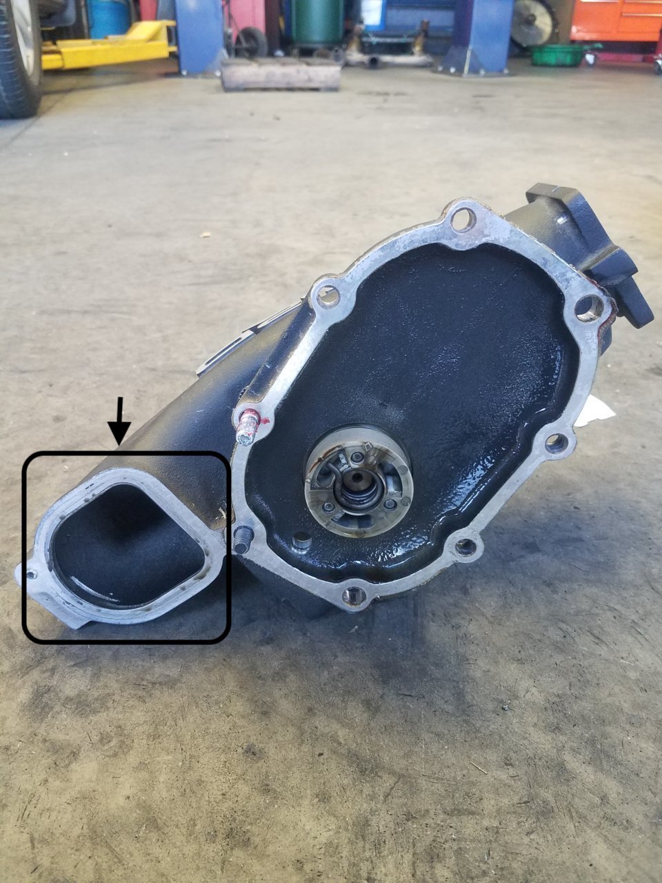

    Anyone know the part number or where to get a replacement o ring or D ring for the supercharger snout to intake end circled in picture?

    Comes in the Toyota S/C oil service kit, PTR29-35073.
