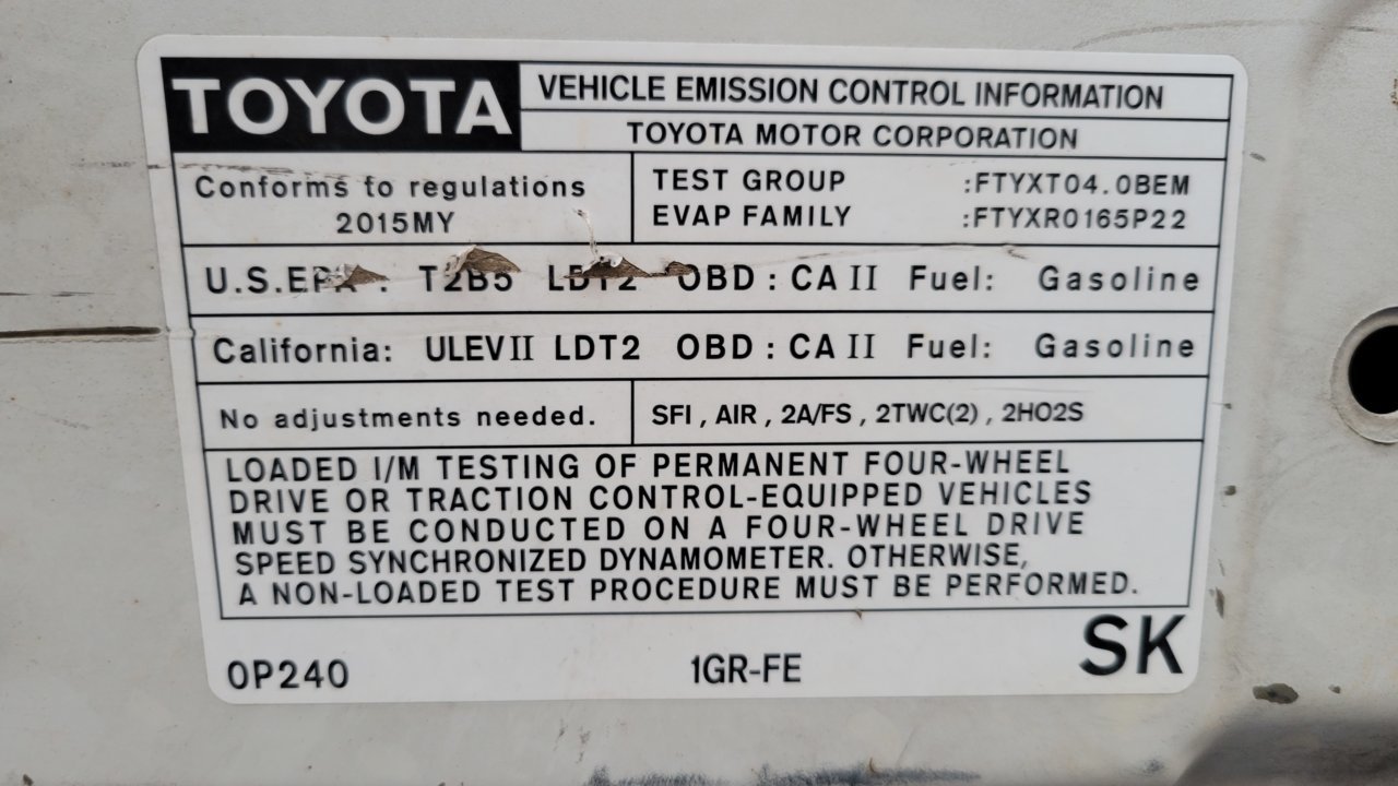

    then i guess the question is, does anything on this label under my hood tell them 4 cats rather than 2? xD

    SFI - Sequential Fuel Injection
    AIR - Secondary Air Injection System
    2A/FS - Not sure (probably related to the above..)
    2TWC(2) - Two primary three-way catalysts and 2 secondary three-way catalysts,
    2HO2S - Two Heated Oxygen Sensors

    thanks, im just now finding this stuff online. it looks like theres no way to BS them about the number of cats, and i dont like the gambling aspect of all this. some places will look the other way on minor things such as secondary cats, intakes, etc.. others won't. i'm just gonna take it to a muffler shop tomorrow because the magnaflow exhaust i have may not line up in the oem spot with the 2-into-1 factory y-pipe/join-pipe that i got from prior owner (the bits with the secondary cats in them). i know a good place which did the muffler delete on a C7 i used to have. i'm all about throwing money at a problem.
    ugh. commifornia. still trying to convince my gf to move to texas =D
    also found stuff like this;
    OC - Oxidation Catalyst Only;
    TWC - Three-Way Catalyst;
    TWC+OC - Three-Way Catalyst + Oxidation Catalyst;
    * EHOC - Electrically Heated Oxidation Catalyst;
    * EHTWC - Electrically Heated Three-Way Catalyst;
    WU-TWC - Warm-Up Catalyst with Three-Way Catalyst;
    WU-OC - Warm-Up Catalyst with Oxidation Catalyst;
    AIR - Secondary Air Injection (Pump);
    PAIR - Pulsed Secondary Air Injection;
    CAC - Charge Air Cooler;
    SC - Supercharger;
    TC - Turbocharger;
    DFI - Direct Fuel Injection;
    IFI - Indirect Diesel Injection;
    CTOX - Continuous Trap Oxidizer;
    PTOX - Periodic Trap Oxidizer;
    * FFS - Flexible Fuel Sensor;
    O2S - Oxygen Sensor;
    HO2S - Heated Oxygen Sensor;
    EGR - Exhaust Gas Recirculation;
    EM - Engine Modification;
    CFI - Continuous Fuel Injection;
    MFI - Multiport (Electronic) Fuel Injection, (Central) Multiport Fuel
    Injection;
    TBI - Throttle Body (Electronic) Fuel Injection;
    SFI - Sequential Multipoint (Electronic) Fuel Injection; and
    SPL - Smoke Puff Limiter;

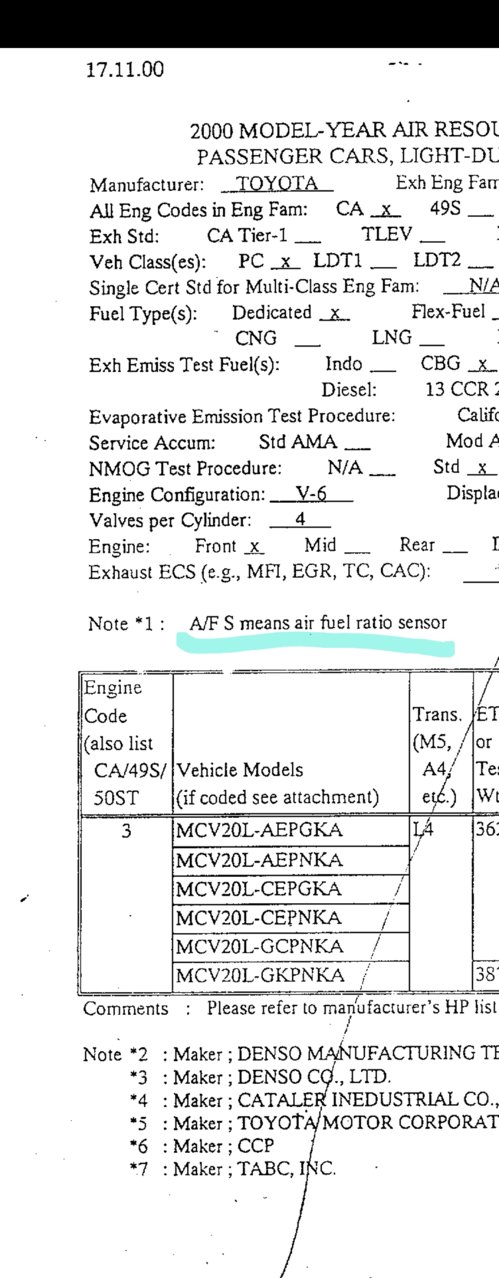

    2A/FR is Two Air-Fuel Ratio Sensors

    Makes sense given the abbreviation. Any chance you have a source that outlines this one?
