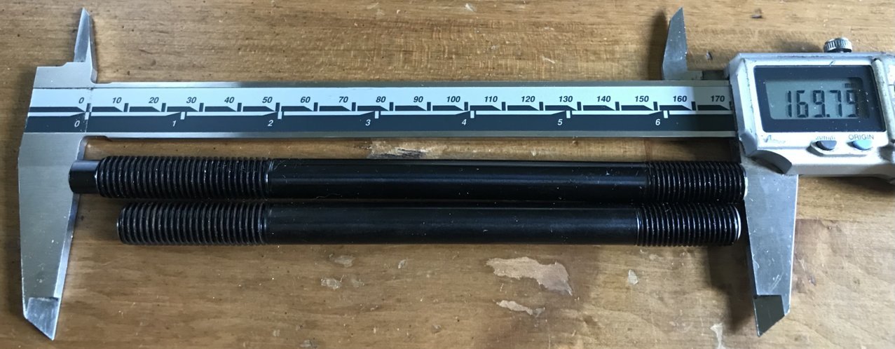

    Here are a couple more ARP Head Studs that may work for the 1GR, as they work for the 2GR and 3UR V8. Both have more thread engagement with the block, both are ARP2000.
    The top stud is for late build 2006 and up 2AZ-FE, kit 203-4306. Overall length is about 6.7”/170mm, but again, most of that extra length is where we want it. Thread engagement is a generous 1.7”/43mm plus the nub.
    The bottom stud is for the 3UR-FE, kit 203-4704. It measures 5.98”/152mm. Thread engagement is 1.45”/37mm. As far as I can find, the commonly used 5.95” stud has about 1.25”/32mm of thread, so the 5.98 won’t protrude as far past the nut when installed, but will grab deeper in the block.
