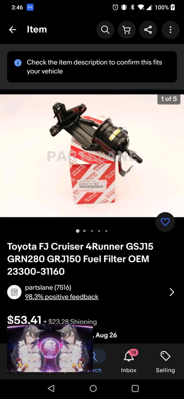

    Yeah I made a bracket but literally have zero room between the frame tank and Atlas, I already rubbed a hole in the first filter mounted here lol, wiggled into the path of the tcase flange. Used a hose clamp and a shit ton of zip ties to put it further away from the flange, but now is even closer to the exhaust, under the hood would be waaaaay better, if possible.

    Could run the fuel filter from the overseas fj cruiser

    Where is that one located?

    Engine our driverside I believe

    Shouldn't be that difficult. I bought something from the uae Middle East area and it arrived in like two days and was cheaper shipped then any dealer stateside.

    Interesting, looks to have some special fittings and likely would not bolt right up. Ill see if I can find a diagram and see what else would be involved, thanks for sharing.
