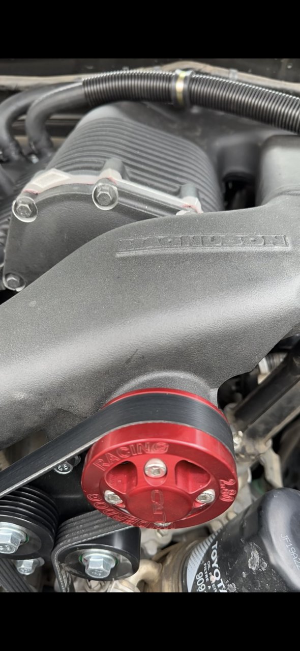

    Also does anyone have the snout cutter for the 2.8 pulley they whore out like the ecgs bushing tool?

    Which pulley? I'm running the URD quick change with a 2.8 and didn't have to cut the snout.

    Oh nice, I assume the quick change pulley holder just presses on like normal? Then you can swap pulleys on the fly?
    Is the snout cut only needed for stealth pulley?

    Correct
    Not sure if the stealth 2.8 needs it but I believe it would be needed if I went smaller than a 2.8 on the quick change.
