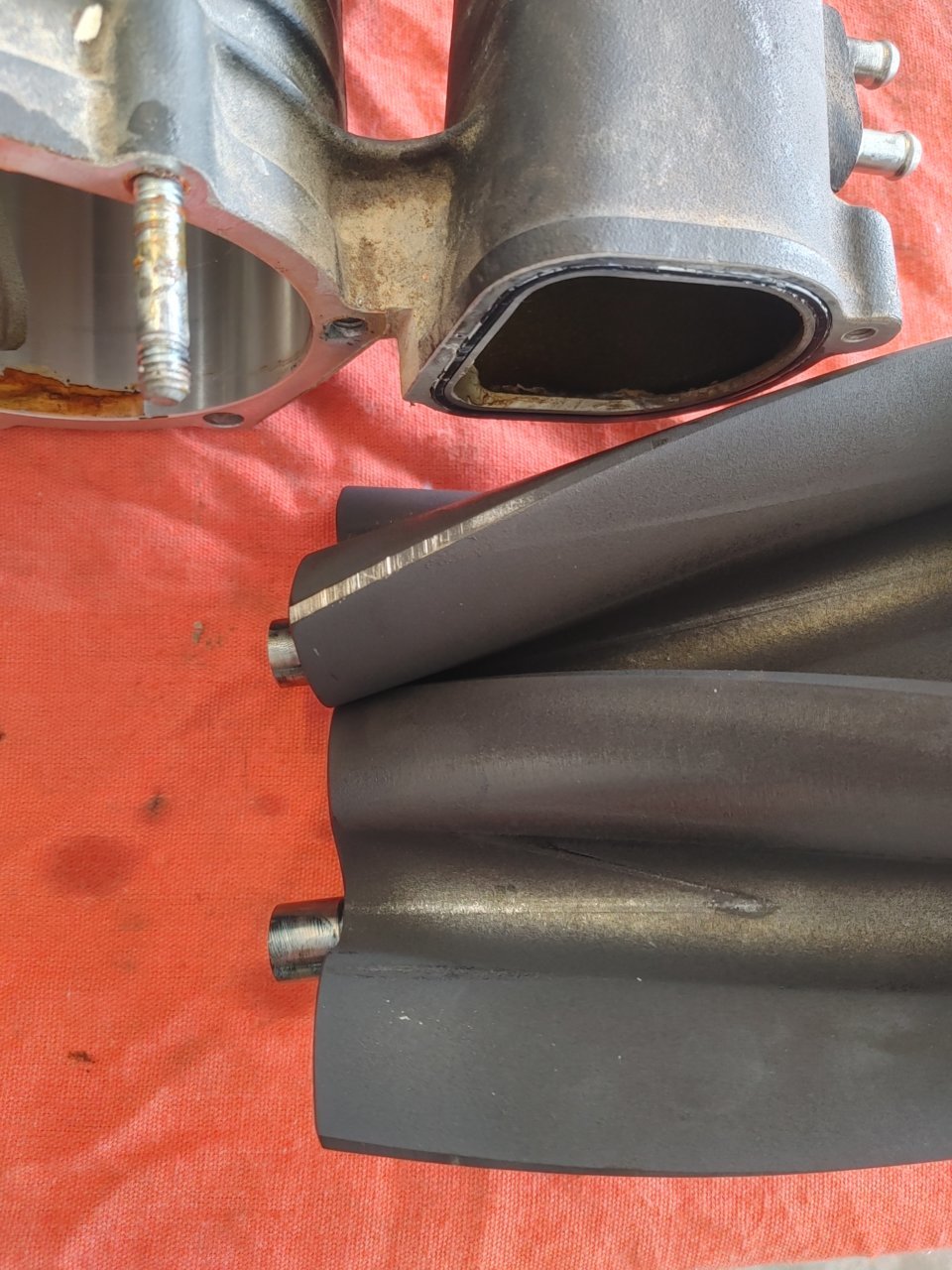

    Got her home, looks like 2.8 pulley already installed? Measure from inside ribs. Back side has no room to go any smaller.

    Could be a stealth 2.8 but looks like the OG pulley. Is that dirt in the middle or a broken bolt? That’s going to be a pain.

    Just some mud.

    So not gonna lie, sounds like rocks when spun by hand. Pulled it all apart and nothing looks bad so far, rear of rotors have some touch marks, no metal in oil, oil was clean. Noise was from rear where needle bearings are, by finger they feel ok, need to bring home inside bearing puller to remove. Im guess rear bearings are worn and causing back of rotors to barely touch maybe?
    He said it always pulled hard before he wrecked it, i trust him.
