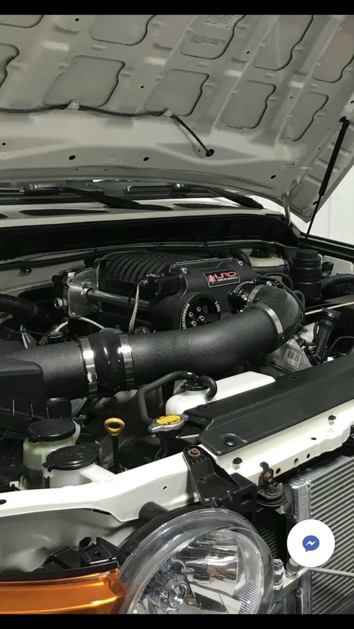

    Once you take of the urd logo that thing would look fucking cool.

    Thats where the thread is

    K&n, flowmaster, plastidip, chipped, hids, daves
    deleted my comment after I seen the print at the bottom.
    I thought it was just text in his sig :anonymous:

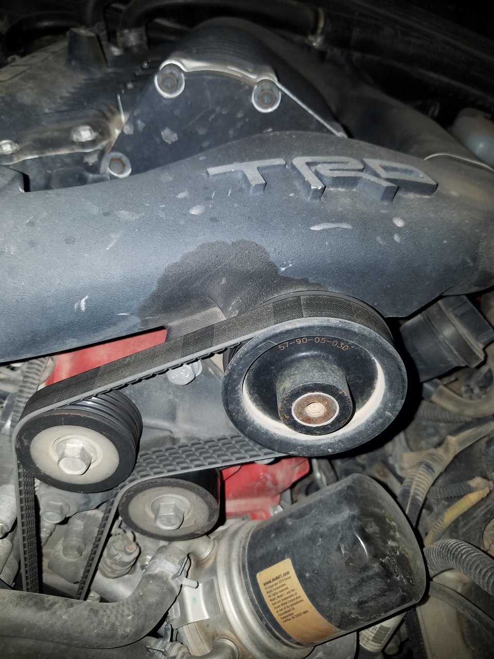

    So all 3 idlers are toast. Anyone know where I can buy bearings or the pulleys themselves? I came across a thread saying the bearing are OE specific and need a sleeve for the ID but I think it was for the regular pulleys, not the supercharger pulleys.

    Maybe pulley boys and wrap it in to your order?

    Just get new bearings and press them in.

    You can always get them from magnusun. I replaced one idler from them earlier this year. Don't remember how much but wasn't too expensive

    Wonder if they sell the nose gasket too? It's not leaking but looks like maybe blow-by?

    I talked to them for a bit when I was trying to order the pulley. I was gonna get a nose cone rebuild kit, but they only sell the whole nose assembly. They seemed pretty helpful and willing to sell most parts or assemblies separate from the whole s/c. I'd imagine the gasket would be available.
