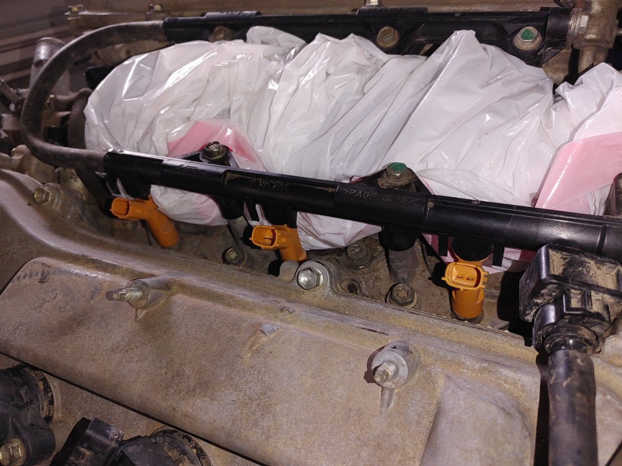

    make sure you replace the injector o-rings as well. worn seals cant leak, causing mayhem.

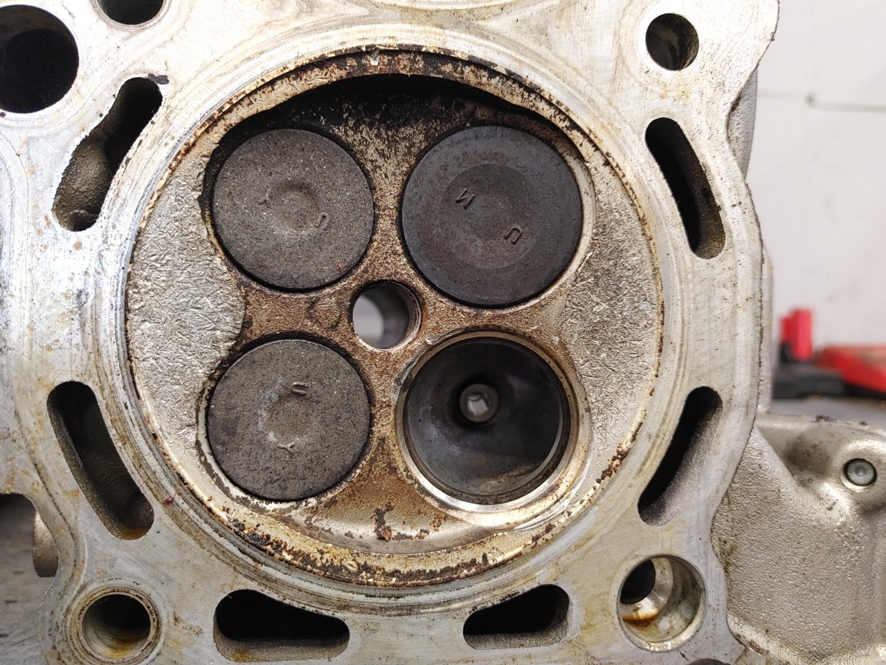

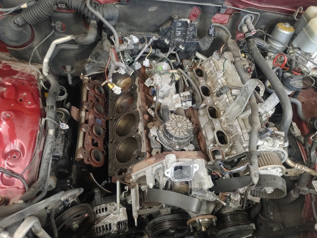

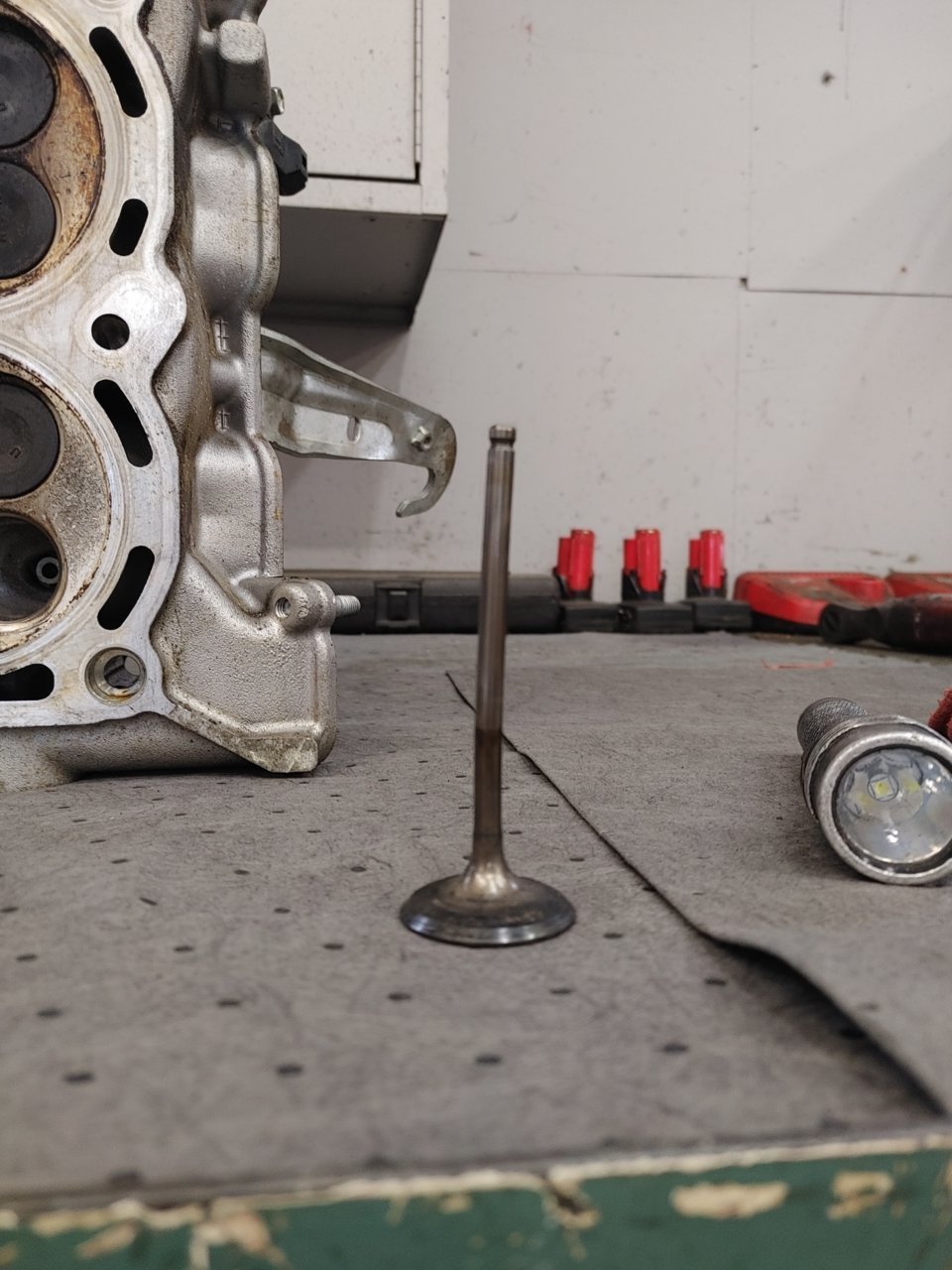

    Also dont lose bolts when you take intake off like my coworker did on a 4.7. I get the pleasure to tear it down and see what he fucked up.

    Damn, that valve is bent like the tower of Pisa! Is the guide destroyed too?
    Look at the valley on that 4.7L! Chock full with starter and smog pump. Is that Toyota’s way of rodent prevention?

    Thats what I was worried about, the guide being wallowed out. Old lady drove it long enough with a dead cylinder to melt the cat.

    I believe the replacement injectors part number from toyota is PTR24-35071. Just so you know it's $130 per injector. Toyota of decatur is having a sale at the moment for 25% off all toyota parts. I would see if you can find a shop to rebuild/clean them. It'll be a lot cheaper.

    I might hit em with the power probe to see if they all click. 100% duty cycle lol
