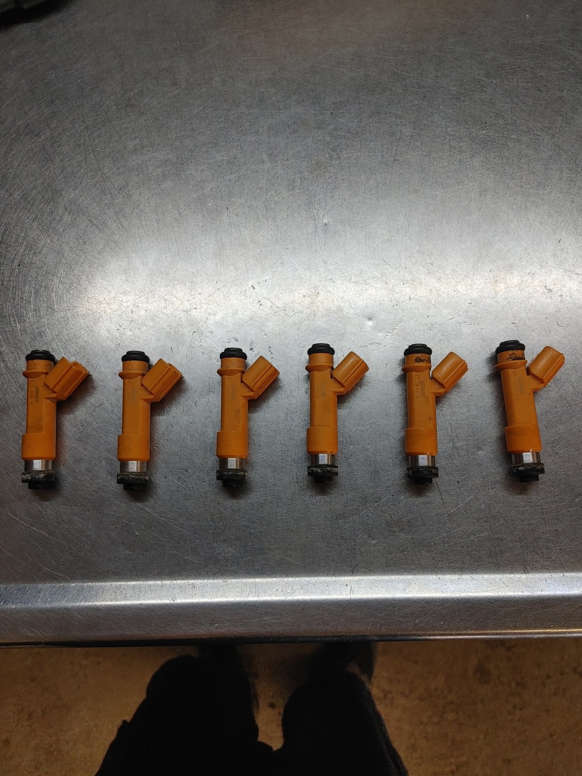

    Took injectors in at lunch, he just called and said 3 were leaking but was able to clean them all out. 150$ for some peace of mind. Going to order my 2.8 pulley, and urd fuel pump kit next week. A new water pump for the engine and tracking down some bearings for all the supercharger idler pulleys and I will be ready to have a fun weekend in a few months.

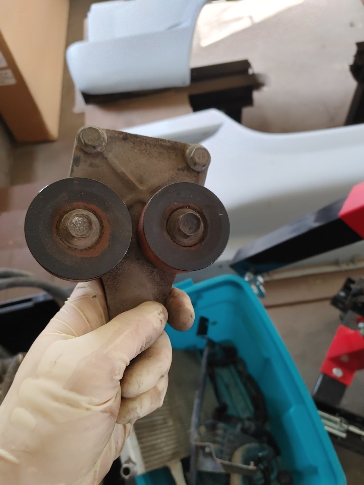

    I can dig up all the part #'s you need for the bearings. I recently did all the blower and engine bearings.

    Oh god yes I would appreciate that. Ive got the engine idler bearings done but the blower specific bearings Im having a time locating.

    Looks like this is your excuse to retrofit in a double bearing roller for your tensioner. ;)

    Maybe, want to put it in stockish form and adjust from there first.

    @IvanhoeTaco IIRC.. its:
    x4 of these...
    https://www.qualitybearingsonline.c...q2loKO261NeB-A6ogEkfzHS2RkMaW-8hoCWr0QAvD_BwE
    x1 of these...
    https://www.qualitybearingsonline.c...v1Brw5Ad1cfMZNEy_NLIiIElEg0uzIyRoCVLoQAvD_BwE
    I'm pretty sure those are the exact ones I ordered. When I get home I'll check to see if I still have the receipt or packing list, because there are a few iterations of the 6303 and 6203 bearings. I tried to document and or track it all.. but between the multiple threads here and multiple photos on my phone.. plus time that passed.. I cant remember the details. I'll look more into it later though.

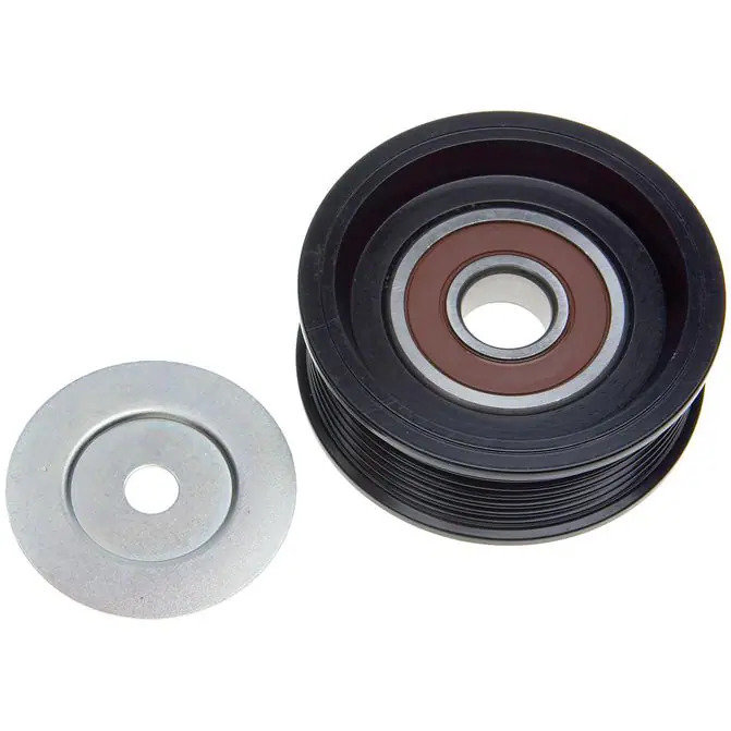

    Add those little bearing seal shields to help prevent or slow contamination. CF438EEB-EBFB-4C82-878E-4958C72DF9F1.jpg

    This is a good idea. I am on my second round of the Timken bearings. The first set flung a lot of grease out pretty much immediately and this second set seems to be holding up better but I am noticing they are starting to let a little bit out. That plus all the dusty conditions I drive in I think those might be worth investing in.

    Back from cleaning. Going to put them in with no lube and use 1/2 impact on fuel rail bolts to cram them in. 1004231240a_HDR.jpg
