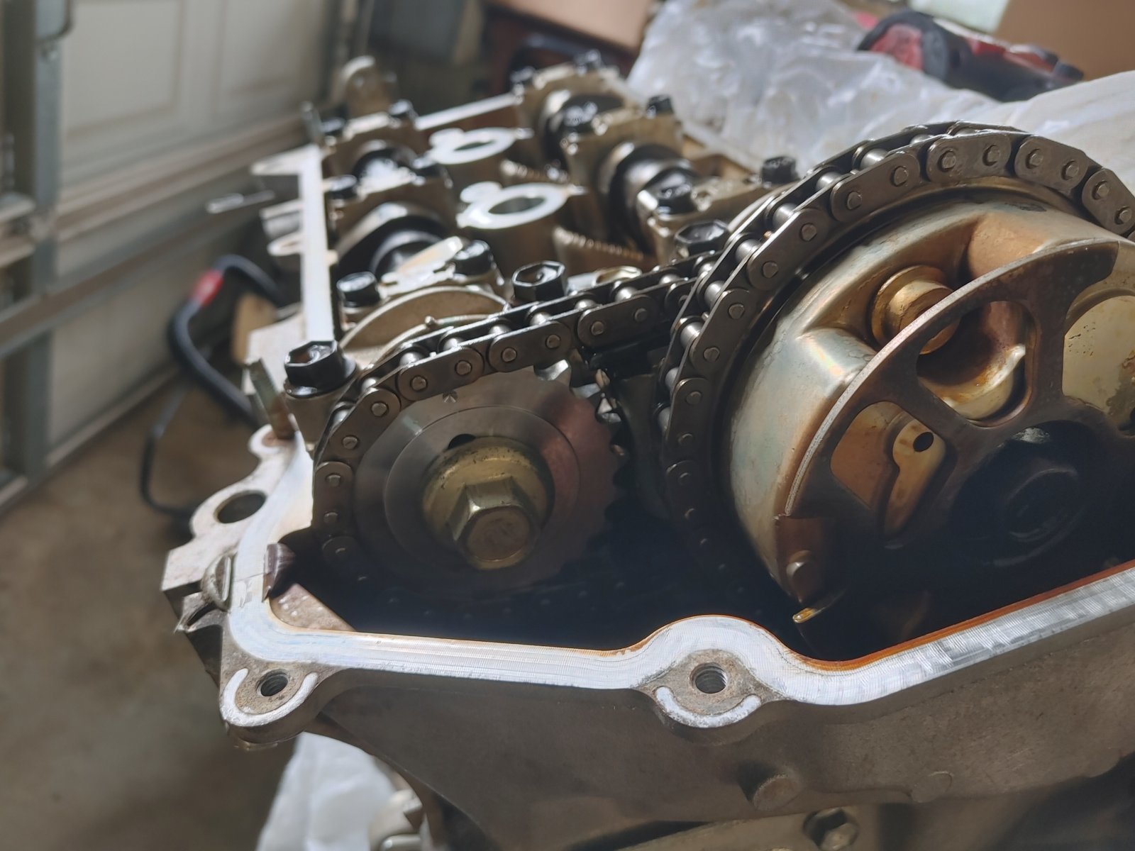

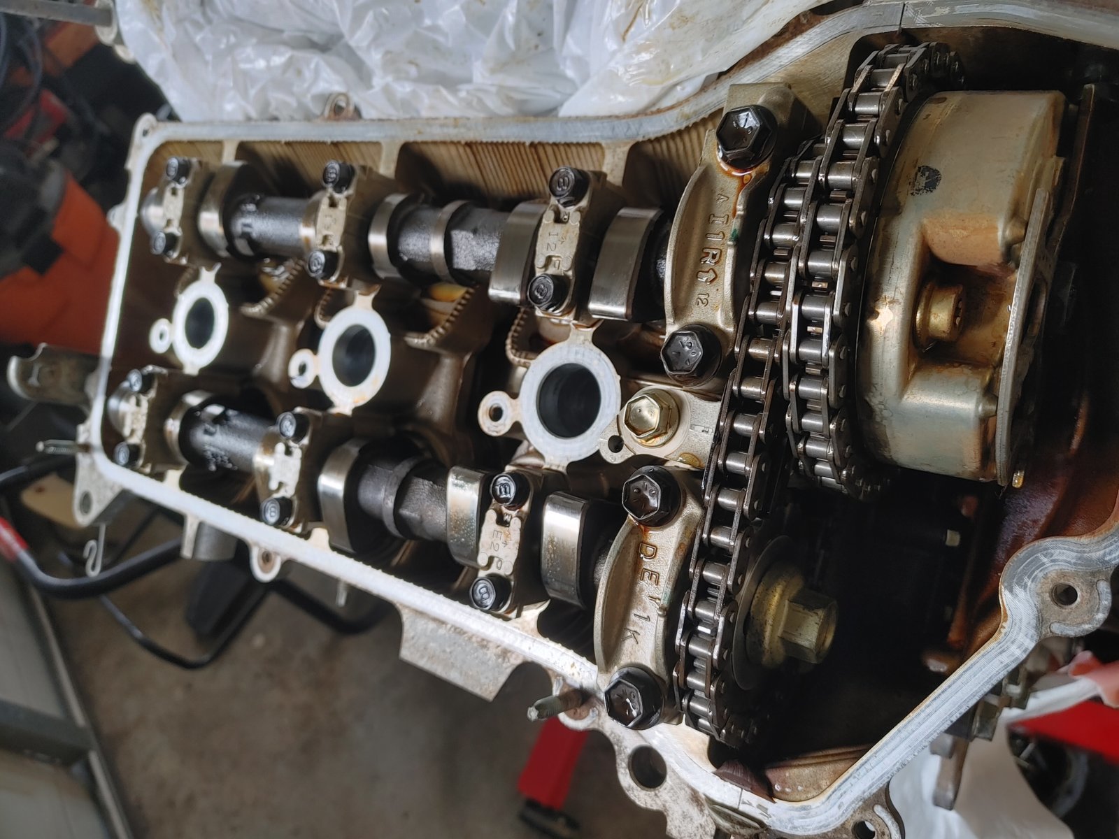

    New bearings in, thanks @XPOTRPR
    Cleaned and painted the pulleys, new set of urd cam gears ready to go in this engine. Was going to swap mine over but didnt want the hassle of having to take valve covers off old engine during the swap and waste any time.

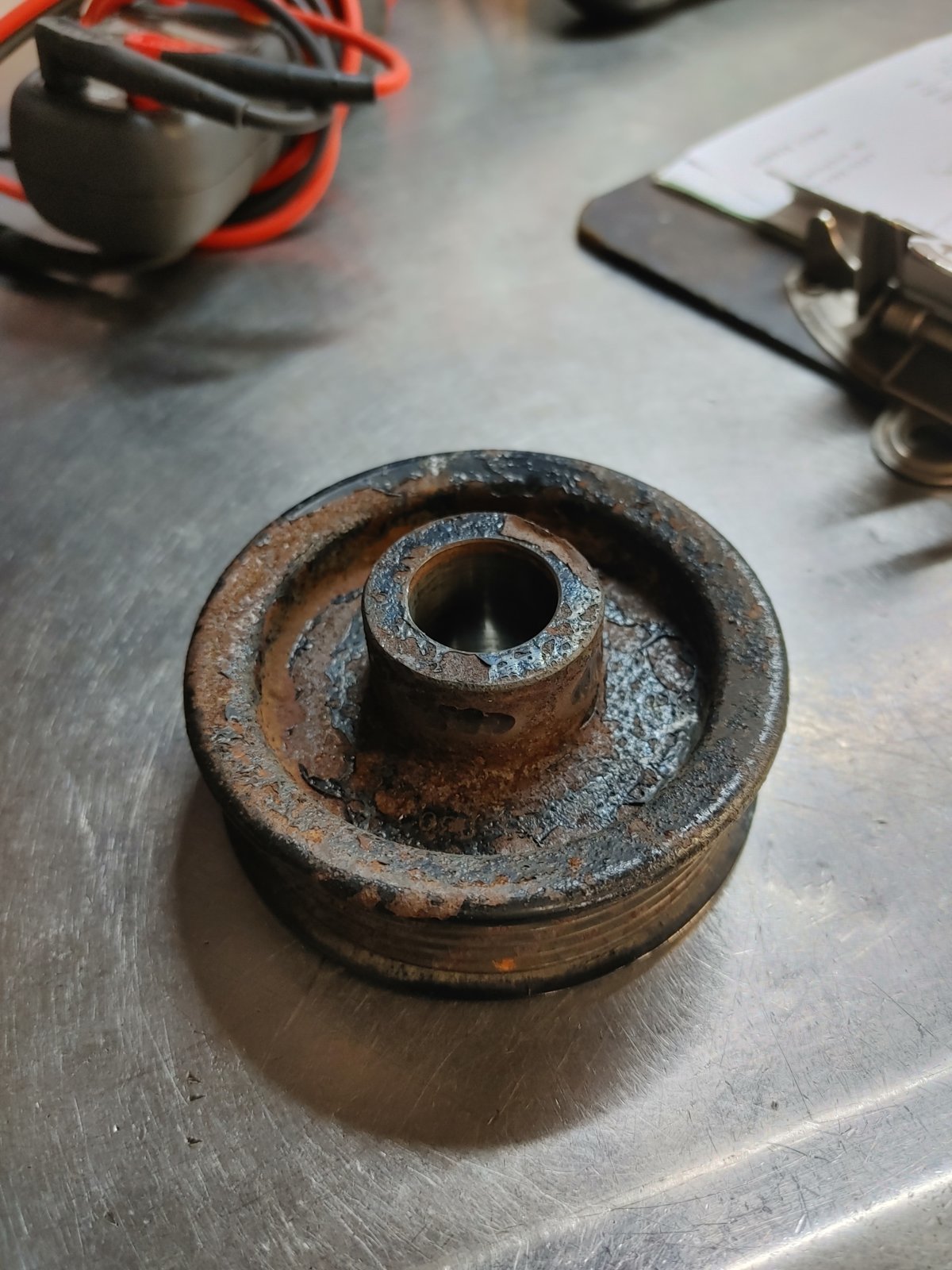

    16970551750257001932573427270313.jpgPulled the wagon wheel off in prep for the 2.8 pulley. Took a puller, with a propane torch, and a few bumps of the air hammer to move. No damage done. On to the next problem!

    glad it worked out! :cheers: I just remembered though I was going to try and find more specific info for you.. and never followed up. I apologize for that. Work and life has been keeping me insanely busy lately.
    Came off better than mine did back in the day.. we had to surgically take a cutoff wheel to it.

    Dude that was the worst wasn't it? I HATED the fact that I had to take a cutoff wheel to my brand new unit back in the day.

    I have noticable change in my current engine with the mightyman gears. Idles smoother, never any spark knock, just runs happier.
