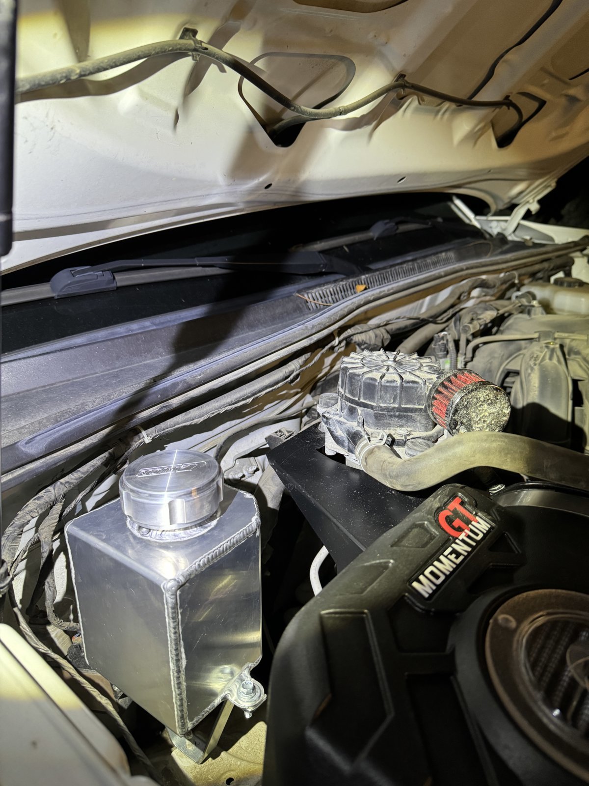

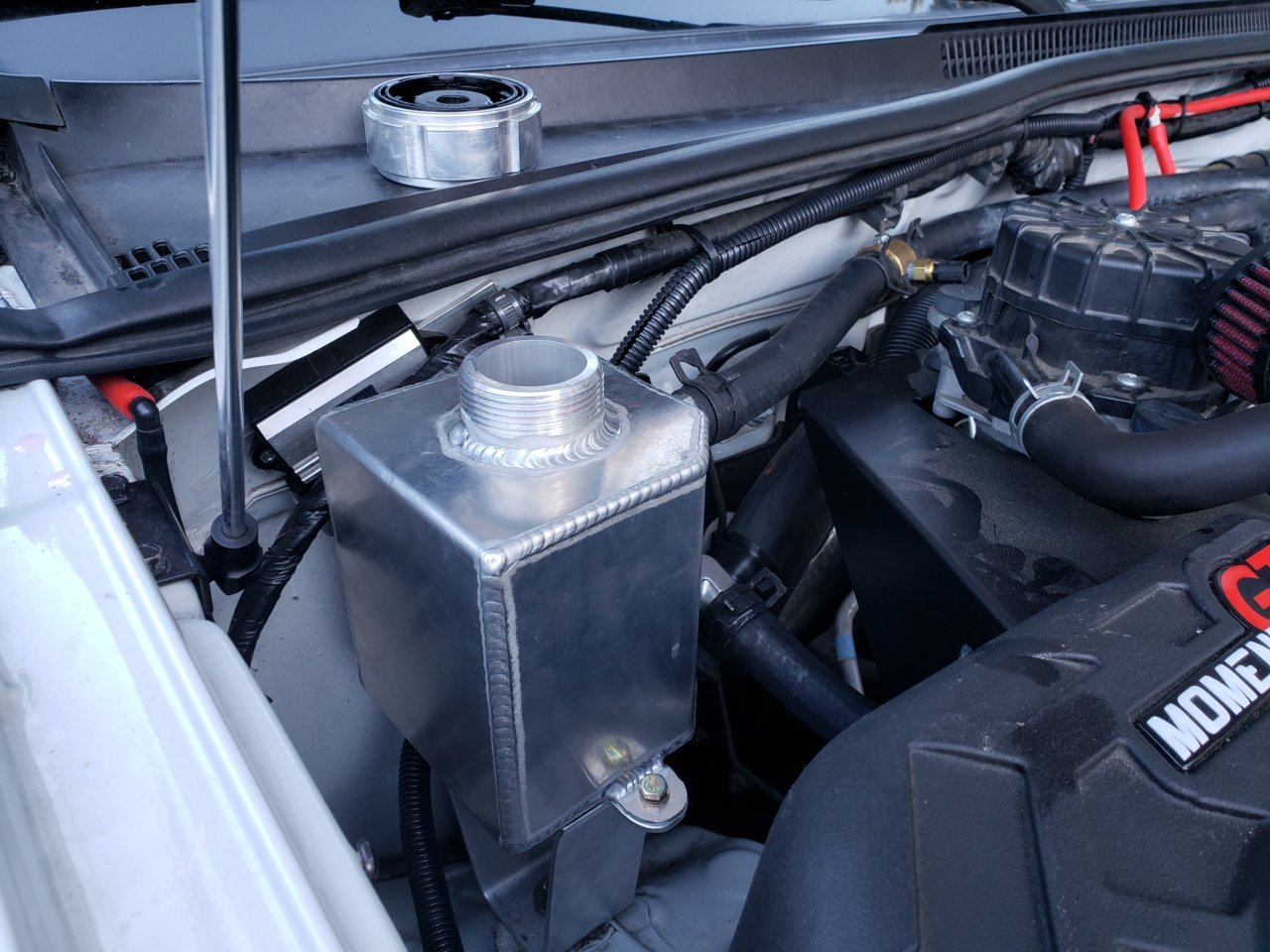

  11. Oct 23, 2023 at 10:20 PM
    gil_S
    gil_S Well-Known Member
    Jan 5, 2021
    #351828
    118
    Seattle, WA
    @White lightning boosted
    I'm doing something identical with how I mount my canton reservoir. Did you just mount it to that M8 bolt on the bottom, or also connect to the side wall or another point for stability?
    I also found I can rebolt in that secondary air pump controller to the stock location, but it's pressed against the reservoir. Anyone know if that controller is susceptible to overheating? Maybe I can hammer down that bracket a little.

  13. Oct 24, 2023 at 6:00 AM
    White lightning boosted Well-Known Member
    Dec 30, 2017
    #239848
    8,273
    Jesse
    Poulsbo
    15' DCSB OR S/C
    Lift, pedal commander, led foglights, led interior lights, led back ups, led under lighting, urd tcai, led headlights, methanol injection, 76mm tb, hood struts, dif breather mod, ratiotek trans kit, x-series gauges, true cool trans cooler, belt wrap mod, 2.8 pulley
    mine is mounted to a 2x3 rectangular bracket i made only at the bottom. its pretty sturdy.

  14. Oct 24, 2023 at 6:17 AM
    FishingInSand
    FishingInSand Well-Known Member
    Nov 28, 2016
    #203531
    1,094
    Corey
    Temecula
    06 now with 4x4
    Some stuff here and there
    What is that shiny square thing and why don't I have one in my engine bay?!

  16. Oct 24, 2023 at 3:06 PM
    Dec 30, 2017
    #239848
    8,273
    Jesse
    Poulsbo
    15' DCSB OR S/C
    its a quality unit. the cap is spendy as its billet.
    JuanitoBonito likes this.
