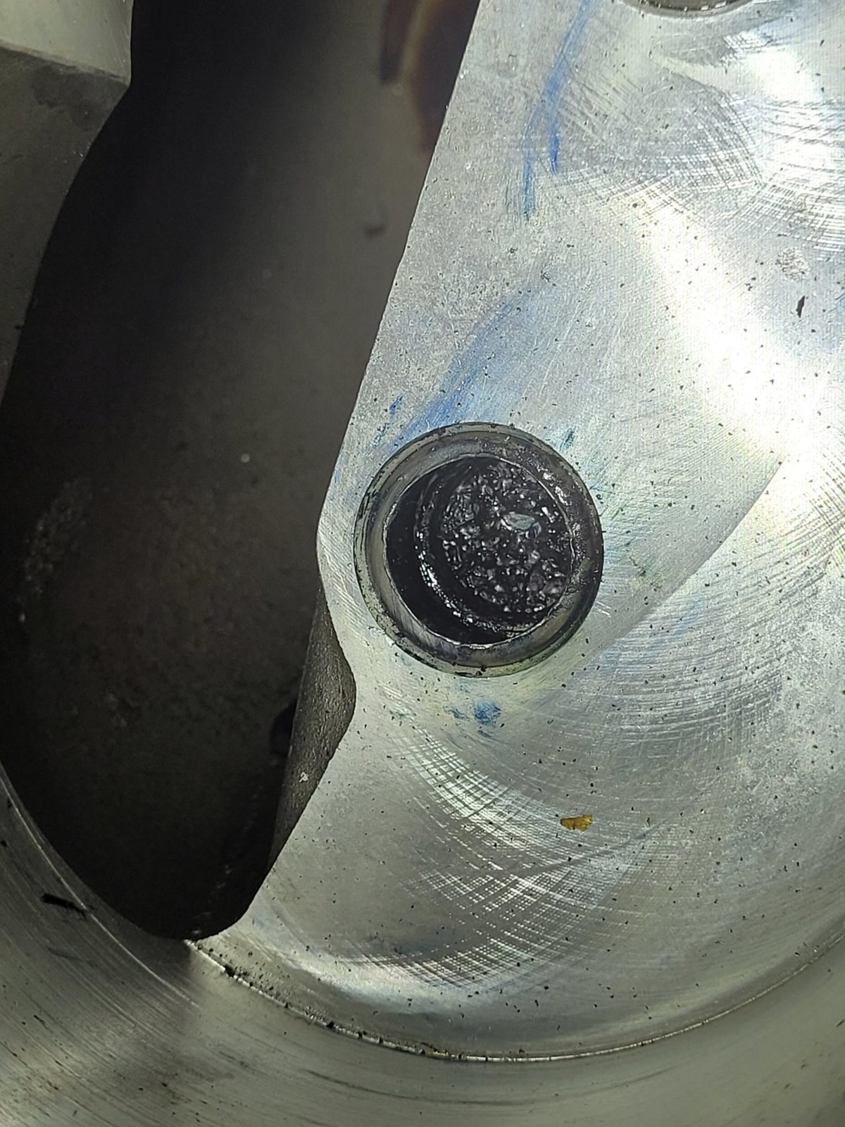

    I'm having a hell of a time getting these housing bearings out, even with a blind hole puller. How are you gents going about pulling these?

    Insert meme about shoving white bread in there and using a bolt/shaft the right size to press in and force it out backwards… ?

    ive considered this method but there is barely any room behind the bearing to shove any bread in and ive watched most people successfully utilize this method when there is an inner raced bearing. these needle bearings dont seem to have much outer race for this to work well but i suppose i can try..

    Clean the bearing out of needles and grease. Drill a small hole in the back of the bearing. Then try the blind again

    @will.i.was how feasible is it to heat the house and hit the bearing with a cold wet rag then repeat your use of puller?

    I've been heating it up with a map gas torch over a few cycles and in between slide hammering. First time I've heard of the cold rag though.

    The heat will cause everything to expand and the cold rag concentrated on the bearing itself will cause it to contract more rapidly than the rest of the surrounding assembly which should give you the opportunity to pull it with more ease than before.
