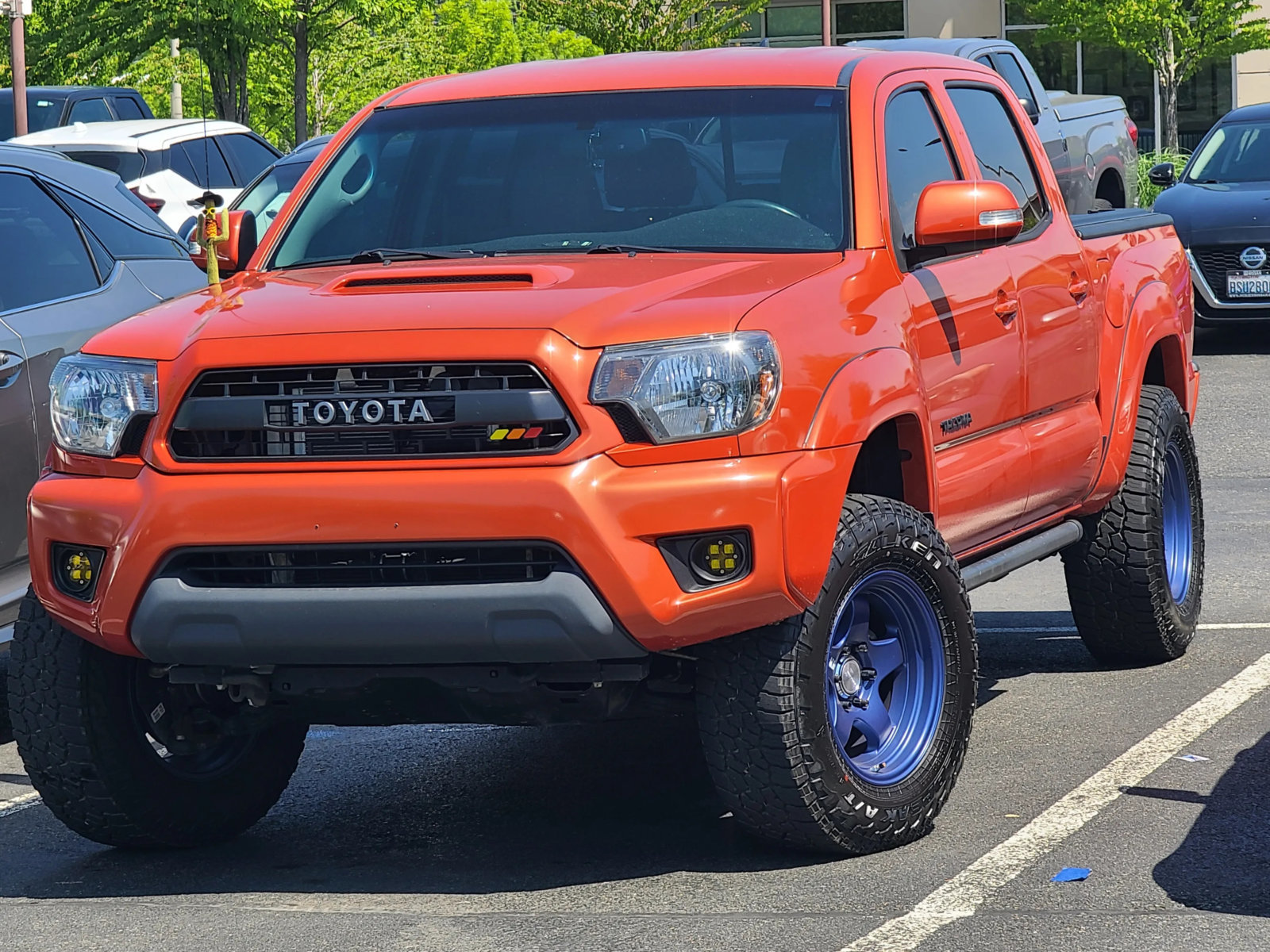

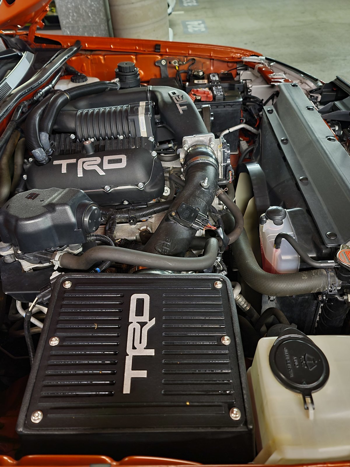

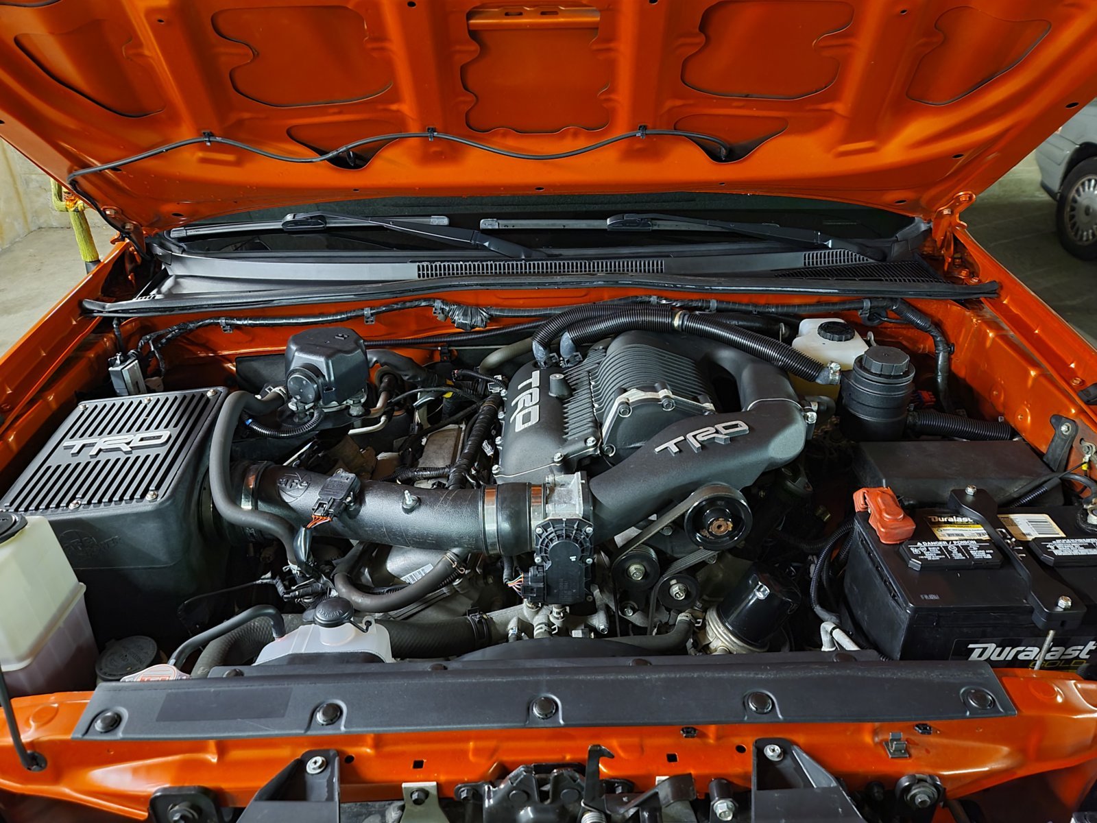

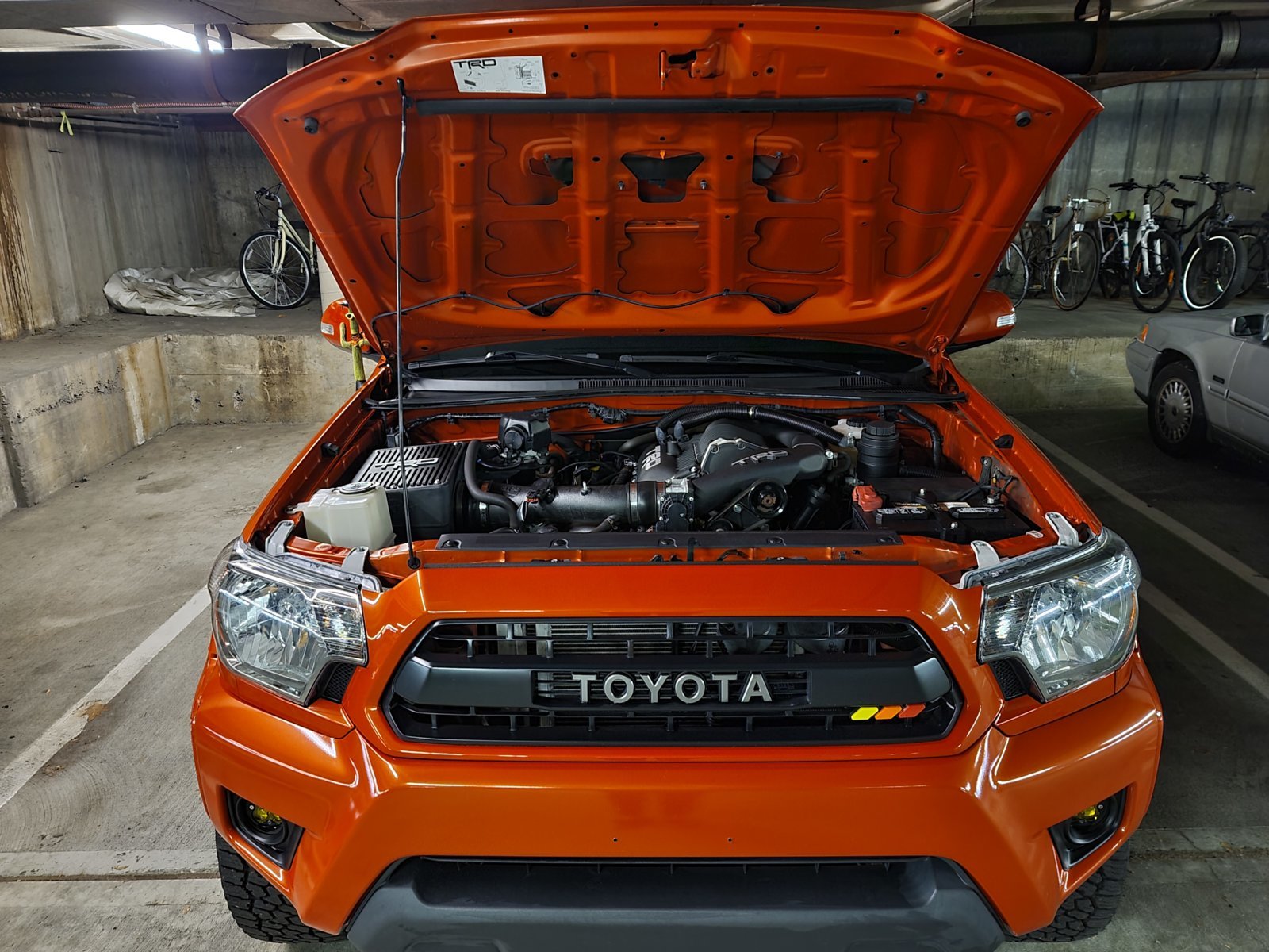

    How many miles have yall put on your supercharged tacos?? I'm curious :D:thumbsup:
    PFA!
    IMG_20230603_114009_600.jpg 20231108_051814.jpg 20231108_051929.jpg 20231108_052015.jpg

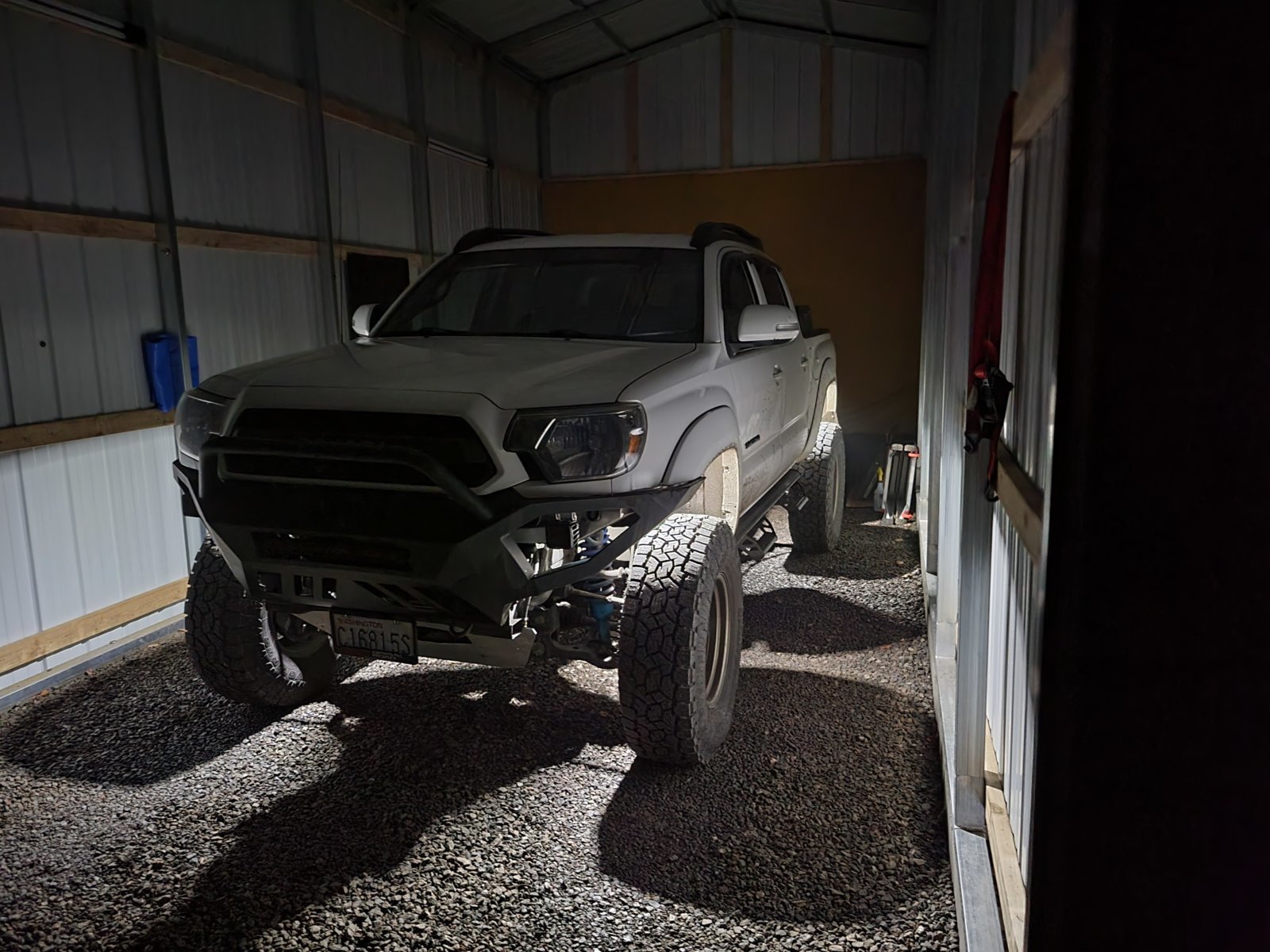

    howdy nearly local fella. im across the water from seattle. have 88k on mine. like the red! if you ever feel inclined to have bronze instead of blue wheels lemme know!20220118_175420.jpg

    Nice! You LT?? I absolutely love these second gens. Just got rid of a Silver 2013 for this one in February :D

    no...not lt, yet. big bracket lifter with med travel rear.mines a 15. you find a low mileage one? yours looks crazy clean.

    Dope! It definitely looks like it can do some crawling around yeah so I bought my TX Pro about 2 months before the 2015 inferno pro got anounced. Basically I was onsesswd with it ever since. Been lurking the for sale sectionkey here for a while and the one I found had the supercharger on it already! I was sold lol PLUS this one was barely installed in 2019 from factory with the factory tune. I bought it on faith front across the country and I was in Mexico at the time too kinda cool story. Truck only had 74K miles and SC was on at 56K
