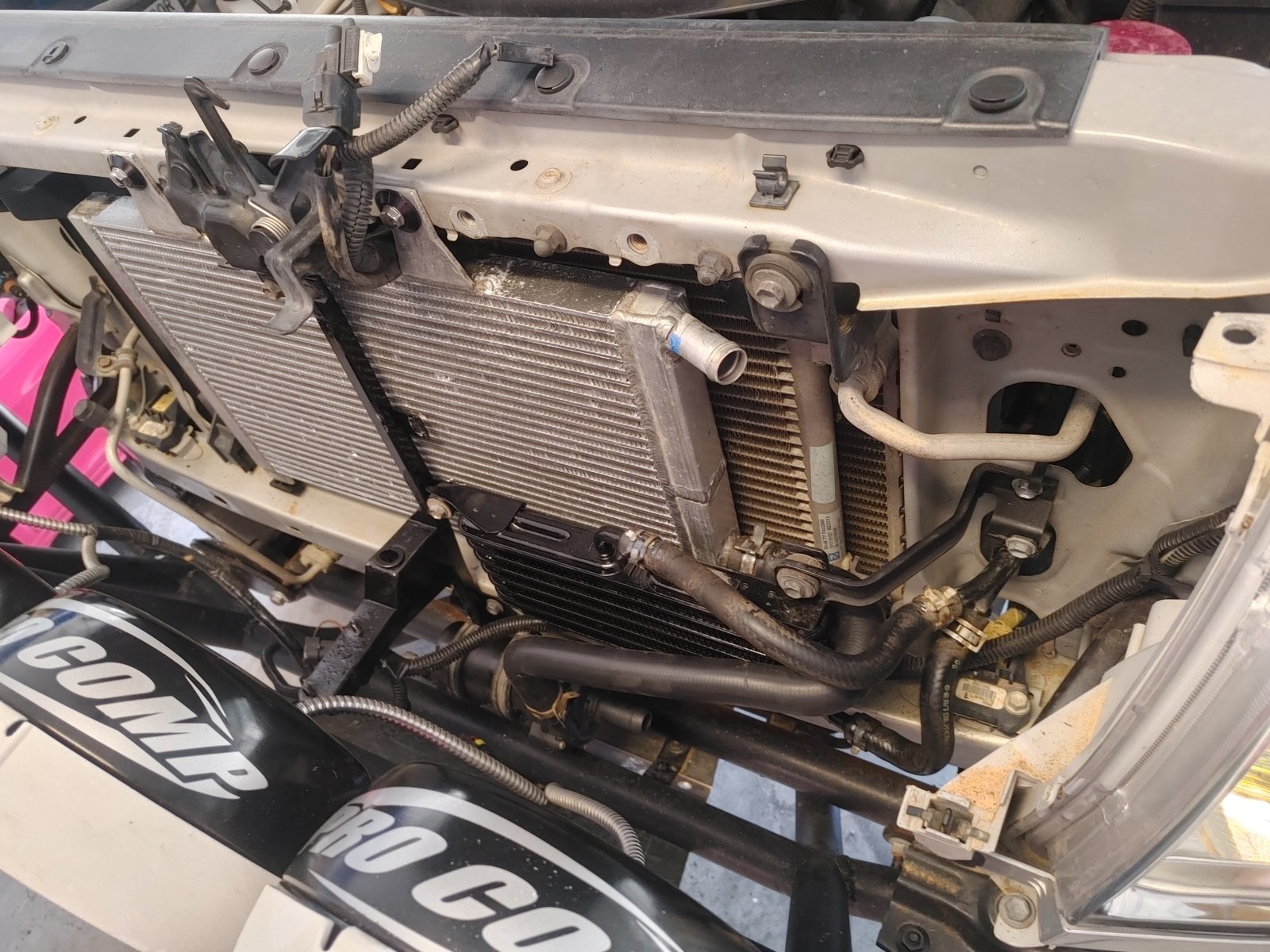

    AFE stage II intake, APR X1, URD 70mm Throttle Valve (ported and knife edged), NST intake manifold spacer, URD spec U headers, Denso IKH20, URD fuel pump, APR fuel rail, URD Y pipe, URD spec u catback, lightweight water pump pulley, Greddy sandwich cooler plate, Earls oil cooler, IPT valve body, FJ TRD shocks, Cusco front and rear sway bars, Energy Suspension rear track rod bushings and rear link bushings, Carbotech pads, Stoptech ss brake lines, Stoptech slotted rotors, Motul 600 rbf, Limited Grill, Painted hatch cover by me, Painted valve covers by me, Cobra CB, TRD rad and oil cap, Escort 8500, Autometer oil psi and temp gauges, AEM wideband afr gauge, Flexpod, Pioneer 400w speakers.
    Drive down the same ditch and It'll bolt right on.

    2005 Supercharged Converted Prerunner
    Total Chaos 3.5 LT, King Coilovers, 35x11.5r17 on Falcon T2, ADV 4 inch fiberglass, 4.88 gears, FJ cruiser transfer case, 4 runner front diff, Cab mount relocate, archive hangers, shackles, king 2.5x14 rear shocks, icon rxt leaf springs, king hydro bumps
    Saved myself a few hours come install day

    Self clearancing eh? I dig it. :rofl::rasta:
