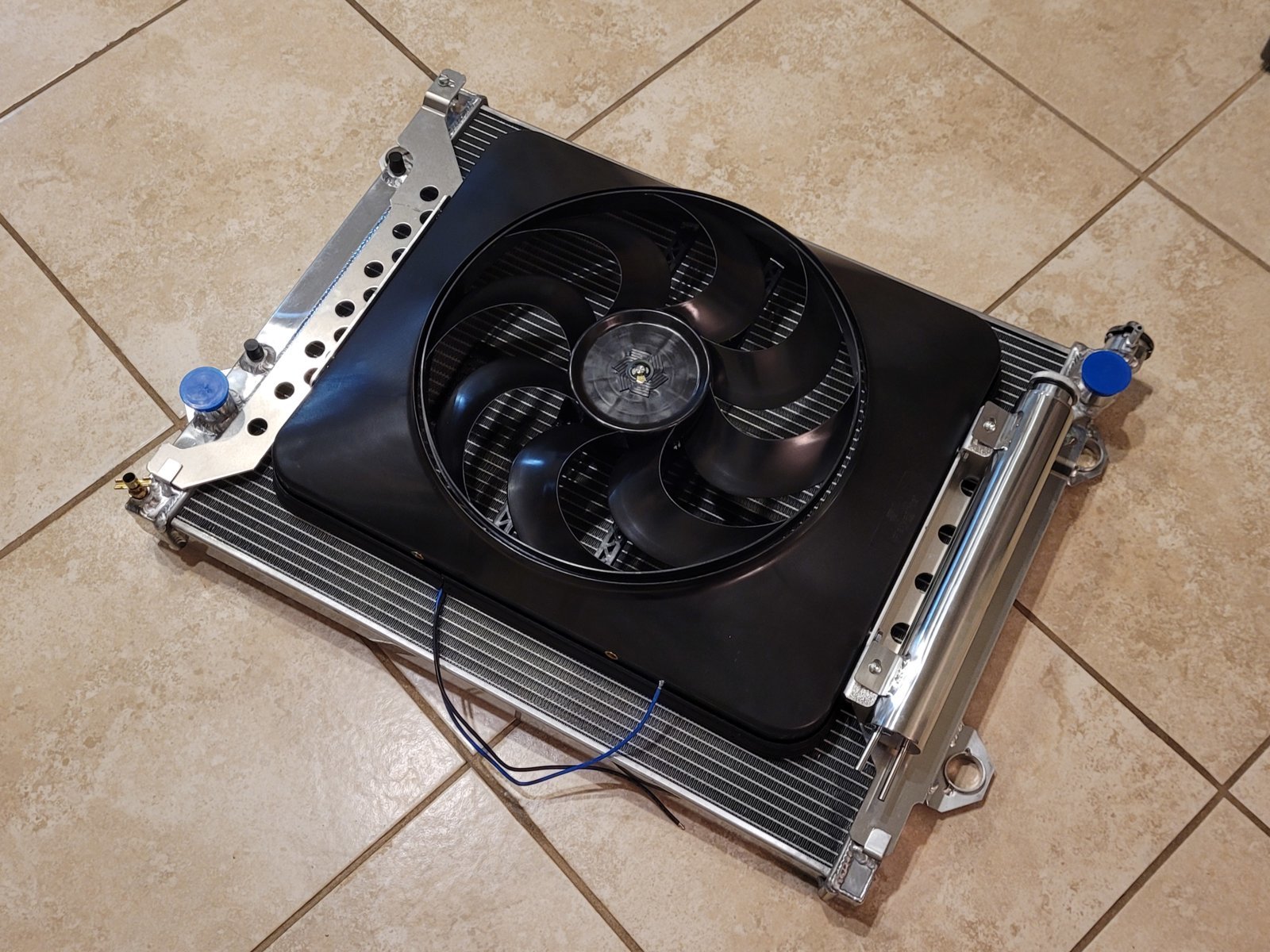

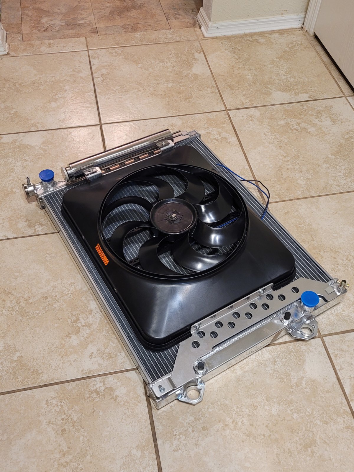

  16. Nov 28, 2023 at 5:36 PM
    will.i.was
    will.i.was Well-Known Member
    May 6, 2018
    #252688
    1,721
    Will
    Houston, Texas
    SC 2.5
    Can't wait to get this puppy installed..

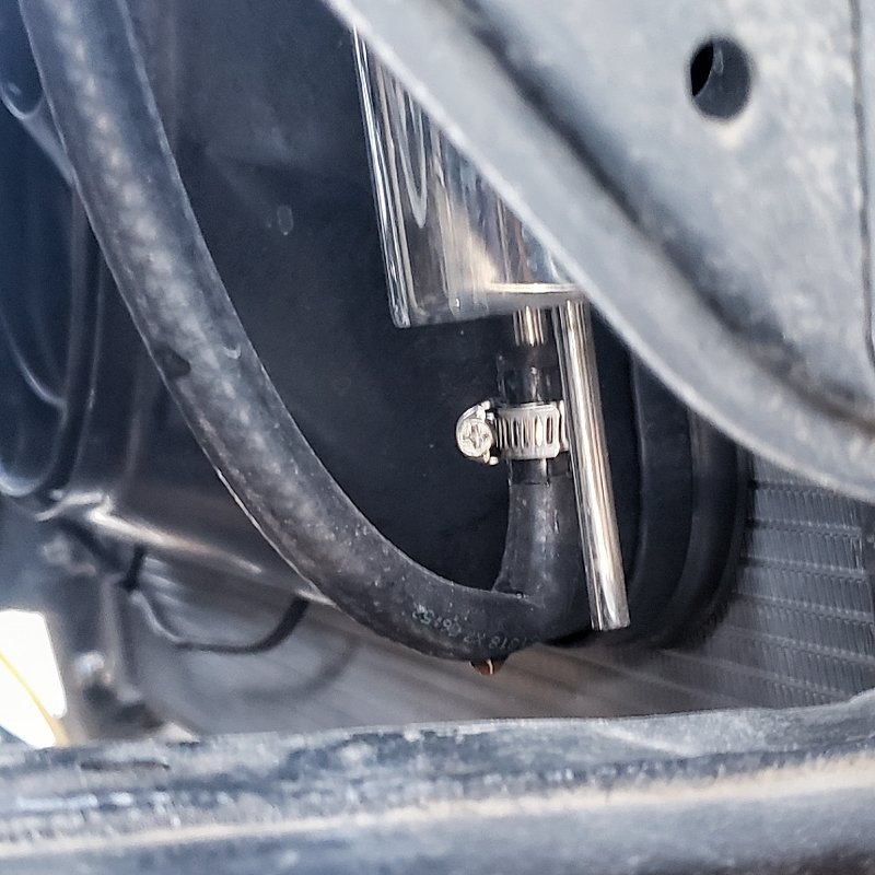

  17. Nov 29, 2023 at 6:03 AM
    jamesepoop
    jamesepoop Well-Known Member
    Feb 22, 2017
    #211394
    1,117
    California
    2007 Fj Cruiser
    I have the same flex a lite fan and aluminum radiator. Really happy with my set up and hasn't shown any signs of giving into heat soak. I would suggest to update the thermostatic switch to a PWM module that can adjust your fan so it doesn't have to pull all or nothing. I'm using a derale PWM fan controller.

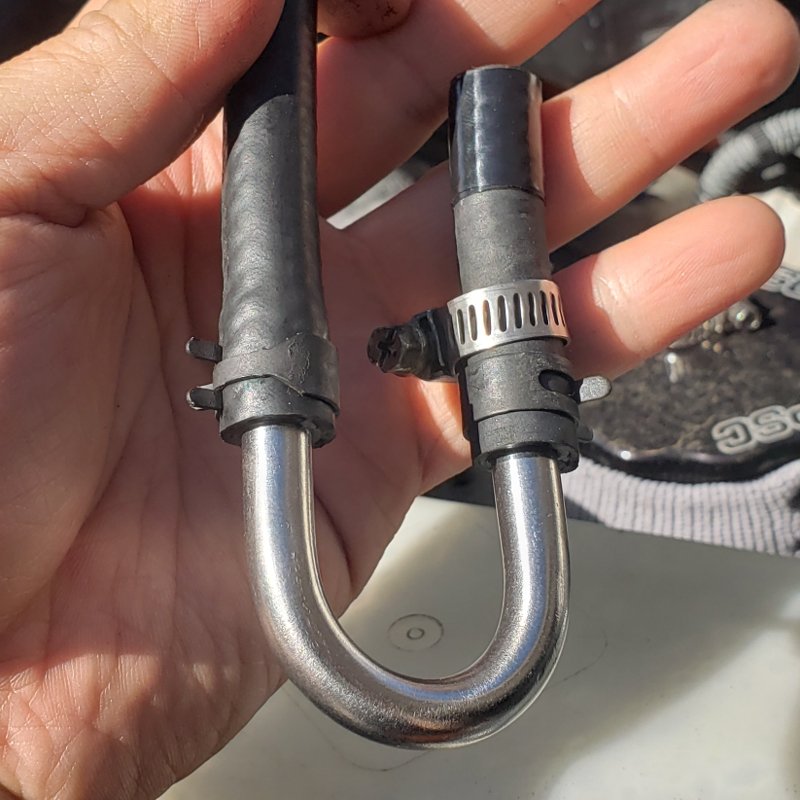

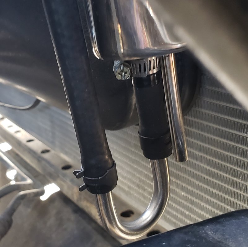

    Also that coolant reservoir has a strange design for the bottom connections. Even extending the lines it will still attach awkwardly. I ended up using a beverage machine 180° stainless U to connect the hose.
