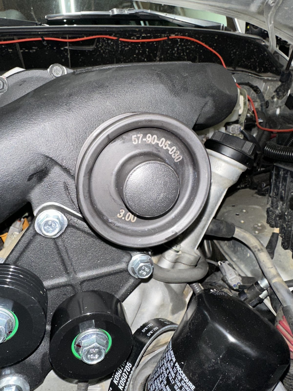

    Ridiculous question, but I’m going to ask it anyway: what plastic plug is used to hide the supercharger nose hole? I just spent the last 45 minutes searching here and on Google and came up empty :notsure:

    Yup. It doesn't do anything but maybe keep a bit of dirt out of screw threads.

    Could try supercharger s online if you really want it, but probably some harbor freight cover will be the same. It's just plastic.

    Thanks, I know it’s a common part, I was just hoping someone might know the size offhand

    How about a stainless set screw?

    As Tor said, a bolt will work or if you truly want another plastic cap/plug I was able to use one from a toyota fastener kit on Amazon. It had some plastic lines/ridges on the inner portion that i shaved down with a razor blade and now it fits flush and looks damn near identical.

    That looks good, I think other guys have used slightly smaller ones too. Maybe I’ll take a ride over to harbor freight and see what they have.
