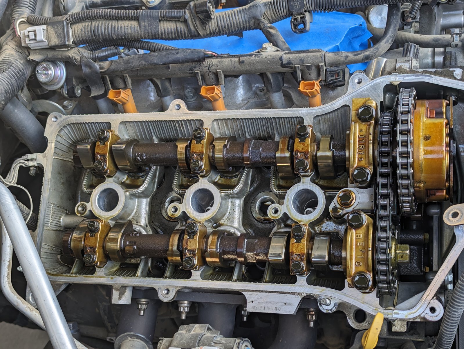

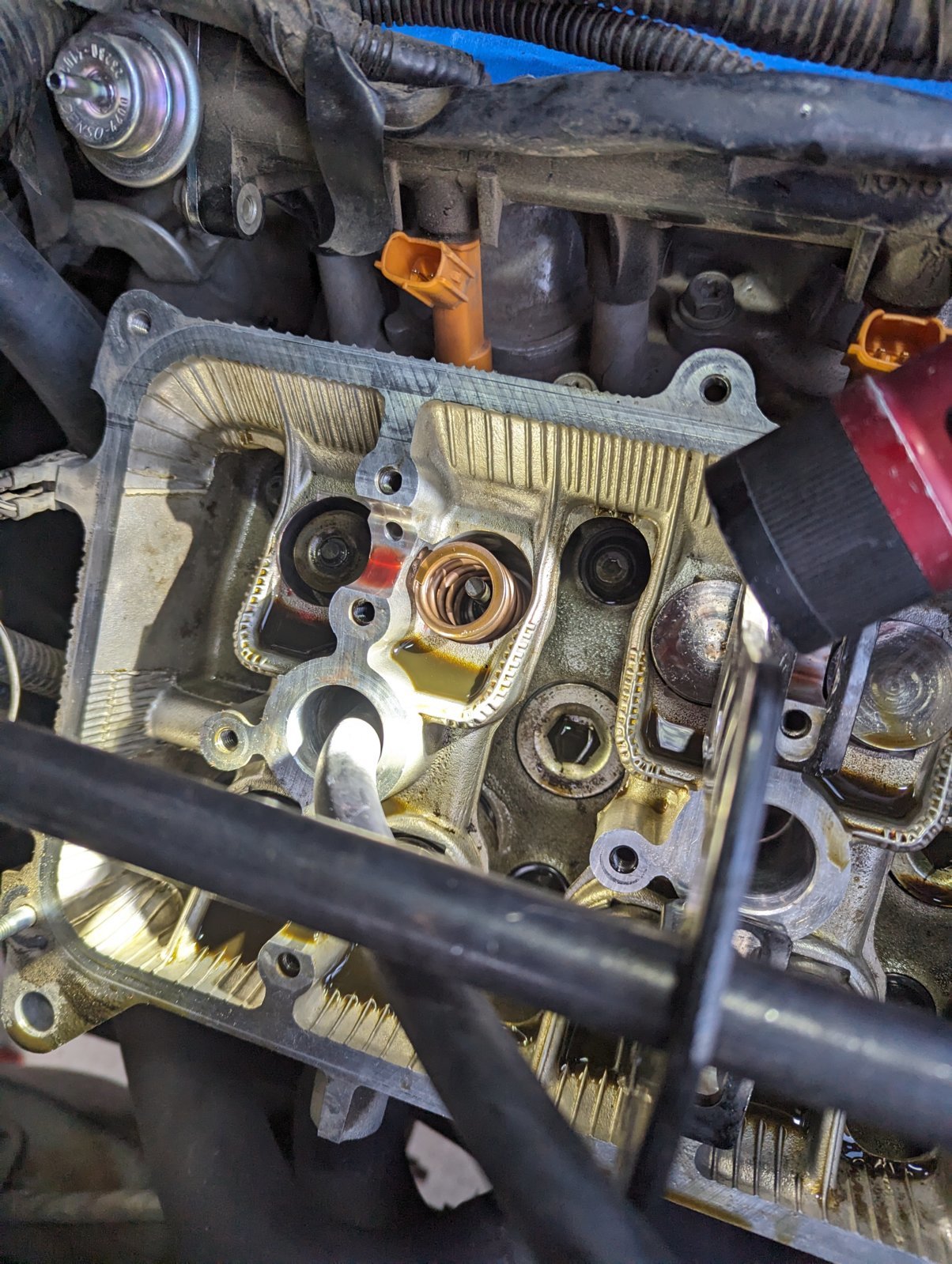

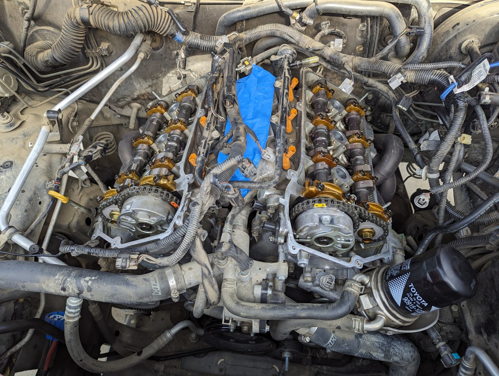

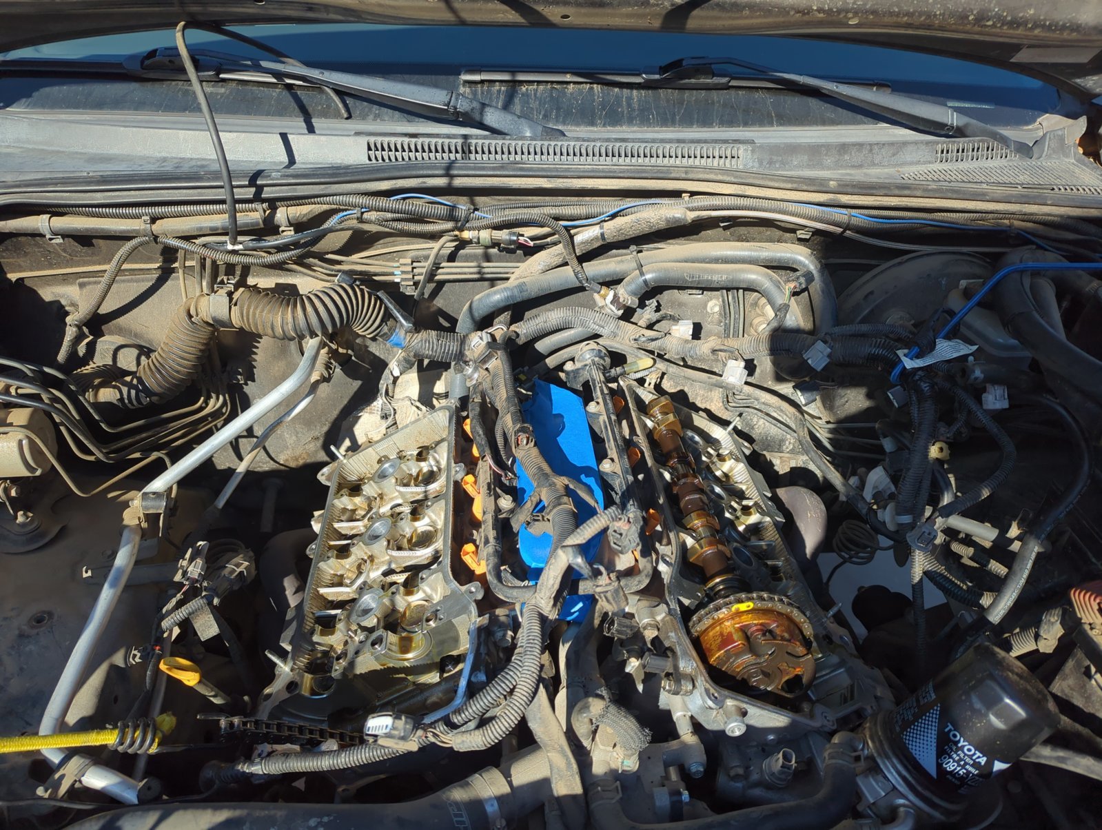

    Cams out. Time to measure the current lifters. 17021568989853257735238839665785.jpg

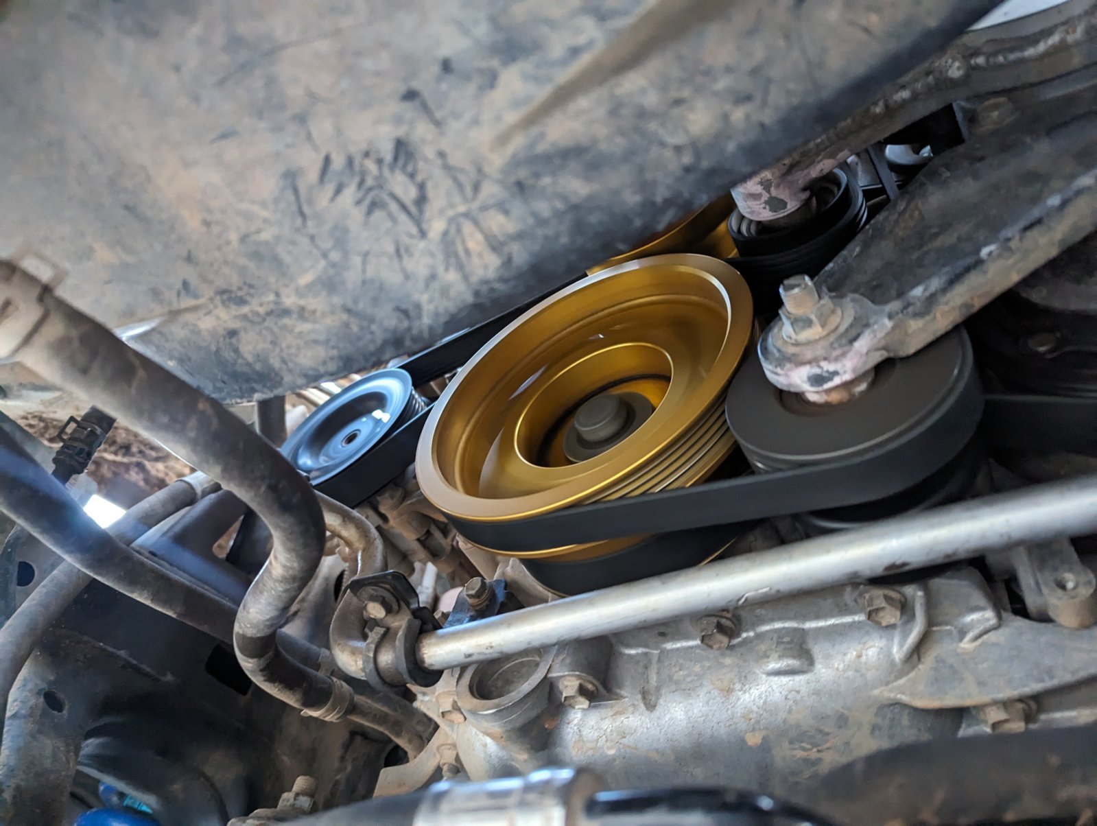

    Thanks. This is what I was wondering.. how custom its going to need to be to fit in the NST crank pulley. I almost just turned on the compressor and machine at the shop to start making one. Figured I'd ask first before going down that rabbit hole. But.. might just make one anyway. A ring that fits around the bolt with clearance for a socket to pass through to the bolt, and keys into the bores on the pulley, then a mill out a half inch ratchet keyway on it to hold. Might be tight.. but figure something out.
    Edit.. they had that tool for next day delivery. I just ordered it and I'll modify it tomorrow at the shop. Thanks guys.

    Those internals looks like peepee. Do you not change your oil at regular intervals? Shame on you. And you call yourself a professional mechanic.

    That was before me. If you looked at my tread for the engine rebuild and seen what it was. I could not find new vvt gears at that time. But everything that I cleaned still looks good.
    I'll try and post a pic tomorrow. I forgot to get one of the new cams in before calling it quits for the day.
    Still need to measure valve clearances and figure what new lifters I will need to buy. I still have the springs to install.

    Makes sense bro. Don't feel bad, I change my oil every 5-6K max and my internals look sort of like that too. I'm like... Dafuq man.

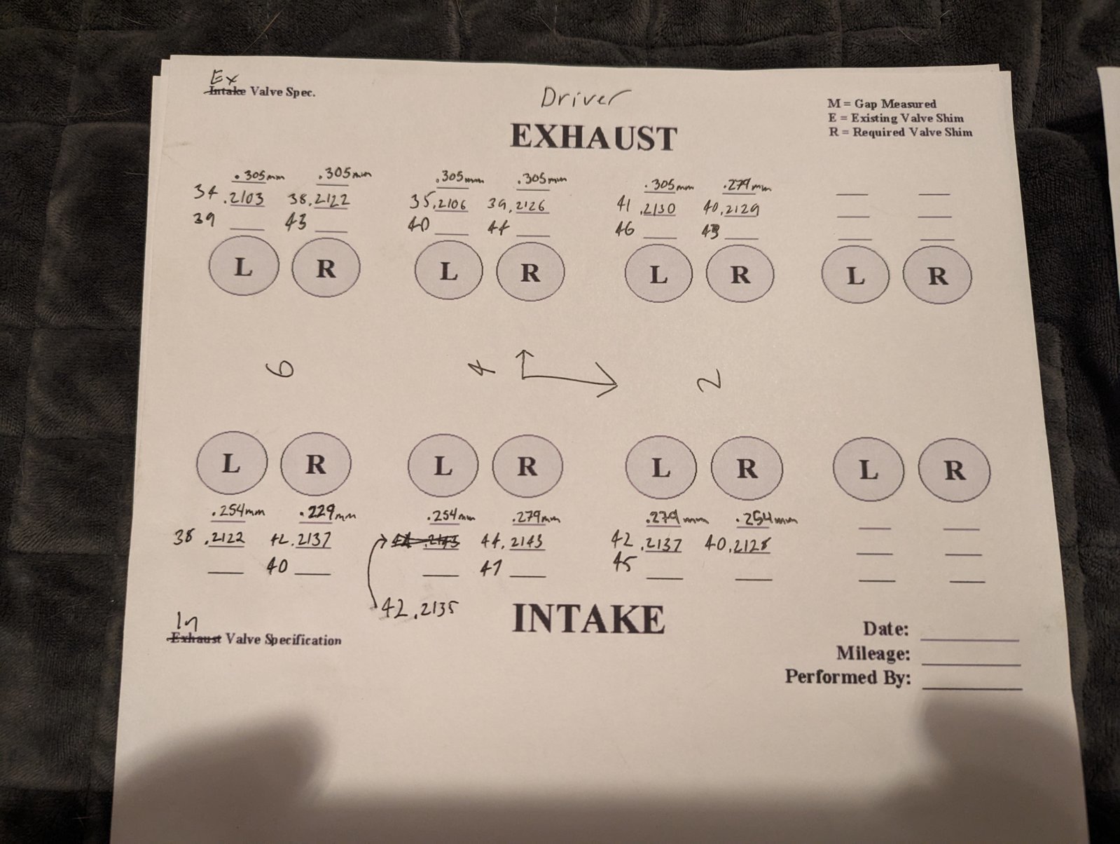

    Been busy recovering from our holiday friends party last night and installing valve springs.
    Valve clearances have been measured and new buckets have been figure out. Luckily I only have to order 9. Hopefully next week I will have the truck running.
    I contemplating putting a new coupler in the supercharger since it's off. I have about 30k-33k.

    Nice work. How far off the were 9 that you had to order?

    I had a few I do not need to adjust and I am able to swap lifters around to different locations to minimize the number I need. Most were about .05mm for less. I had one that was a little farther off.

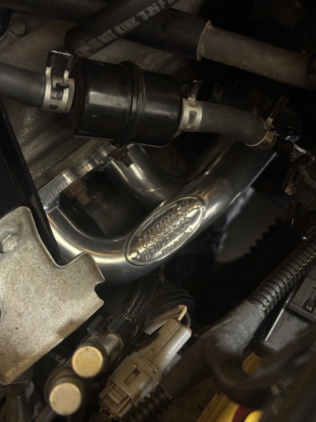

    Do you have the older non SAIS engine for those headers? Looks like it since I did not see the SAIS. Lucky. I have had a set of DTs for the SAIS version for awhile since it was "pending" certification. at this point its never going to happen.

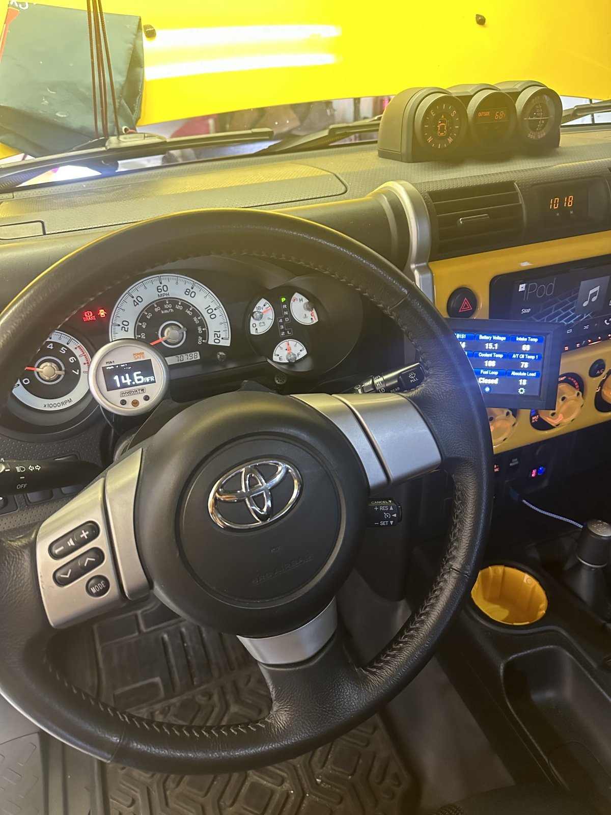

    Little trim and out to the parking lot to test and hopefully get this buzzed on and get the truck back to the house where I can really investigate. Or maybe I'll get lucky and just need to tighten it up and be able to go about my way.

    Think we're good to go.
