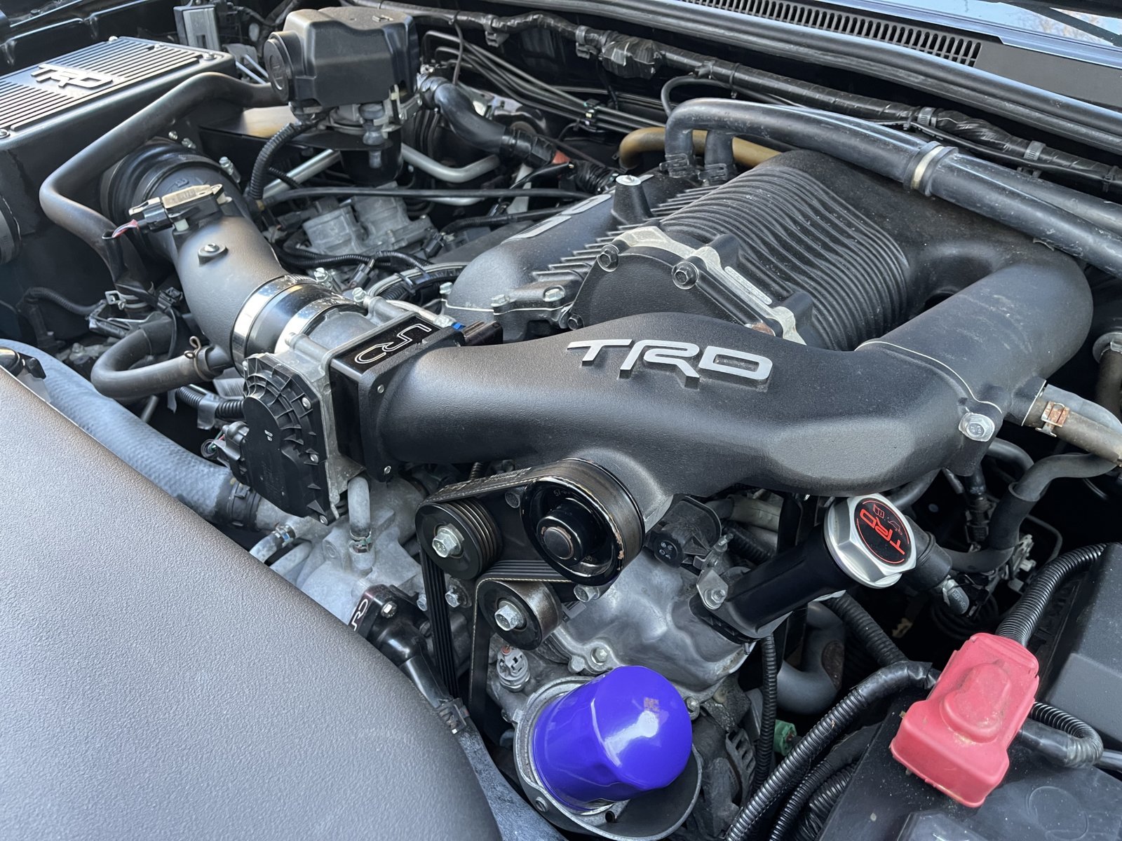

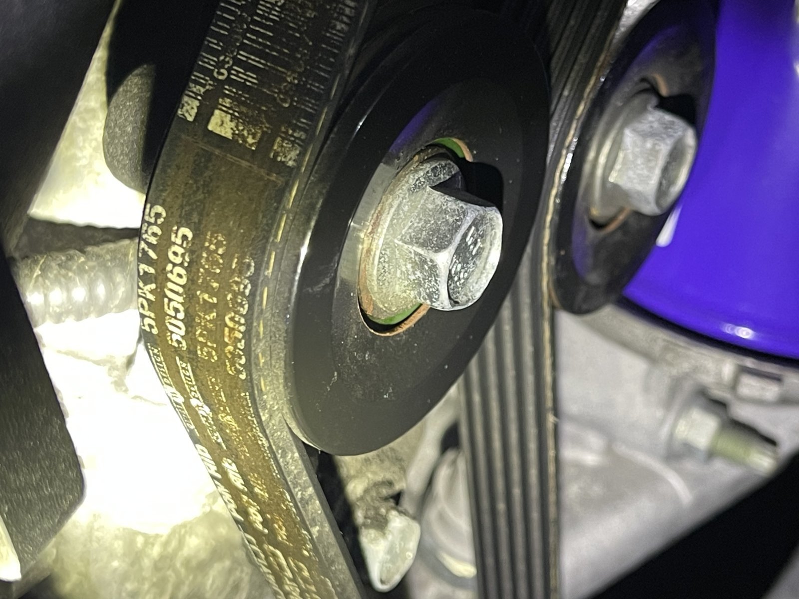

    On a side note, I took the Tacoma out for a ride today, put on about 250 miles driving back and forth to Connecticut. The truck went pretty good, didn’t miss a beat, but still had some belt slip when I really got on it (2.55 pulley), so I had to back off each time. I’m working on a solution to that, so not a biggie, still gathering the parts needed.
    What did catch my attention though was my AEM AFR gauge acting up. If I was in 4th or 5th, and I got on it quickly with about 3/4 throttle, a quick 6-8 psi boost, the gauge would suddenly go to four straight lines, like it does in DFCO. I’m guessing the wideband sensor is on its way out. I’ll have to research it to see if it’s a common problem.
    Here’s a quick pick I took when I got home, I can’t wait to finish the wrap mod and get the stronger tensioner on:

    I forget if you mentioned belt length. Are you on stock length or a shorter belt?

    Thanks for asking, I think I definitely have a shorter belt, just took a couple pics, I’ll have to go back and look at my records, pretty sure I’ve got the correct length:
