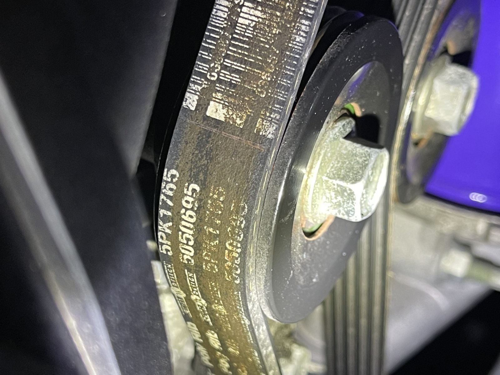

    I just checked, had the right belt on: 5PK1765
    From page one: “69.5 for smaller pullies (2.5") 5PK1765 5050695
    Available in Dayco brand, Bando, Goodyear Gatorback, or Continental”

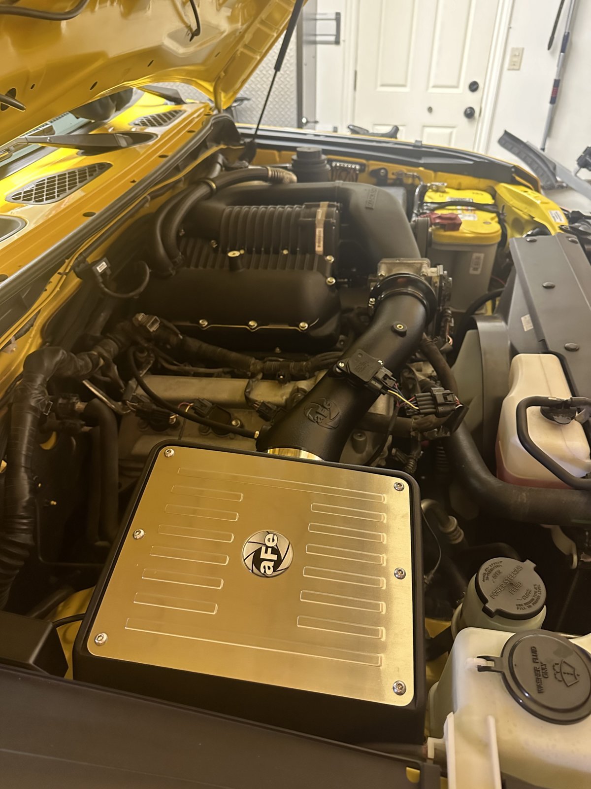

    Anyone know why the AFE instructions would mention a CARB EO number? I want one badly!
    The molding they give you to go around the fender opening is pathetic by the way!

    @9kfever My guess is the text in the instructions is generic and it's a typo for out trucks :( Or maybe they were trying to get approved and somehow got denied.

    I believe it was because aFe was the manufacturer of the TRD Gen1 intake.....which is the same as the aFE cold air intake that you have.
    The TRD Gen1 intake has a CARB EO #....which would technically apply to yours.
    Just swap on the TRD lid and use the TRD carb eo #.

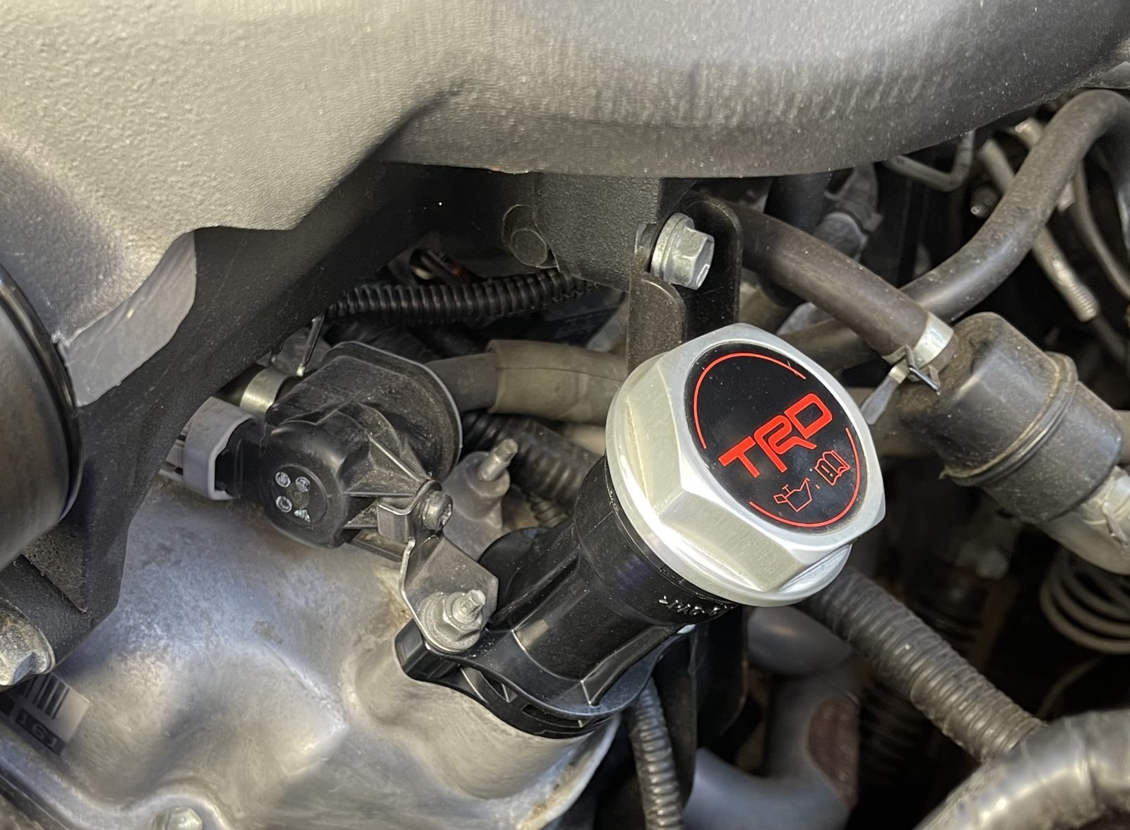

    Got my tundra oil fill neck on today, it looks a lot better:
    While I was in there, I noticed how ugly that damn SAI is. I guess I’ll add removing that to my list, all I’ll have to do is buy more hptuner credits and get to work.
    While searching around the forum, I noticed HT Hewitt was making a bypass kit, has anyone used that, or just write it off the ecu with hptuners?
    Norton likes this.
