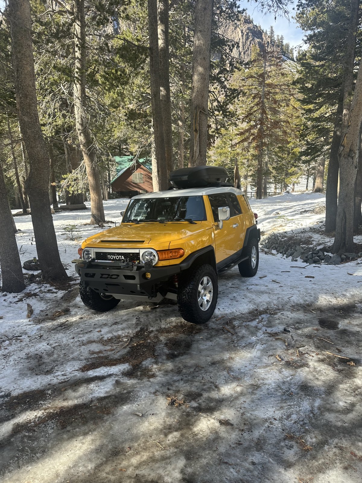

    Drove my rig up to Mammoth Lakes, CA. Performed really well on the five hour trip up. Just driving back from sledding and noticed it’s not making boost in the low end. Floored it and my gauge read a max boost of 3psi, when it normally makes 8psi with the 2.85” near sea level.
    Does that seem normal for almost 8k elevation?

    Some of that is normal. How much is another question. You can take a quick look and make sure your vacuum line on the supercharger and boost sensor are on correct. I think norton in denver area make 5-6 with a 2.5" pulley just for reference.

    I guess I’m not too far off with 2500+more altitude and a bigger pulley. The vacuum hoses are all secure

    2.5" RIP-modded pulley on a Qwikchange Hub, supported by @Roostfactor's Pulley Wrap Mod, produces ~6-7 psi boost at WOT here (~6K-7K ft elevation).
    That's probably not far off. Cocktail napkin math says my boosted vechicles lose ~0.5psi of boost for every 1K ft of elevation gained.

    i would say you had a problem until mentioning elevation. its normal to me. live at altitude, get small pulley.
