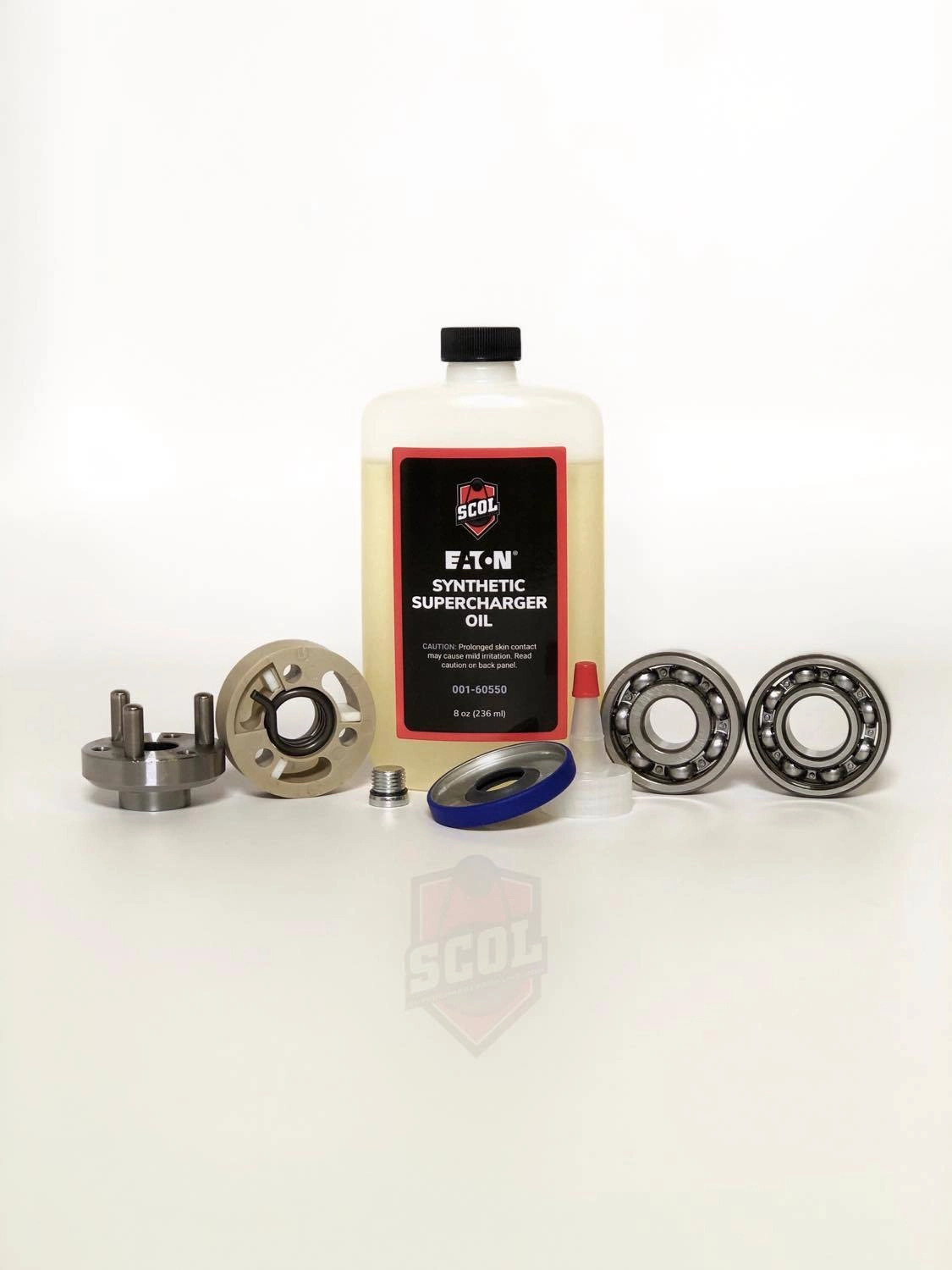

    No, just the coupler, oil and sealant. I thought there was a pre made kit someone sold.

    Thank you guys. I'll just order all the parts individually.

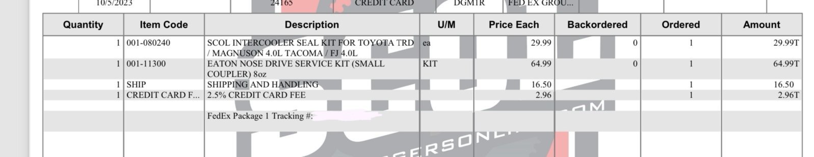

    If you call SCOL they will get you setup with the solid coupler. This is what my invoice looks like and I also ordered an intercooler seal kit with it.

    Seems like there's a rebuild kit and a repair kit. I'd probably also call SCOL as I wasn't aware you needed to replace all of it. I could see doing all the maintenance but I only have a service kit similar to what @Murphinator posted waiting.

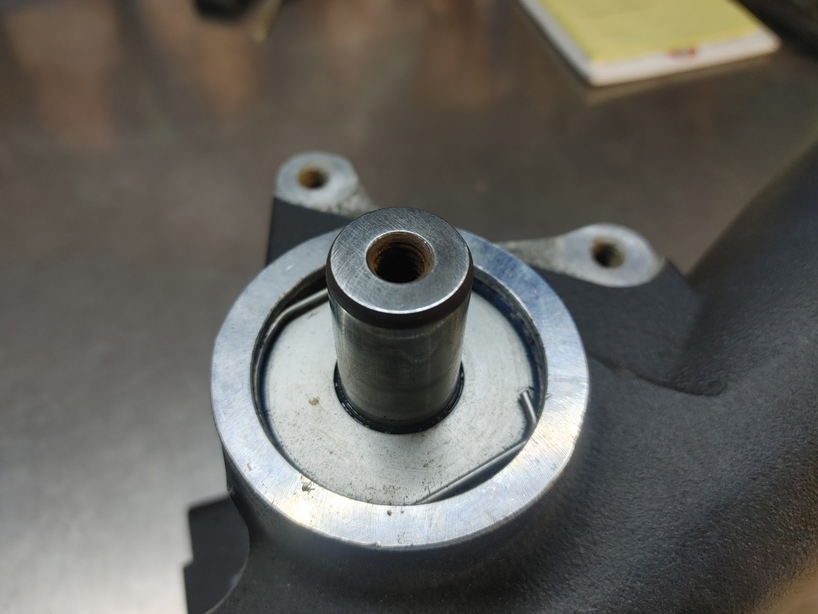

    Anyone know the thread size/pitch of snout off hand?

    8x1.25? Is this for the hole in the snout?

    Yes, my 8x1.25 chaser goes in half a thread then stops. Its cruddy in there, just making sure before I send this thread chaser

    Yeah it's 8x125. The first thread was boogered up so I had to use a tap once I got the first thread cut the Chaser goes in there thanks

    Thanks, gave them a call with this info. $120 for me after tax and shipping.
