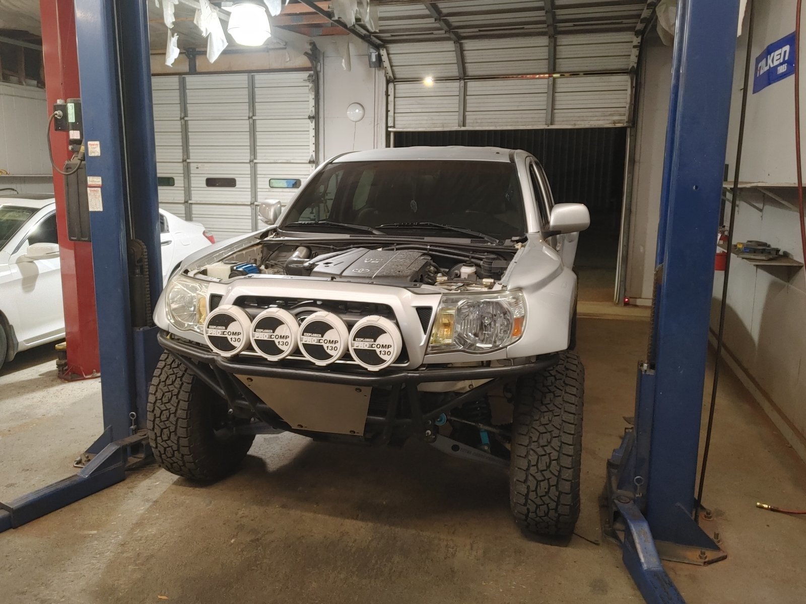

    Got my big fuel pump installed as well as TRD ecu. Thanks @JustDSM. Truck not happy on stock airflow right now as to be expected. And no I'm not driving around. Just pulling from bay to bay to work on it.

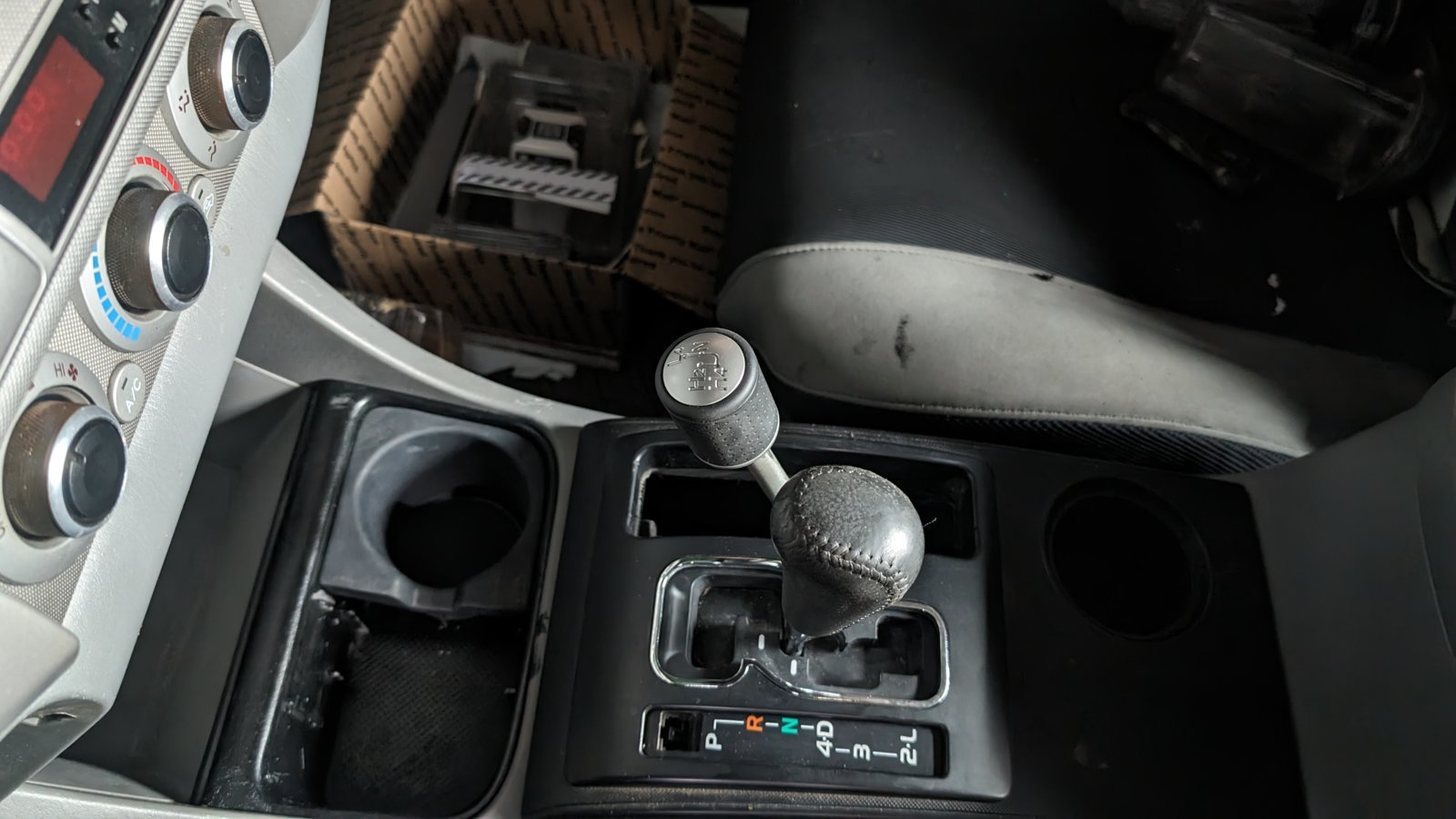

    Mine was a full 2wd to 4wd conversion so it made things easier going with the FJ tcase. Right now I'm trying to figure out how to fill the transmission fluid lol
    I did the get the front torqued and dropped back on the ground now though! PXL_20240123_215856327.MP.jpg
