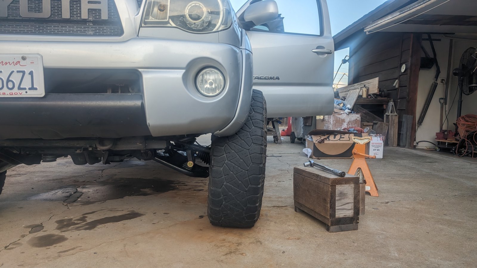

    Oh god is this safe to drive to the alignment shop lolPXL_20240126_003720260.MP.jpg

    Take a tape measure from edge to edge on the tire at the front and at the rear. set the front about 1/4 inch smaller in the front. that will get the toe close and can drive it to the shop with minimal if any issues. Yes the alignment will still be off, but the big thing that will fight you when driving to the alignment shop will be toe. camber not a big issue, maybe some tracking of the groves in the road. caster will make the steering feel hard or not want to return to center.
    The toe being far off will feel like you're plowing the asphalt off the ground.
    edit:think clock when looking at the side of the tire. you want to measure at the 9 and 3 o'clock positions
    FishingInSand likes this.

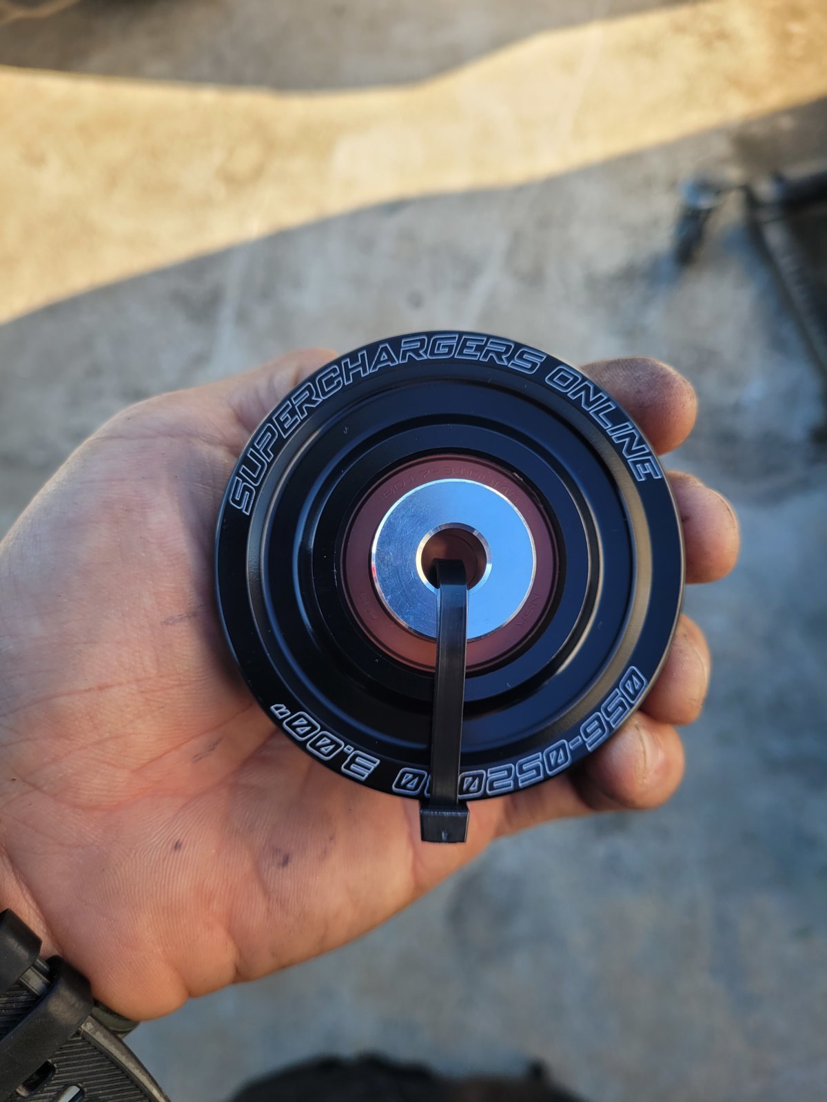

    This finally showed up today

    Supposedly this is the "upgraded" 5 rib lower idler pulley. I needed a replacement since mine was out of round somehow..
