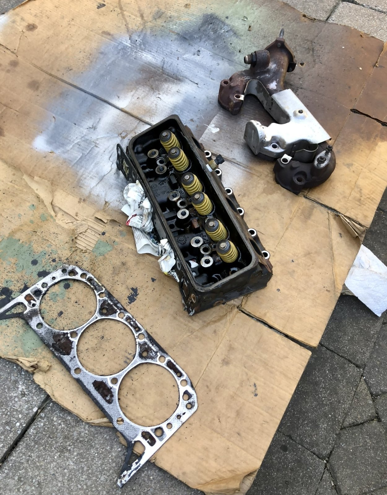

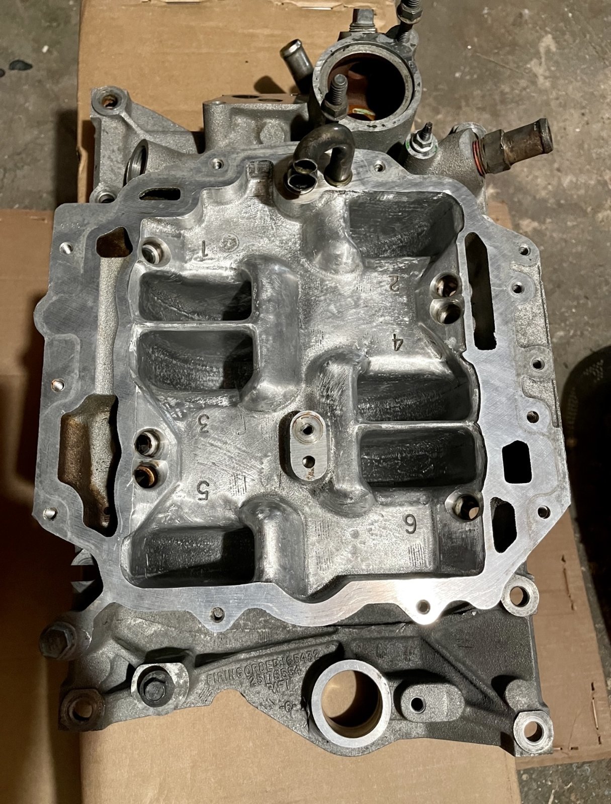

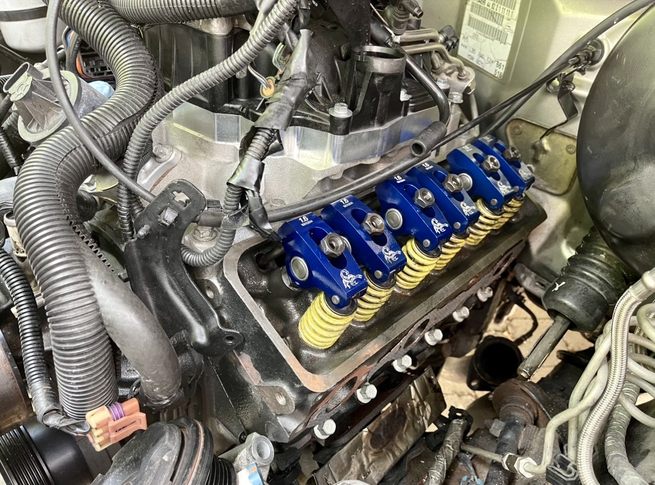

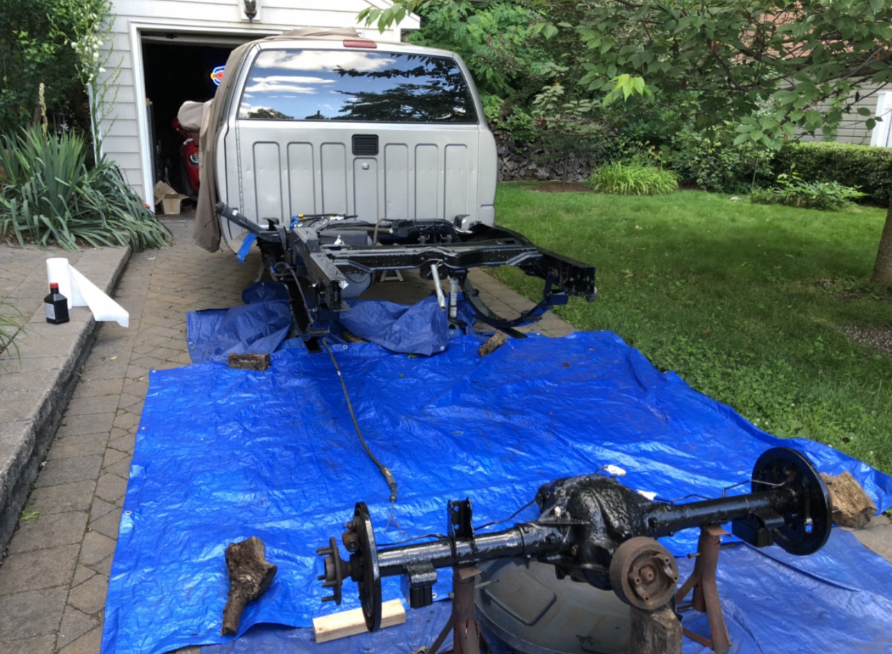

    @XPOTRPR & @White lightning boosted , thank you. Like I mentioned, this was a tribute to my dad. He loved these little trucks, I learned to appreciate mini trucks from him.
    The S-10 was a fun project. Restoration to the best of my ability, upgraded everything. I even taught myself how to tune after months of research and the HP Tuners home course.
    Installed the hottest factory cam, ported intake, big valves and ported hi flo factory heads, headers, etc etc. Out back is an 8 1/2 Eaton posi.
    All in good fun, and it handles wicked quick with zq8 springs, heavy sway bars, adjustable gas shocks, a Lee power steering 9 to 1 ratio steering box, and a factory Xtreme cross member frame brace.
    Ps: In the process I found out that nobody wants to work on iron heads anymore. I finally found out the dirt track guys are still using iron block/heads, and I had to drive a day to bring the heads to a guy that does all the dirt track engines

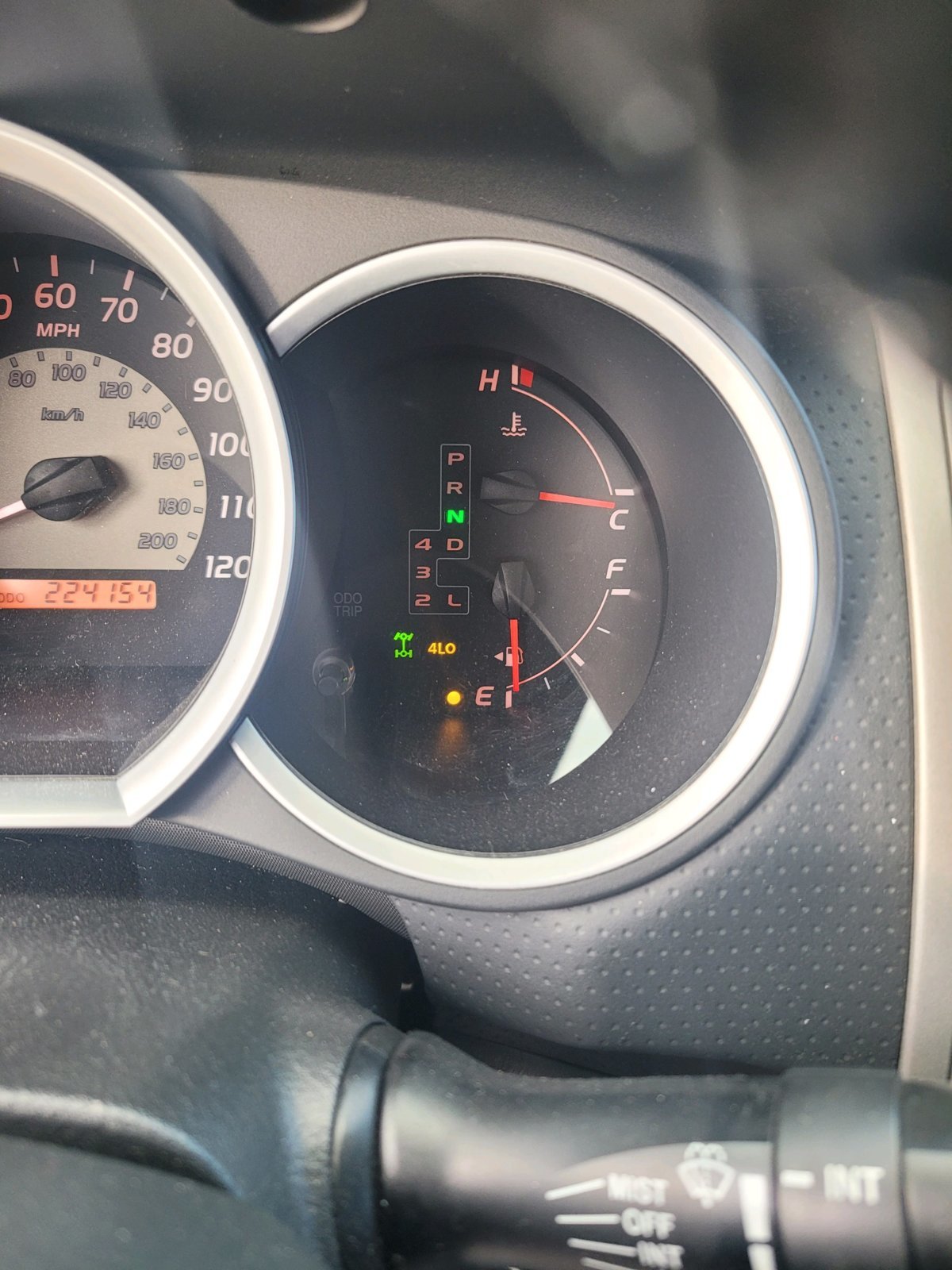

    I used a momentary rocker switch for my front ADD, did you do the same or use an awd axle tube?

    I got the add switch from 12 state, it's a nice piece of kit. Now I'm trying to figure out how to get to the dash lights

    The leds are already made into the 2wd cluster luckily. Just have to find some pins and insert them into cluster harness connector. Run them from the switches on the Tcase.

    Do I have to take the entire dash apart ? Everyone is good about explaining which wires to connect but nobody mentions or shows pictures how to get to them lol:anonymous:

    Nope just the cluster surround and cluster have to be pulled back. If I remember its the top 2 pins on the connector. Each switch gets a ground and the other wire goes straight to cluster.

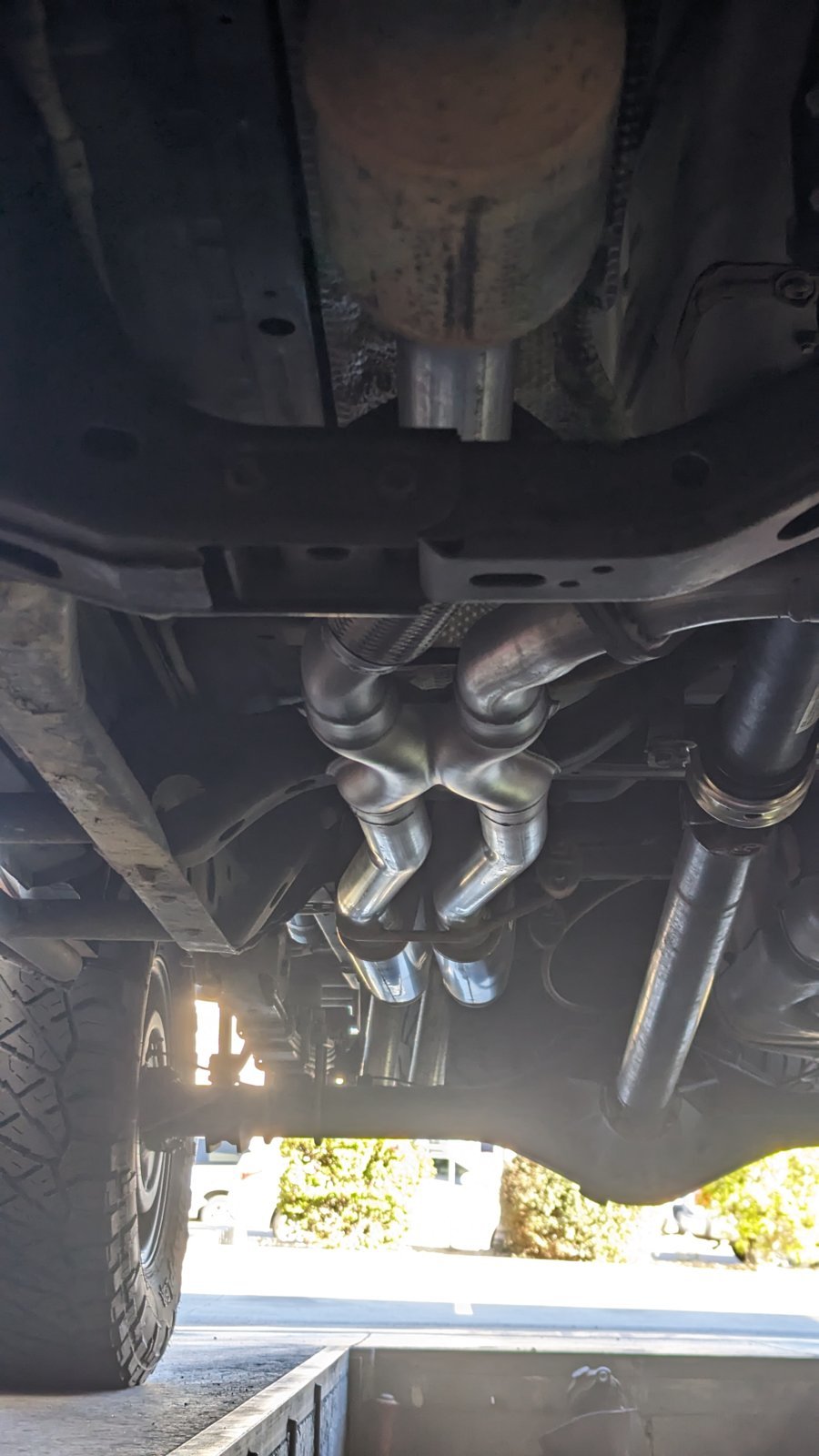

    Whats real dumb is that a 2wd 4runners exhaust is already made like the 4wd model. The tacoma is the only one who has an exhaust specifically for the prerunner

    The exhaust I don't have a problem with because I have custom dual exhaust going back lol, I hope the guys aren't too upset I cut up their xpipe masterpiece to get the tcase in lol
