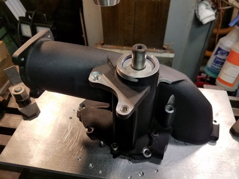

    When you replace the seal you will press the shaft out of the bearing under it and it becomes a nose drive rebuild.
    Once you get the pulley off you need a press or access to a press, various spacers/sockets and the rebuild kit from SCOL. There is a video at the beginning of this thread that shows the process.
    If you've ever felt either of those two M8 threads start to "give" slightly, now is the time to install keylock inserts.

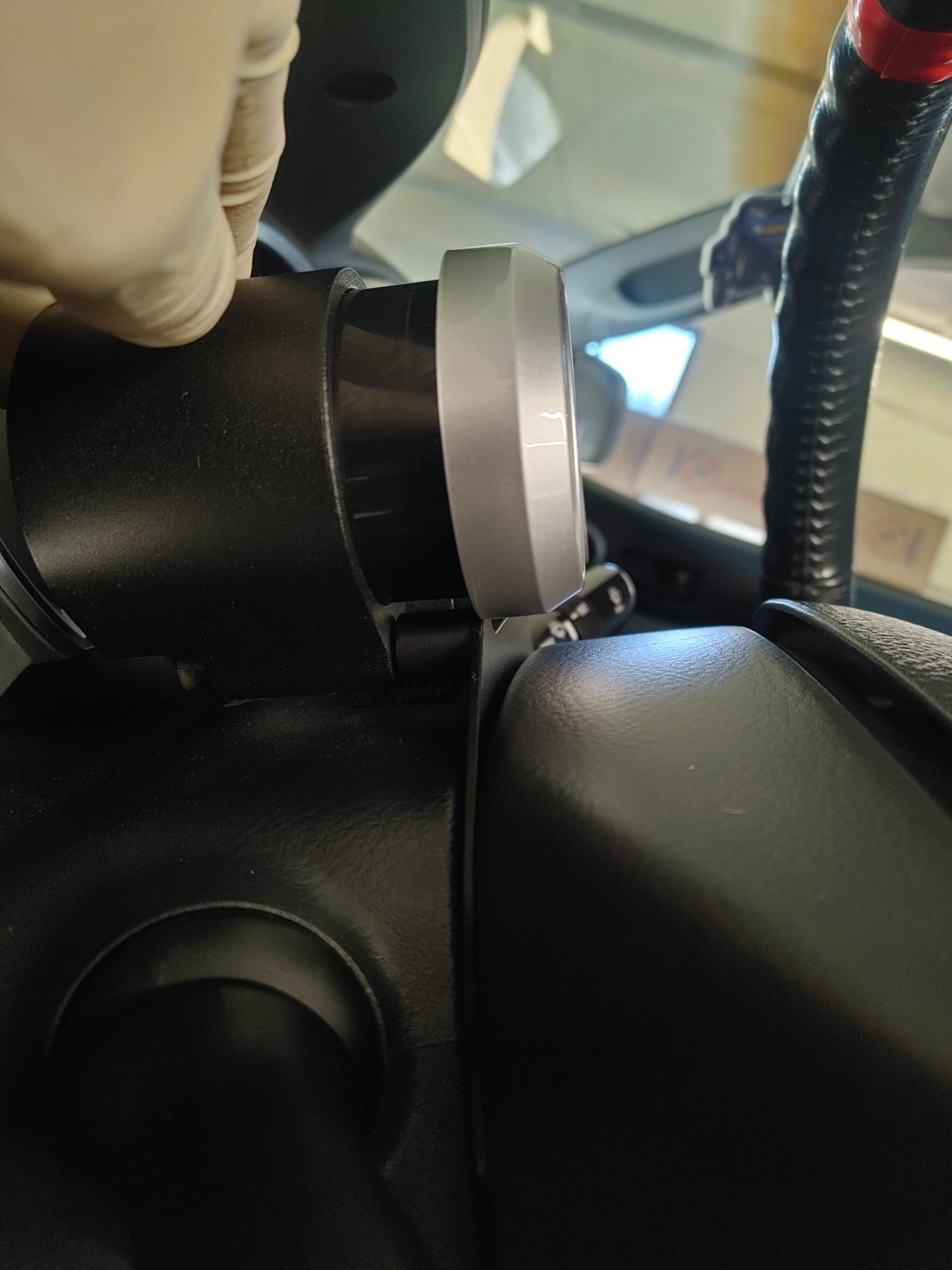

    Meh, I hope it grows on me, maybe its the yellow AEM logo but I'm not in love with them yet. I would hate to have no instrumentation with a boosted engine but im sure once its up and running I wont need to look at them much.

    Well this wont work unless I dont need to turn the steering wheel.
    Flipped the cup around and gauge wont go in and ring hits. WTF.

    I have the Perrin column gauge pods. They fit my PLX gauges well, come with round rubber inserts to adapt for different circumferences and have a pivot point to adjust positioning.
