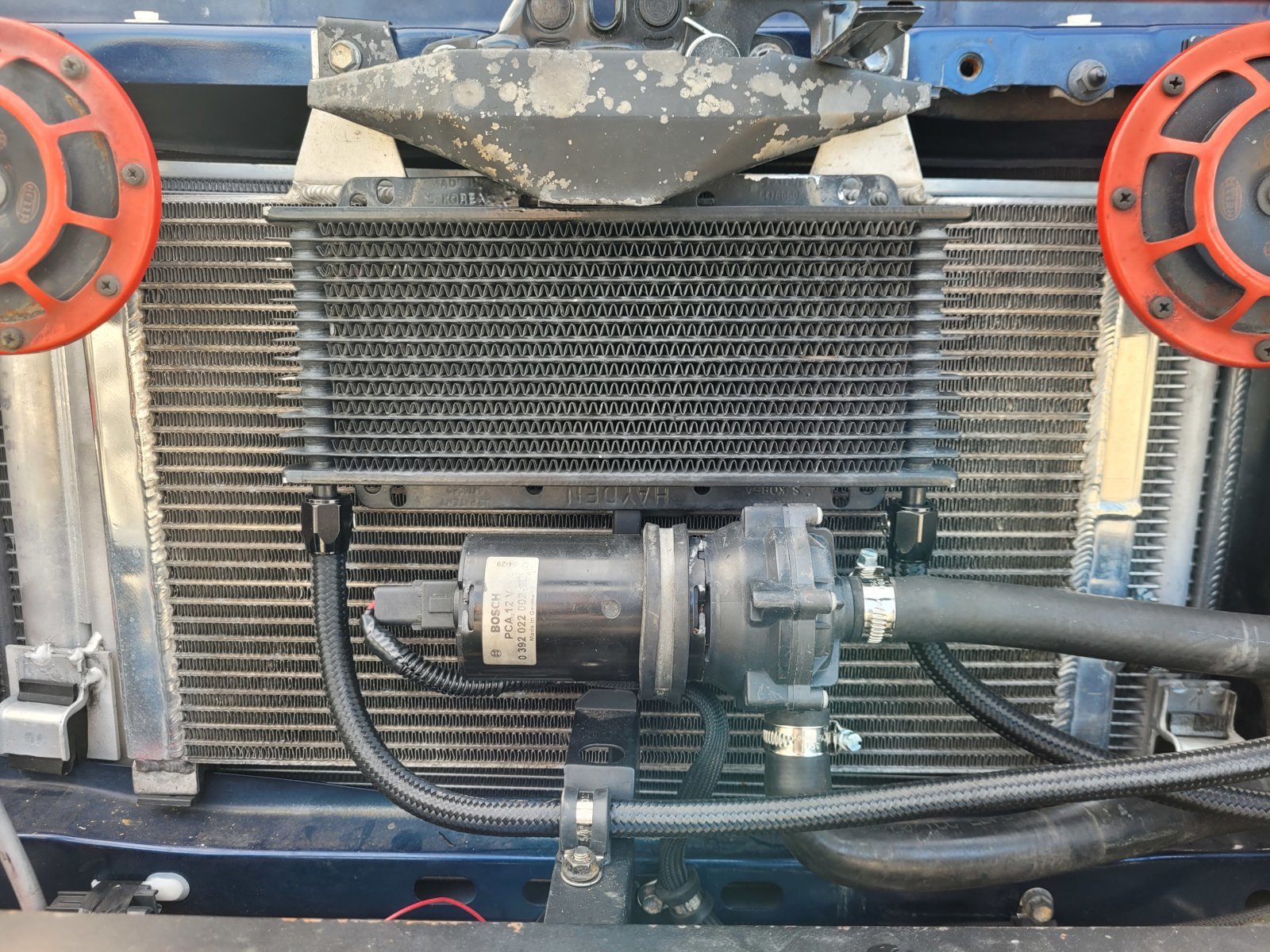

    Been working on cleaning up the front end shenanigans...

    Is that the standard heat exchanger behind the cooler? Looks different for some reason from my magnuson. Been looking at upgrading my core soon if it makes sense.

    Trans oil cooler?

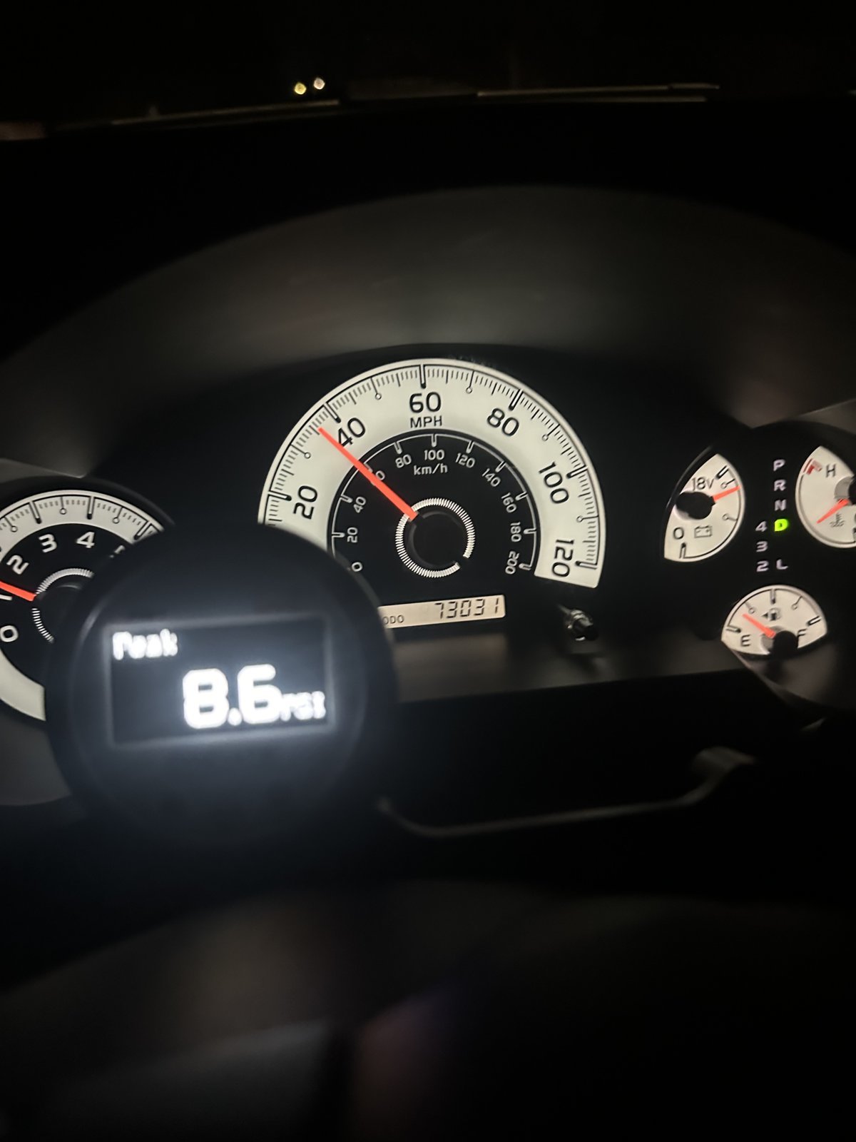

    Definitely. It screams, about 7.5lbs boost I think is the max I’ve seen. All I can hear from the cab :cool:

    Haha yeah I got a bpf cooling plate and the e fan conversion to try and mitigate more air flow through inches of cooling fins..
    I have the TRD supercharger so it seems the design may differ a bit. I considered upgrading the heat exchanger but have decided that a killer chiller and larger reservoir would be more beneficial in regards to overall coolant temperatures. But ive come to understand that the actual restriction in the whole system would definitely be the heat exchanger in the sc itself.
    Yes, ive ran it for quite a few years before due to high transmission temps wheeling in Texas heat. Ive seen 230* and after the cooler it never got past 180-190*. Was running 35's on stock gearing, ratiotek shift kit, alot of gear and weight.
