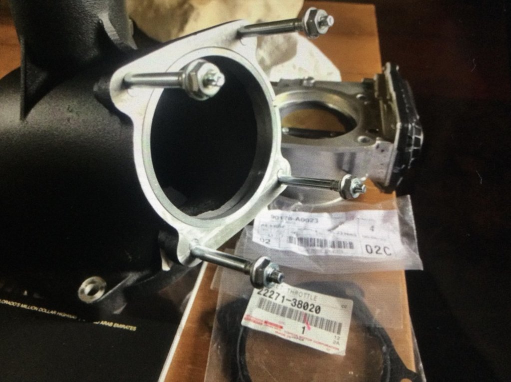

    Looking at the RCF as you suggested. 84mm might be too huge for our snout openings that an adapter is necessary. I decided to forego the adapter for more OE look and less questions and will fill/drill/smooth what's necessary to fit the 76mm.
    Per @Jowett here a shot from his machined piece. Very nice

    Glad to hear this is helpful!
    Also note (if someone hasn’t already) that while the 3UR and 2UZ throttle bodies are both 76mm, only the 3UR receives a machined flat throttle plate shaft for slightly improved flow.

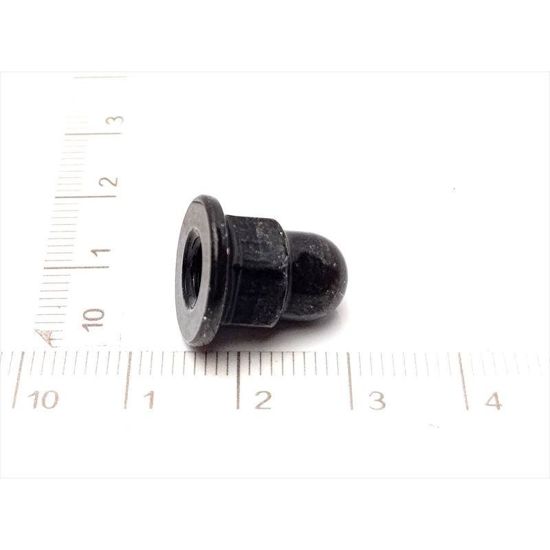

    Forgot, if you find the protruding hex lobular drive studs ugly, nut 90176-06045 is capped and will cover. Has the nice hd black/green coating instead of silver zinc.

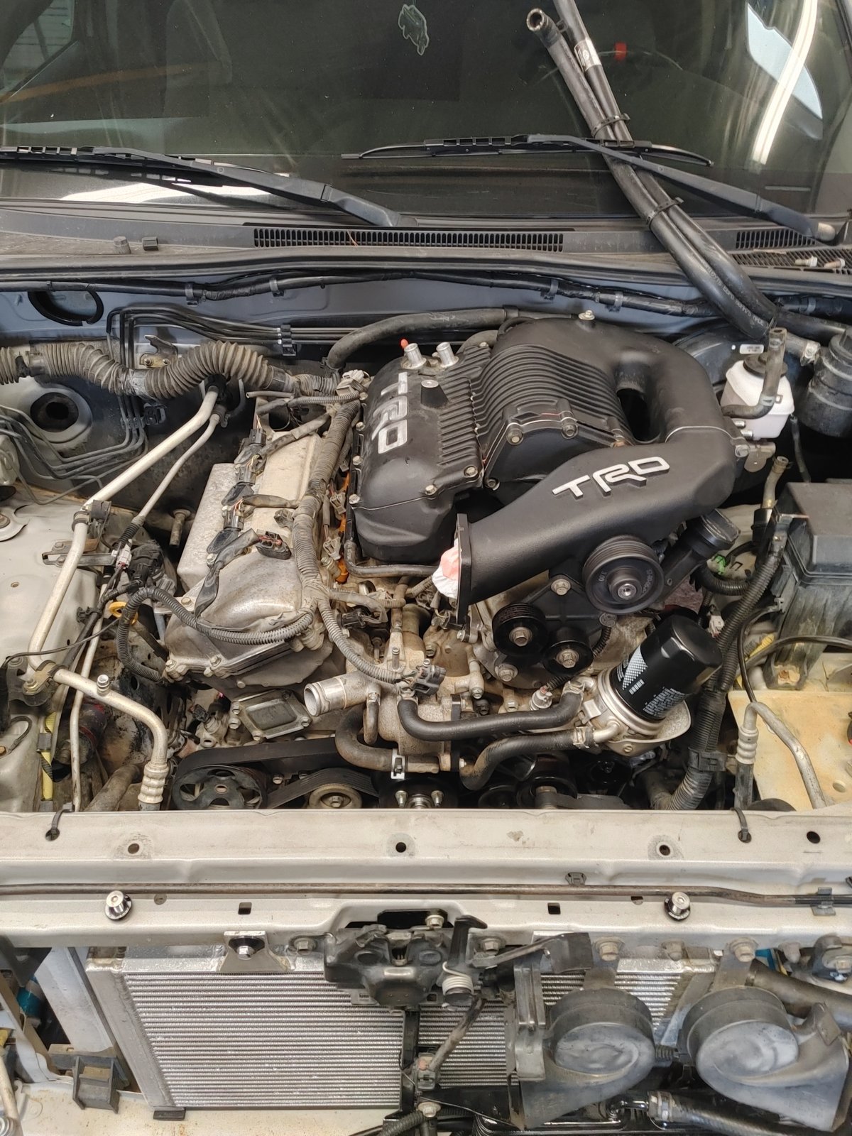

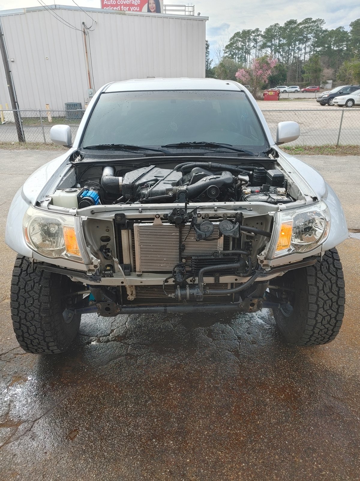

    So far between last night getting the engine out and putting the new one in this morning I'm about 6 hours in hope to have it started in an hour or two

    Well boys, I'm supercharged now. Cranked it up and it was dead missing on cylinder 5. Thank God that cylinder is easy to get to. Injector was stuck. Gave it a few Taps and shot 12 volts to it to hear it click and it's been running great ever since.
