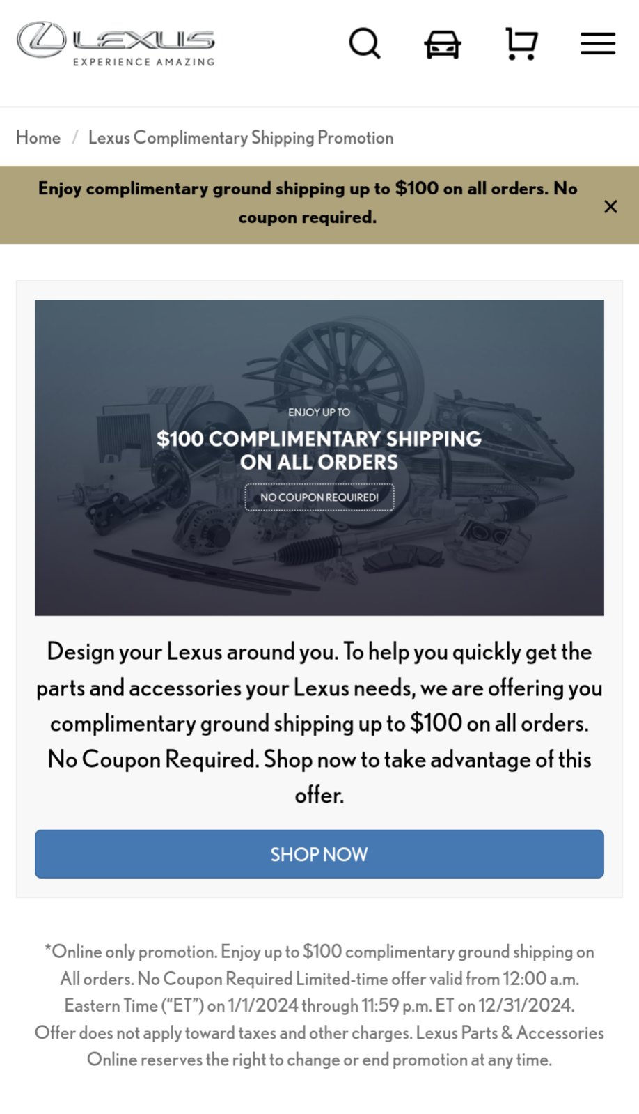

    Free shipping from Lexus Westminster. Not the cheapest parts dealer but saves some hassle https://parts.lexuswestminster.com/
    Great idea. Or just drive through some mud like some have suggested in the past lol. I ended up scoring a fairly new used lx570 TB but skipping on the adapters so it looks less modified.
