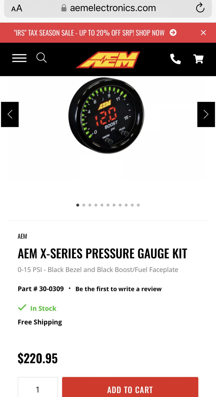

    I’m considering switching out the boost gauge to one of these:
    Just wondering what everyone is using now, thanks for any suggestions :)

    I'm running AEM gauges for both afr and boost. not that X series one tho.. the one under it. no issues with either.

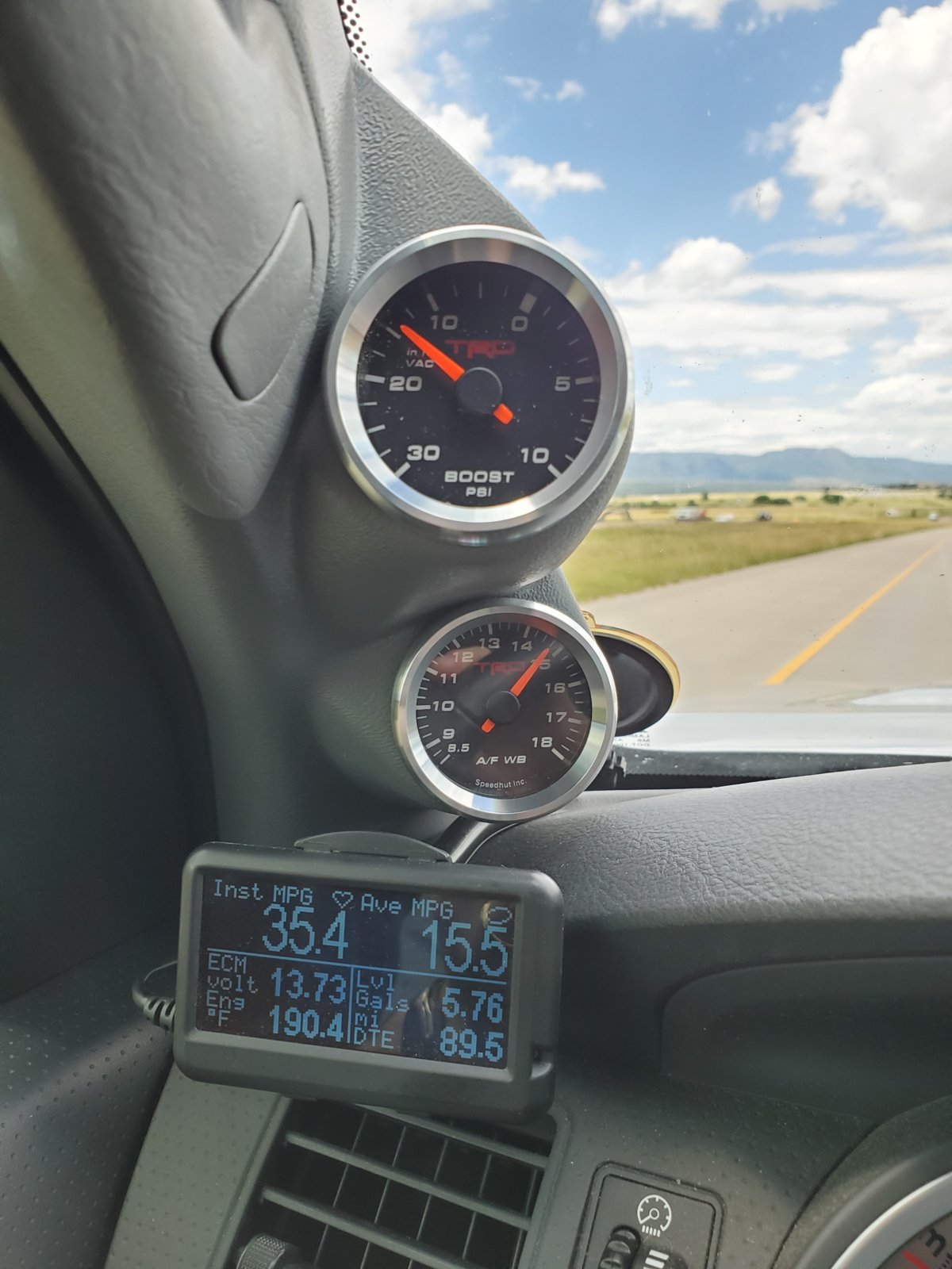

    I remain happy with Speedhut Boost and AFR gauges.

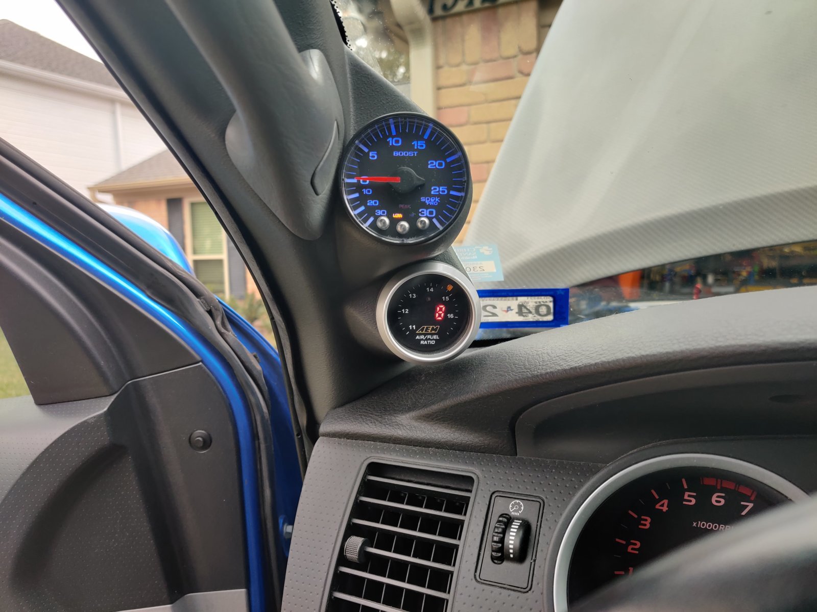

    i run aem. been great. only advantage to an analog gauge is not having #s fluctuate rapidly. @Norton has some nice ones.

    pretty sure I have the same ones.

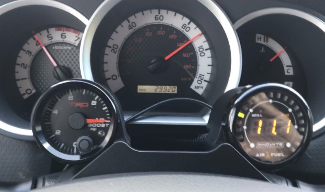

    First drive with the gauges hooked up. 5psi with a 6 one time. 2.85 pulley, what gives?
    Afr was scary lean at wot for about five minutes and then it started showing consistent 11.1 at wot. UEGO is across from primary 02 passenger side before 1st cat.
    Feels a little weaker than when I first got it running last weekend. Havent driven all week.

    Altitude?

    Do you have a large >10% LTFT error anywhere? Specifically, around 3K-4K RPM at part throttle?

    I need to hook my scan gauge back up and monitor engine output while driving for sure. Was doing fine before I hooked up my boost and a/f gauge. Maybe line is loose/leak somewhere. Might but orange cap back on supercharger boost port and see how it feels.
    Idles great, has tons of vacuum at idle

    What are your mods and what sort of gauges are you using? There's too many factors to know what your actual boost should be, but on average stock boosted outside of the pulley nets around 8.5-9 psi (too high, but I digress, let's take it one step at a time).

    I agree. Hard to diagnose from miles away.
    2.85 pulley
    Walbro 255
    Cam gears
    Aem wideband and boost
    TRD flash
    Last weekend was initial install and felt strong but did not have gauges hooked up so no idea specs. Hooked gauges up this morning and took it for a a run. Idle is 14.7, as well as cruising. Initially full throttle was 14s, 5 psi max. A few miles later was showing 11s at full throttle, consistent 5 psi, max 1 time of 6.

    That's low for what you got. You typically need exhaust and a smaller pulley to hit boost numbers that low. Are you tuned by Justin or is this a stock tune file?
    You are going to need to check vacuum lines and AFR sensor tightness.

    I think @IvanhoeTaco is running trd reflash.
    For afrs...are you boost referenced?

    Stock trd flash by justdsm

    Honestly I hate this wideband. This is my first boosted vehicle so im new to monitoring, but this gauge is all over the place
