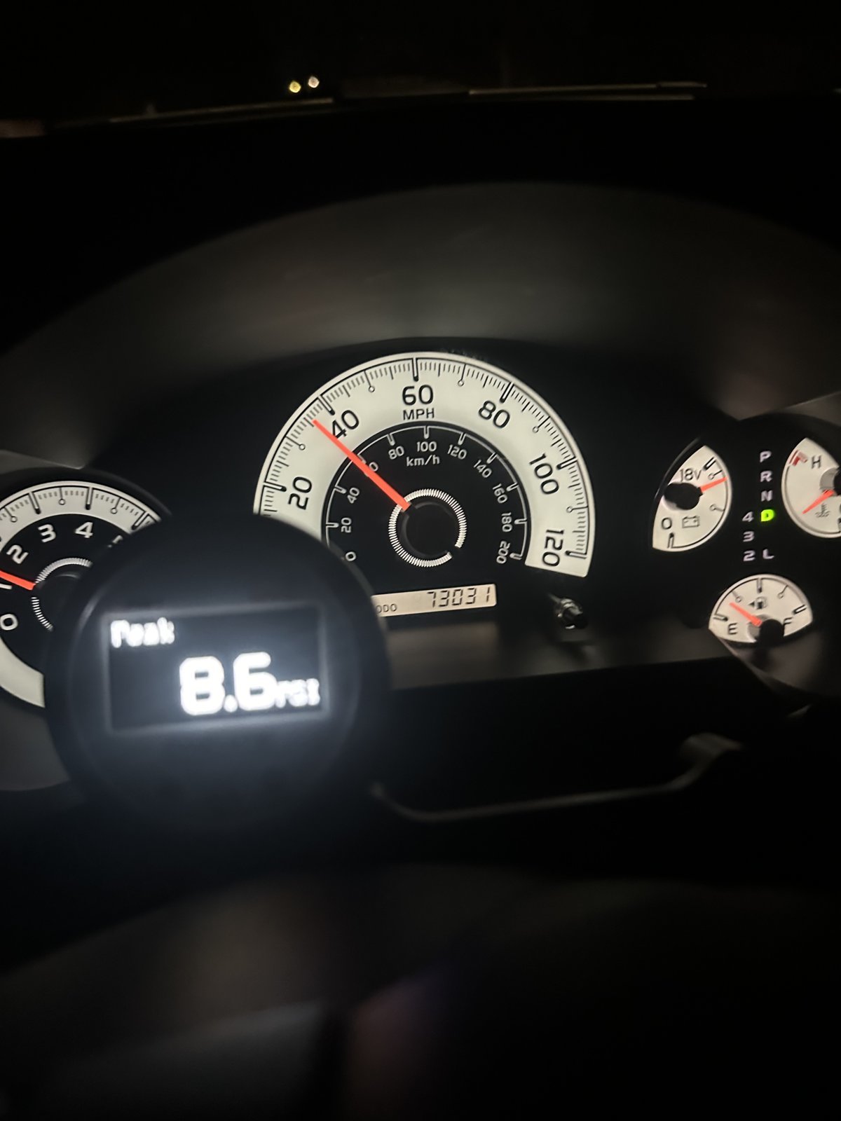

    let me check my peak saved on my gauge. I think you should be getting more too.
    We have pretty much the same setup, can gears, 2.8, TRD flash and all. Sea level & even slightly warmer temps here in SoCal.
    I wanna say mine is around 7-8psi.

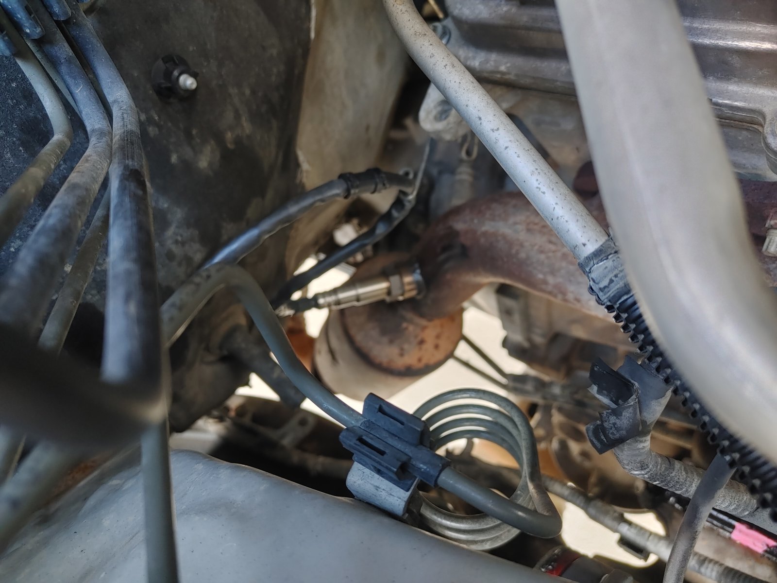

    Any hope of being able to run an aftermarket intake with an ARB compressor under the hood?0216242014_HDR.jpg

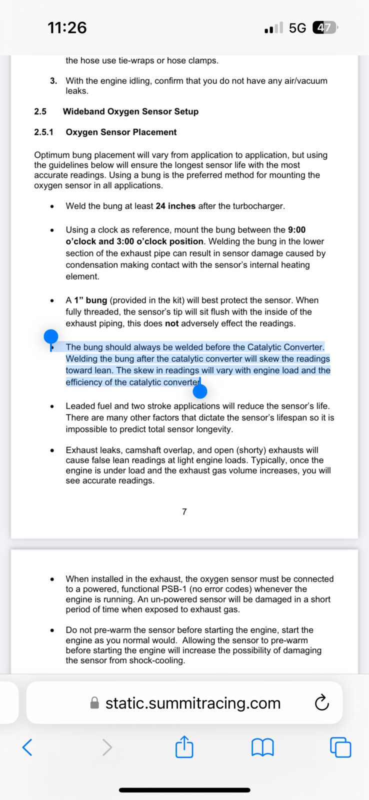

    I’ve never had a problem with them as long as you install them as indicated and directions (before cats at 10 o clock or 2 o clock position). They also need to be calibrated every so often (also in directions).

    I don't see why you cant. You may just need to relocate the air lines. I cant recall when I removed mine. I also had my compressor there, but I relocated my SAI (which you don't have) to that location, and the only reason I removed the compressor (moved it inside one of the bedsides).

    I thought you wanted it before the secondary cats, not the main cats? I could be wrong but I have always seen them burned in on the Y pipe for the aftermarket AFR.

    You may be correct. This is my first rodeo. I forgot too that these exhaust systems are double walled. Originally I had planned to put the sensor at the y pipe but it wouldve made the sensor at a 3 oclock position

    Always before any Catalytic Converter if you want true readings. Have done this on two supercharged s2000s, a supercharged G35, and now my FJ without any issues

    People do them at the Y pipe or between the cats because you can do it without taking the headers out. Not the right way per AEM or Innovate
