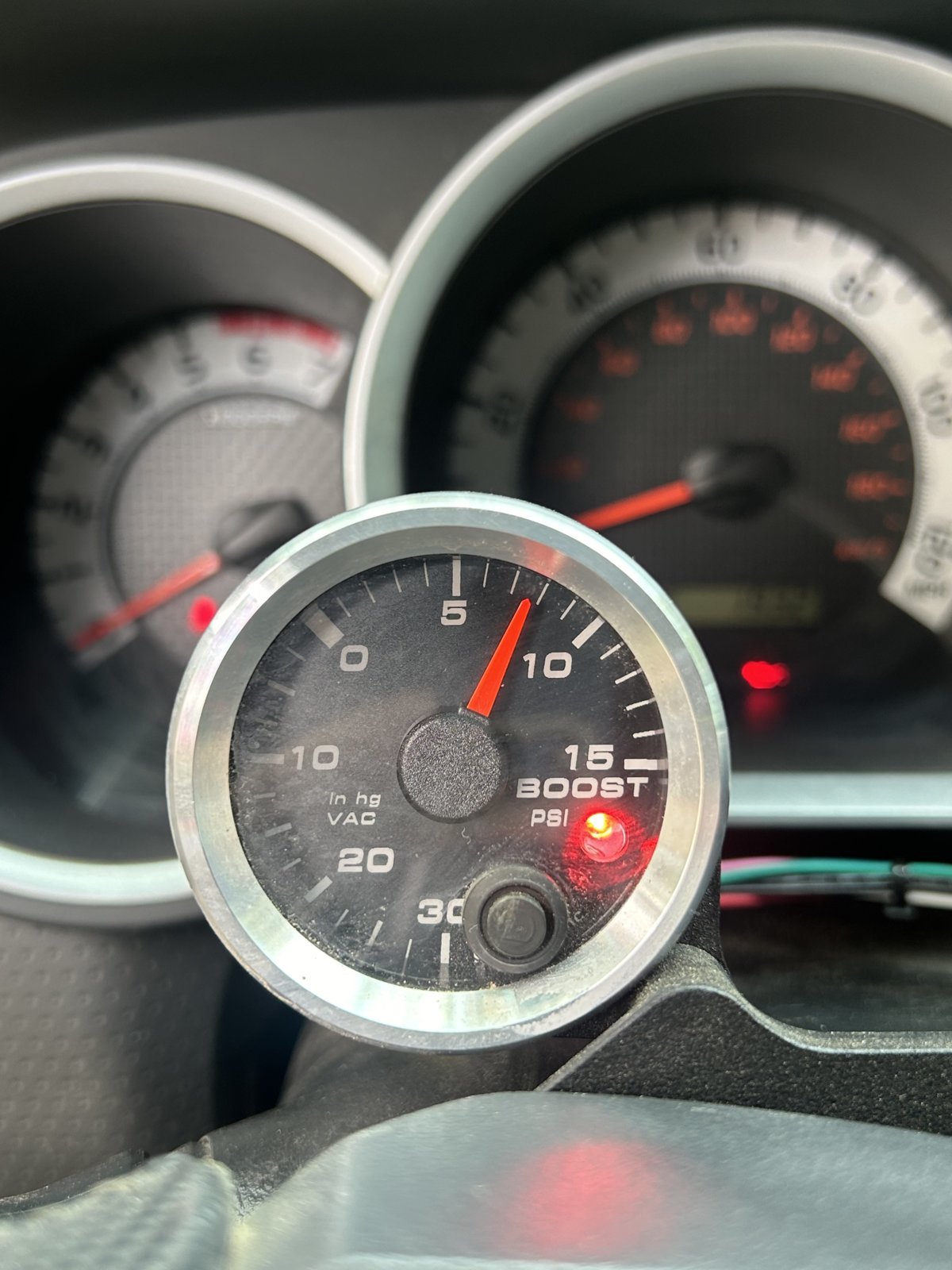

    I had the exhaust off during engine install so I figured id put it where it supposed to be

    Mine shows just below 8psi peak with the 2.85 stealth pulley - cam gears, and an intake. Usually around sea level and 60-80° temps.
    Think that boost lid sealing was the issue @IvanhoeTaco :thumbsup:

    Yessir just took my wife for a run and she agreed its stronger now.

    Hmm I wonder what my issue is then I can only see mine barely flash 7 sometimes

    You have a much more open exhaust, correct?
    my exhaust is all stock
    opening up some of the restriction after the blower, usually results in a little less psi. at least that’s how I understand it.
    conversely, freeing up restrictions before the blower, like an intake, will allow for greater psi

    Also, tuning seemed to make a big difference. When I first had my set up. 2.8 pulley, Cam Gears, TRD Intake and some good old @JustDSM tuning all stock exhaust I was hitting 9 almost 10 PSI. I cant recall if that was us trying to get the FJ intake/MAF to work. The tune always seemed to not be peppy on the low end so Justin did his magic and now its sits around 7ish maybe 8. Im due for a tuning session with Justin once I get my truck back and hopefully start to free up my exhaust at least what I can do.

    I wish I had some hard data to share, but I really don't.
    It's safe to say a free-er flowing exhaust will drop the pressure, but it's difficult to make predictions. Generally, on these applications I don't worry too much about boost pressure since the engine management only cares about air mass.

    those gauges are kind of a mind scramble for me too. with a rather large pulley at sea lvl youre not far off imo. humidity and temp chane things too. log and check.
