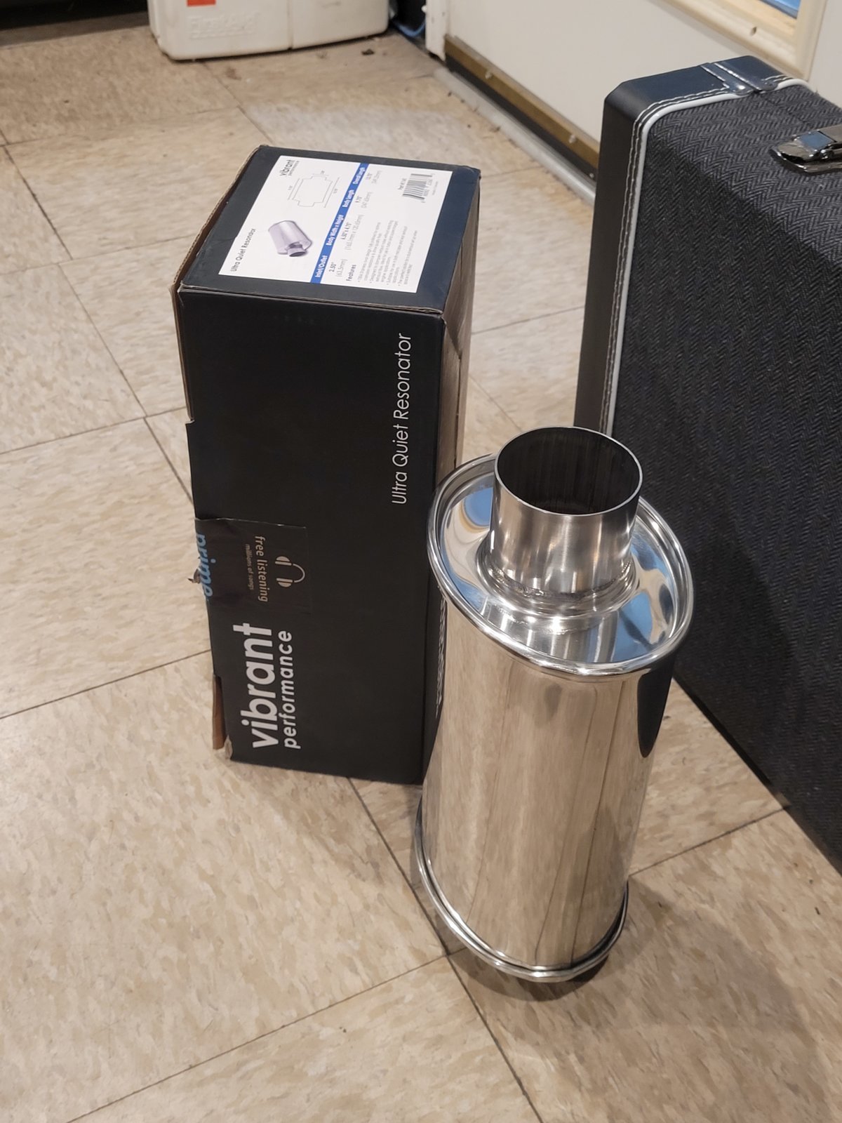

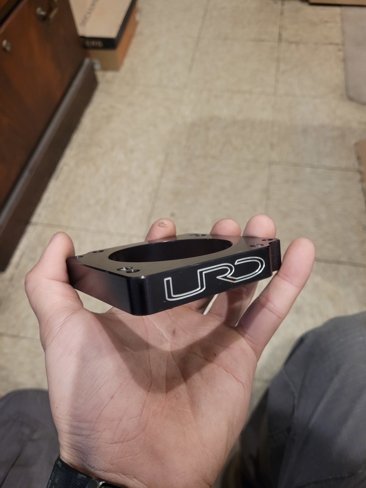

    Just got this from a local member.. been waiting for it to be back in stock at urd for what seems like a year.
    Also got a vibrant ultra quiet resonator to try and tone down the spec u headers and urd y pipe combo..

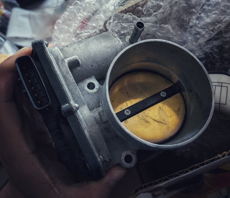

    I got a match for that adapter..

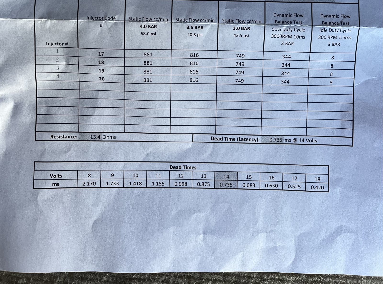

    Mine are 750cc’s

    Here’s the printout they sent with them. They were plug and play and have been great for me so far

    Reminds me of Deatschwerk modded injectors for import vehicles. This is cool to find options. Some places won't sell aftermarket injectors to Calif due to carb restrictions they say lol

    careful welding in that resinator. metal is quite thin.

    But quality brother
