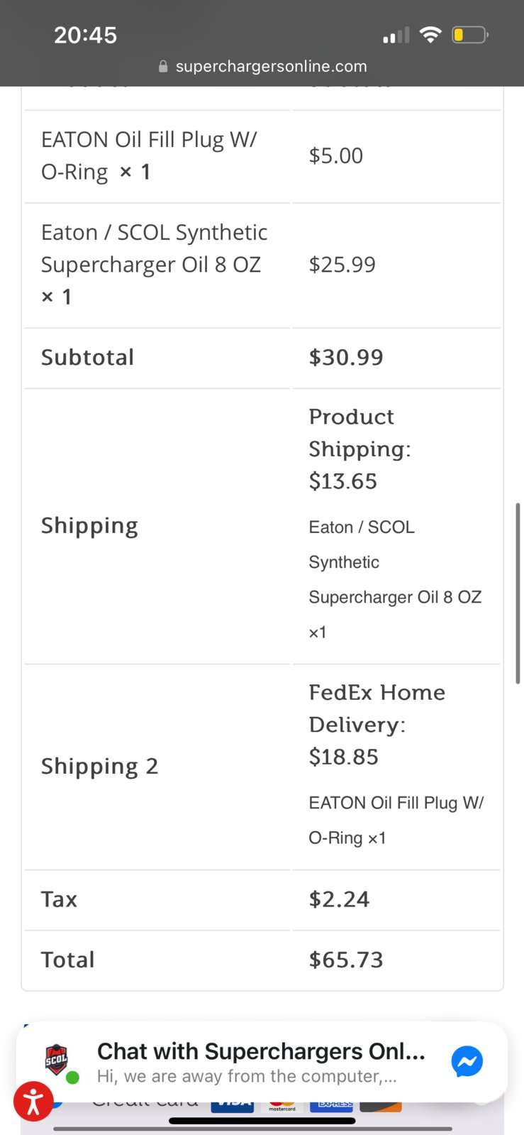

    I wanna support SCOL, but $65 shipped for 8oz of oil and a small plug/o-ring?!
    Gonna go with the GM oil instead…
    Eaton oil can’t be worth 6x Amazon AC Delco

    It seems like it isn't shipping them together which definitely isn't right. Might have to call or email them and ask wtf is up
    edit: I just checked and I only got charged 18.50 for shipping a lot of parts needed to run the supercharger itself.

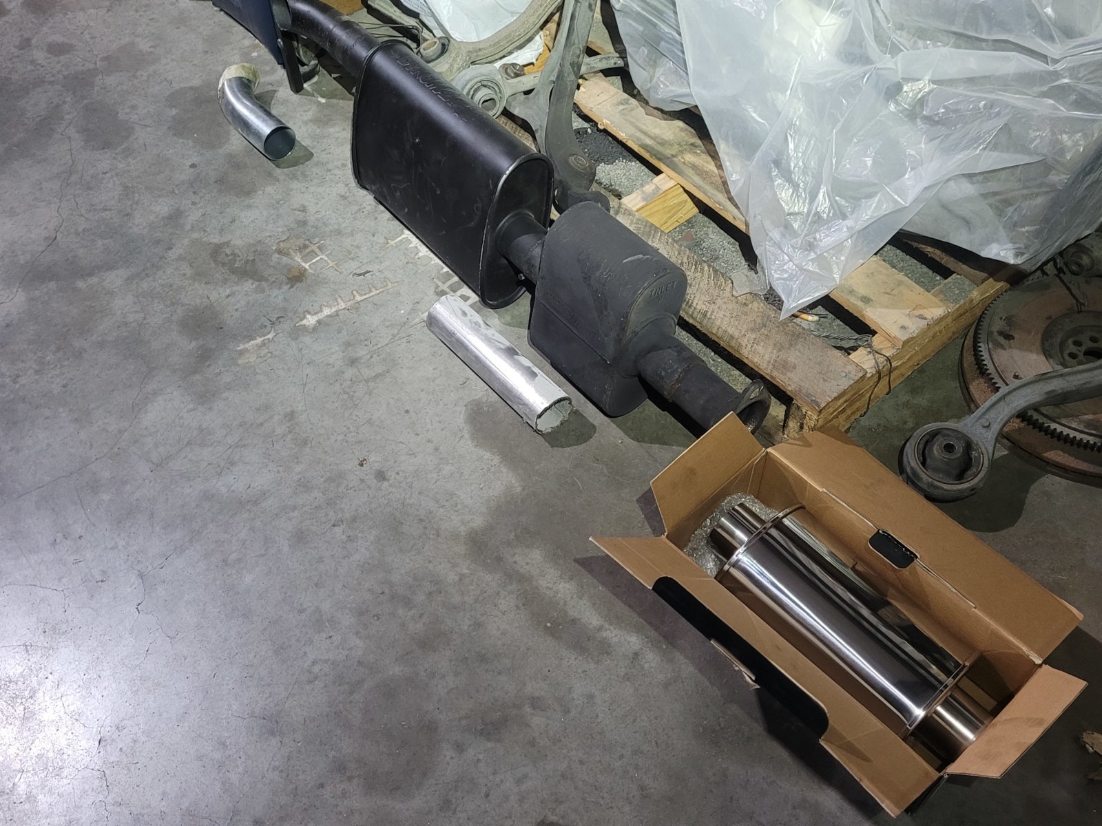

    I actually just picked up a titanium dual voltage ac/dc tig welder this morning as gmaw/fcaw ain't cutting it with welding 304... Should have it setup in the next few days.. excited to run some 308/309 soon..
    Actually I do remember messing with it before and after the rebuild and they never made contact in any way that was discernable to me. Maybe if you squeezed the ends that install into the blind bearings. Do keep in mind that the housing bearings play a huge part in keeping a particular tolerance between the rotors on that end of the assembly.
    This is probably my 5 exhaust setup I've done in the last 3-4 years. I currently have a flow master delta resonator and dynomac turbo muffler setup. I think I will add more piping in between the resonator and muffler and replace the flow master with the vibrant.
    Have a bunch of 304 pipe, vband and hangers otw. Quick mock up of what I had laying around earlier today at the shop.

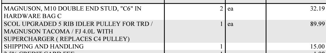

    Shipping seems off for sure as mine averaged $20 or so for a handful of orders.. after some review, I paid $30ish bucks a pop for those 2 threaded studs which still upsets me as I couldn't find an alternative. Ones I got were bent lol

    I had 2 resonators going to my URD magnaflow muffler. Still had a small rasp that annoyed the hell out of me. So much so that I was heavily considering taking off the URD headers in lieu of the oem manifolds
