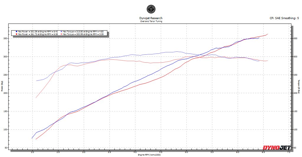

    Blue: 1GR Dual VVTi w/ Maggy TVS1320
    Vs.
    Red: 2GR w/ Maggy TVS1900

    do i see bigger isnt better?

    I don’t think we can make that inference on that data point alone.
    1GR has .5L displacement advantage. What I believe to be a higher rotor speed relative to the crank compared to the 2GR/TVS1900 (need to verify that) as that could be a large variable..
    Just thought the close match up made for an interesting comparison!

    yes, displacement always counts. rotational speed and cfm delivery will be intersting to see.

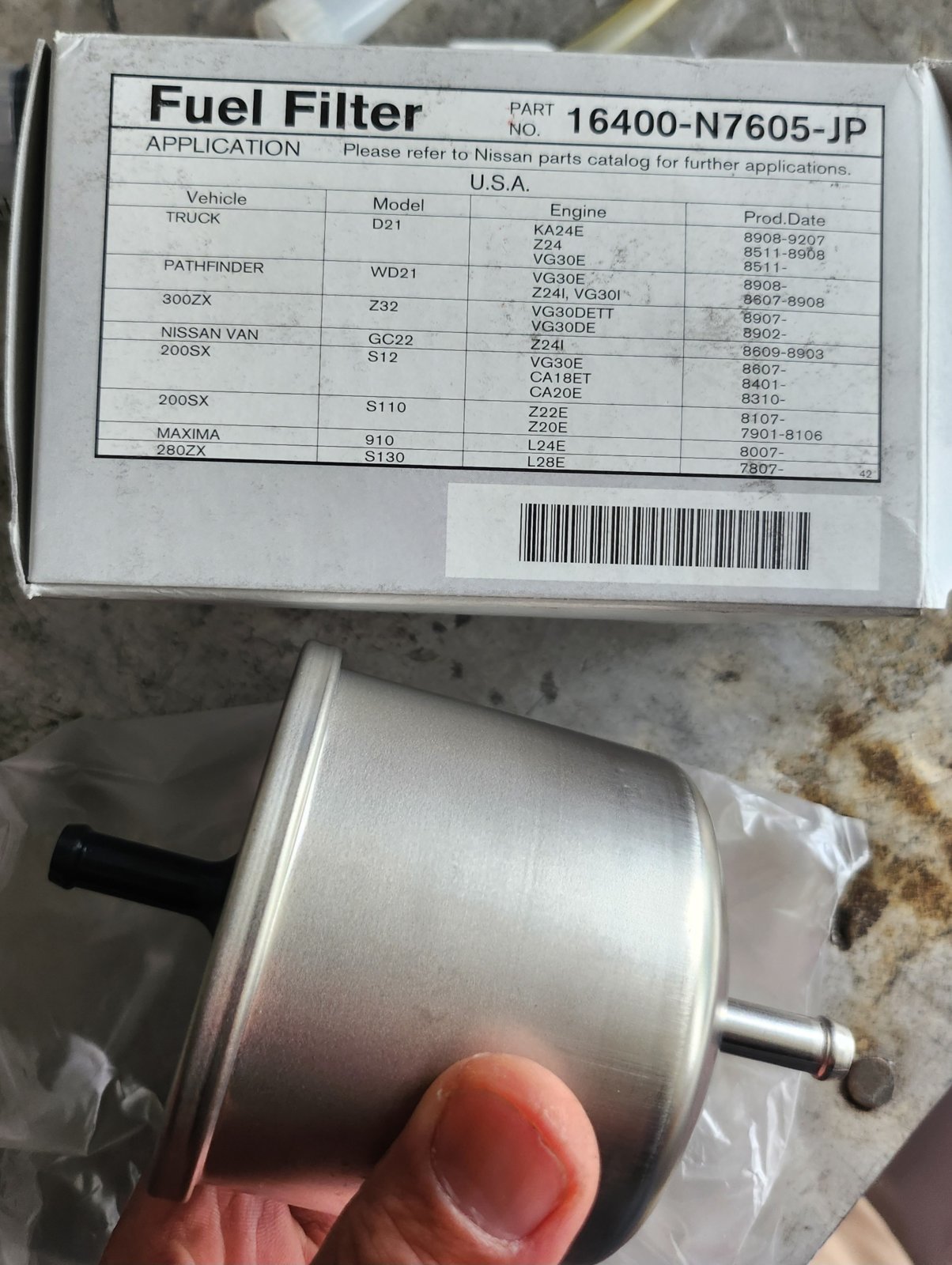

    for the fuel pump does it matter if I install an external fuel filter? I picked up a fuel pump many moons ago but was not the URD kit. I had picked up similar one to @Lucario Runner but trucks in the shop and Tank had to be dropped so good time to FINALLY swap it out but won’t have the external fuel filter available but could try to get the Napa one for now like the URD. If so anyone have the part number? @12TRDTacoma finally

    Does not need external or could be added later. I have the aeromotive 340 and still have plans (have a SS fuel filter.. I'm lazy) to install but been driving that way for a couple years now with no problems.

    @nudavinci64
    Use the factory Nissan fuel filter for the Z32 Nissan 300Z Twin Turbo. It's a replacement for the Napa one that comes with the urd kit.
    I think @Athlaos posted about this in the past.

    Nice! I’ll get it installed without for now. Good call on Nissan filter. I do have the PST setup but wasn’t ready to install. Good to know it’s not needed and figured since stock it does not bit the added filter seems good to add.
    Since the tank is out it’s a last minute add. For the current work.
