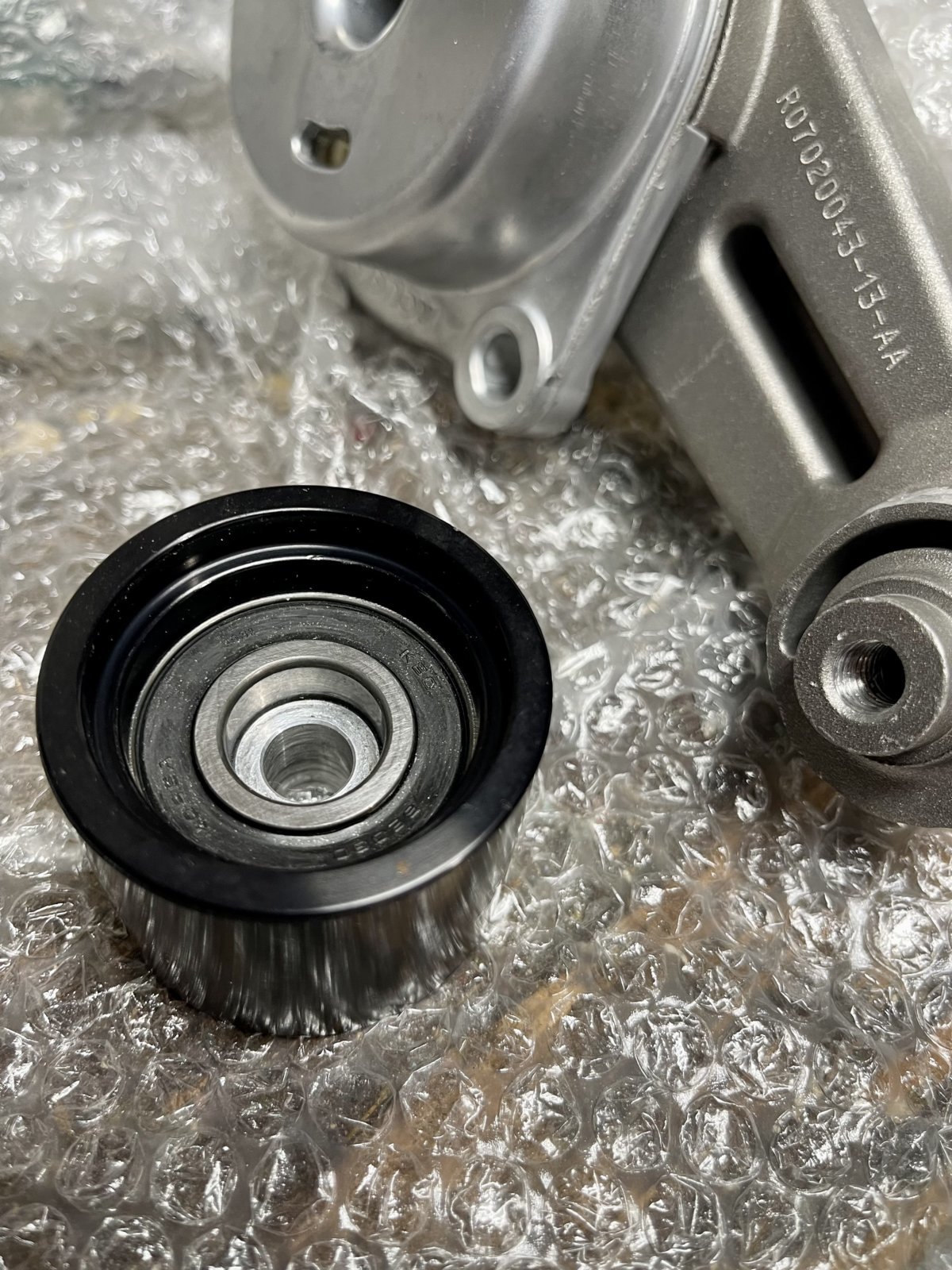

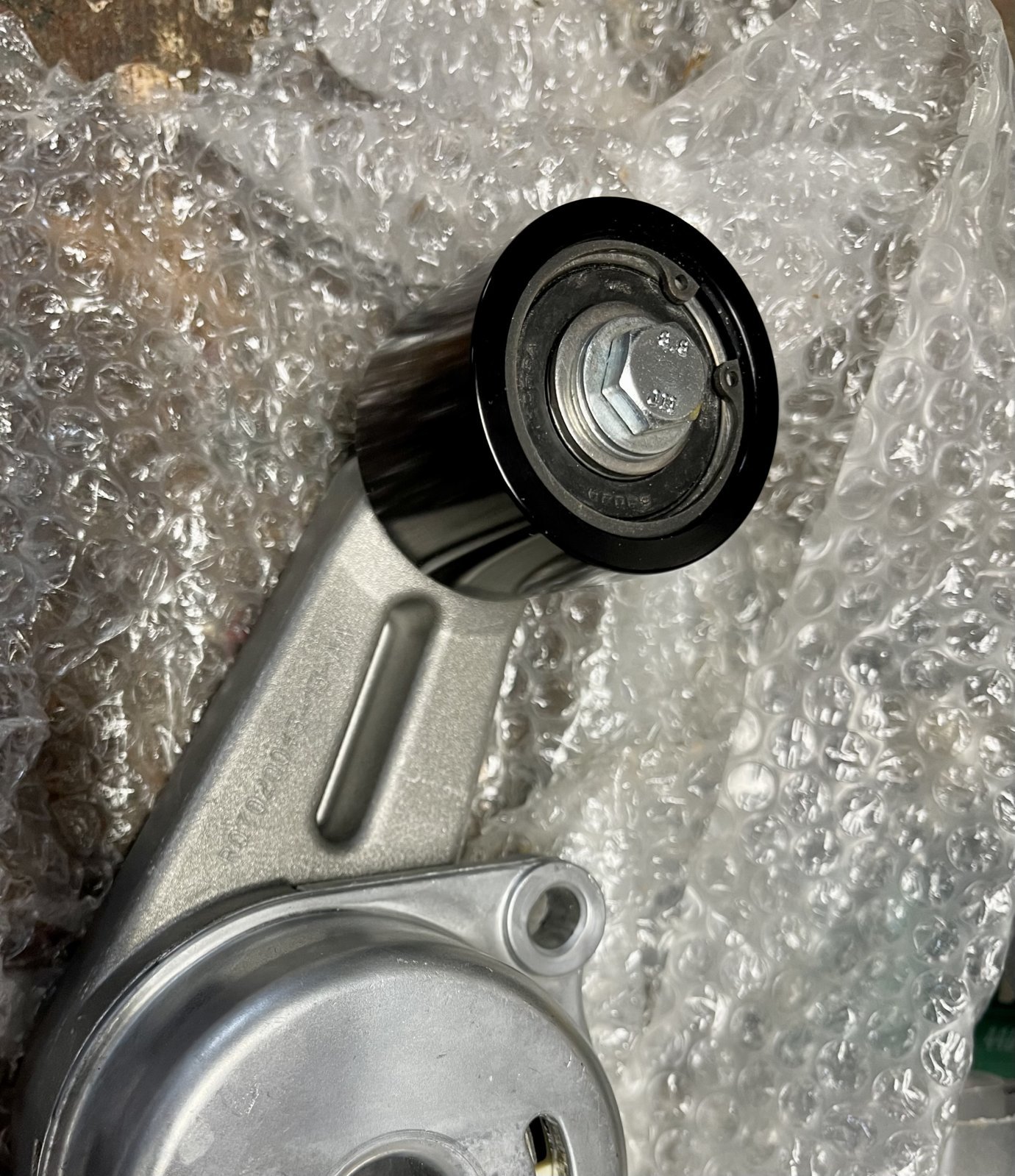

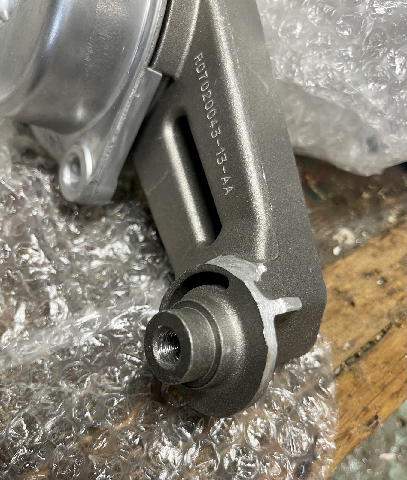

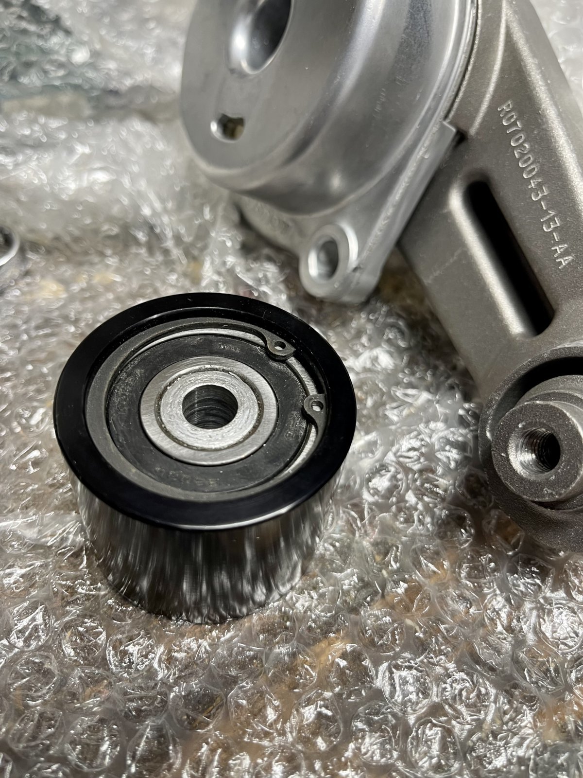

    Still plugging away with belt slip issue. Yesterday I had the chance to fit the double bearing pulley to the Rousch tensioner I bought.
    Trimmed the tensioner down with a dremmel and a flat file, and pressed out the inner collar of the pulley in the bench vise, measured and cut it with a copper pipe cutter, then pressed it back in.
    The only thing holding me back from completing the job now is my inability to find a K050705RPM belt for sale anywhere. Hopefully these things will come back in stock soon.

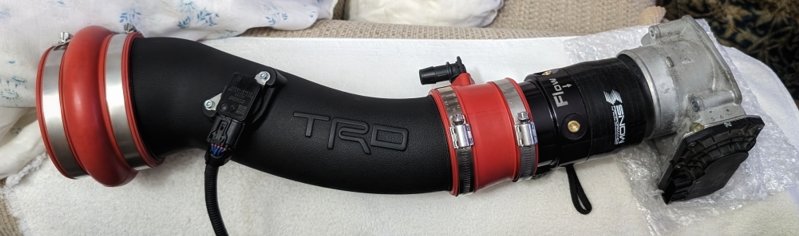

    Thanks to @Murphinator who met up randomly on a Friday for that TrD hookup
    Trd pipe-> snow meth -> 76mm tb (85mm on the coupler side)

    Nice. :thumbsup: might end up having to cut a rib off another belt instead.

    Worst case scenario, but not a huge issue :cool:

    thats gonna be a tight fit.

    Probably will have to take off some length from the tube, but I'm mounting the TB directly to the s/c snout, no dapter

    You will but that will mess with the maf scaling and make the truck run terrible.

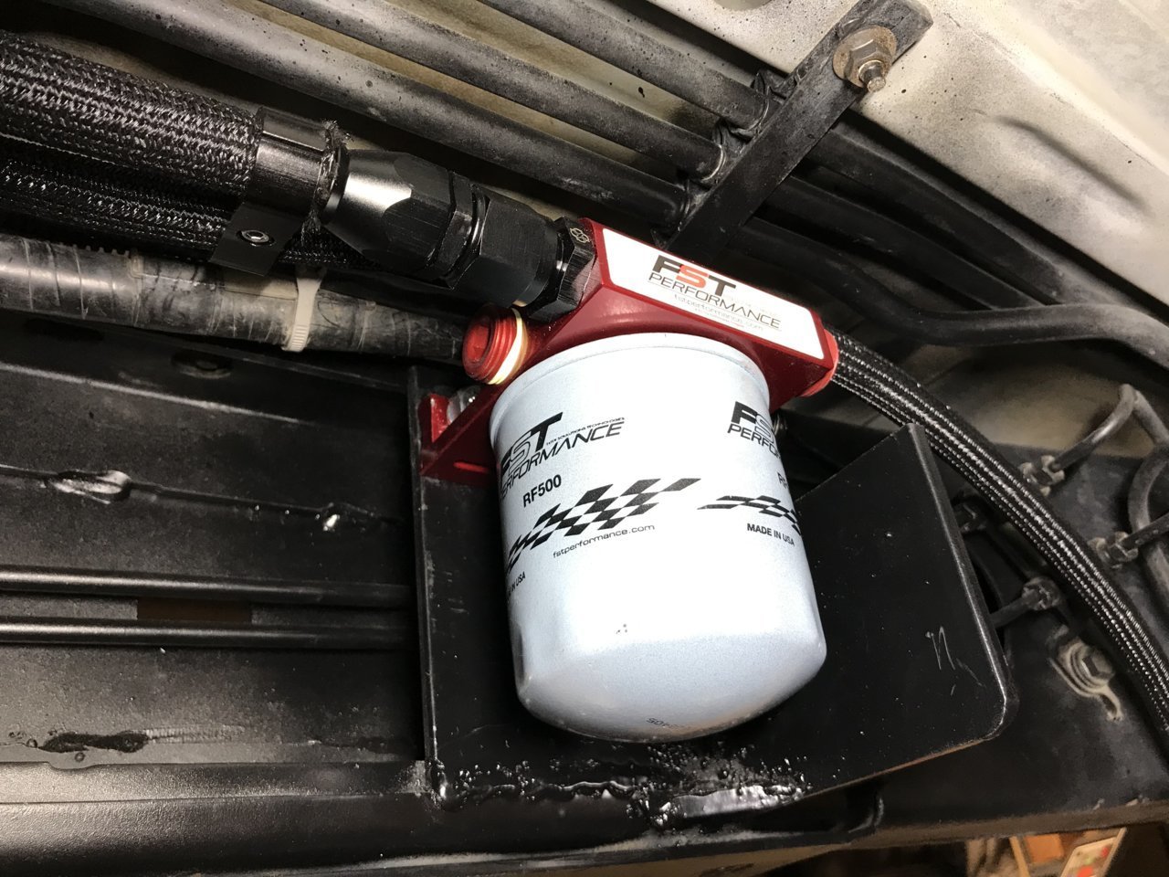

    also room wise mine is tight with the adapter and I cutoff 1/2" or so and its still super tight. Looks like you need 3 or 4" removed to fit.

    haha indeed trucks going through some major updates right now and they had to drop the tank so figured lets get that sucker in.
