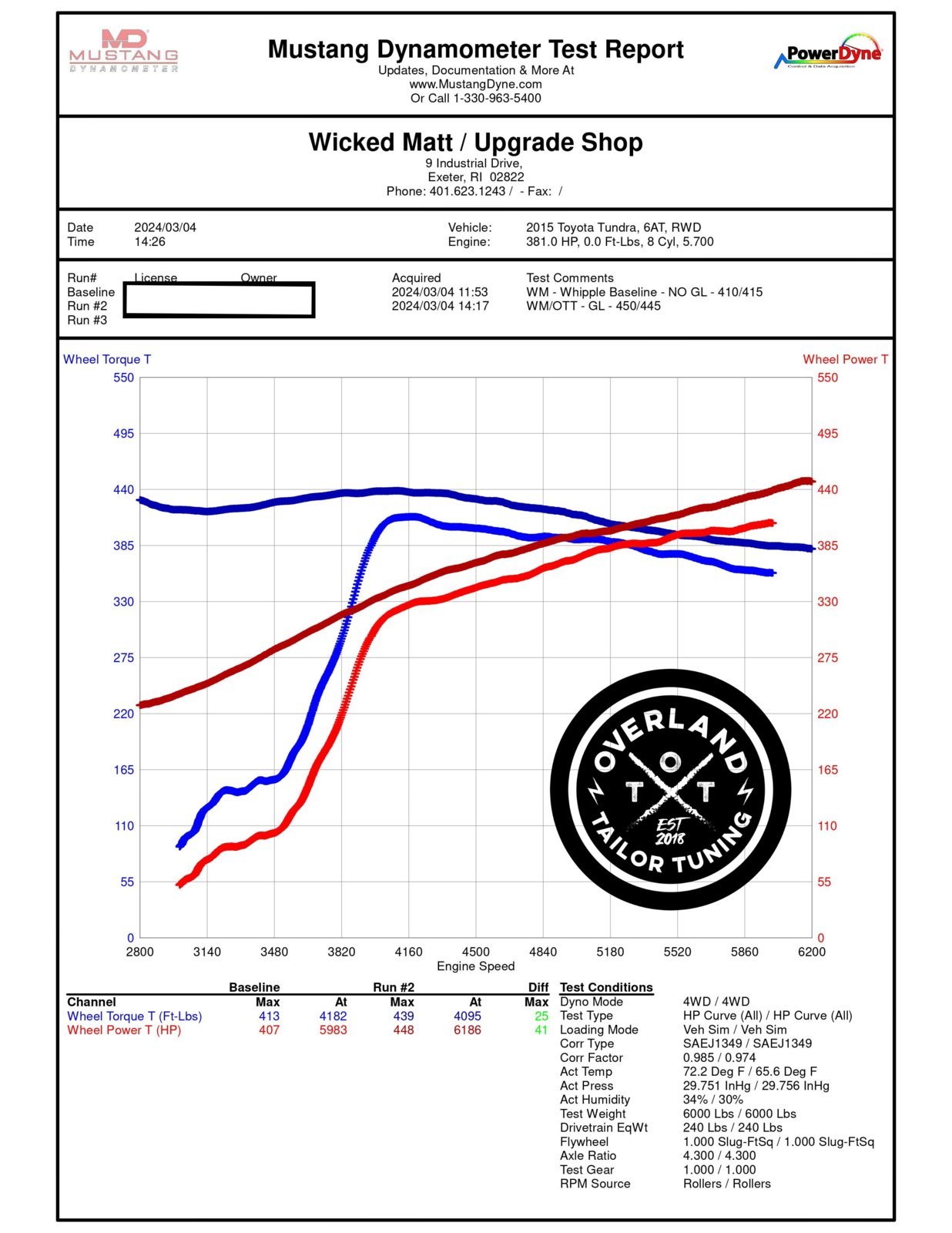

    Be sure to email us for Gear Lock files. Otherwise, you're only going to be able to compare 3.5-4K RPM and above.

    It'll keep the transmission from downshifting when you're making a dyno pull, so you can start your pull at 2.5K RPM or so and do a full RPM sweep to Redline.
    If you don't use a special gear lock file, you'll only be able to go WOT at 3.5K-4K to redline. If you try to go WOT earlier than that, the trans will downshift and totally botch your run.

    @JustDSM are you still doing remote dyno tuning? This would be a good option for @FishingInSand to get good value out of the dyno session rather than just measuring.

    We sure can and do. Did a Whipple Tundra the other day on a dyno in Rhode Island. Shoot us an email to coordinate it and get the discussion started.

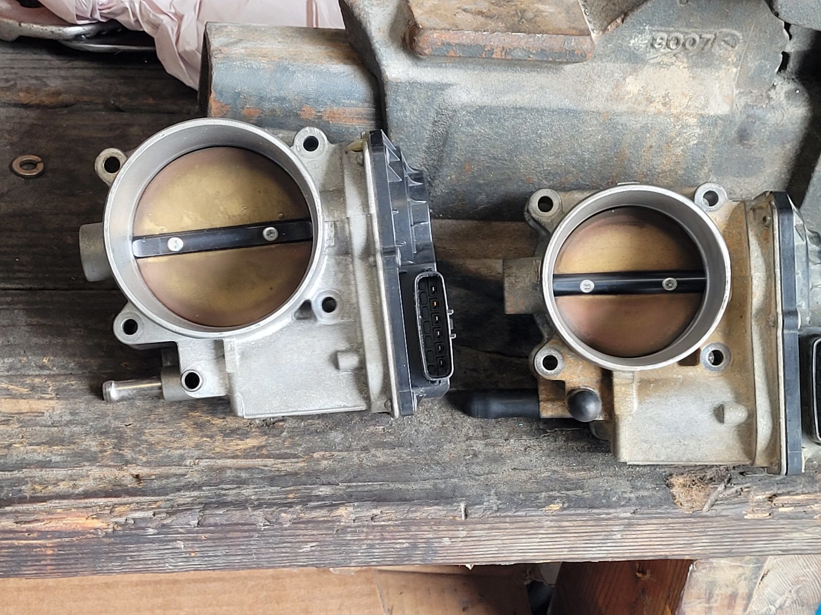

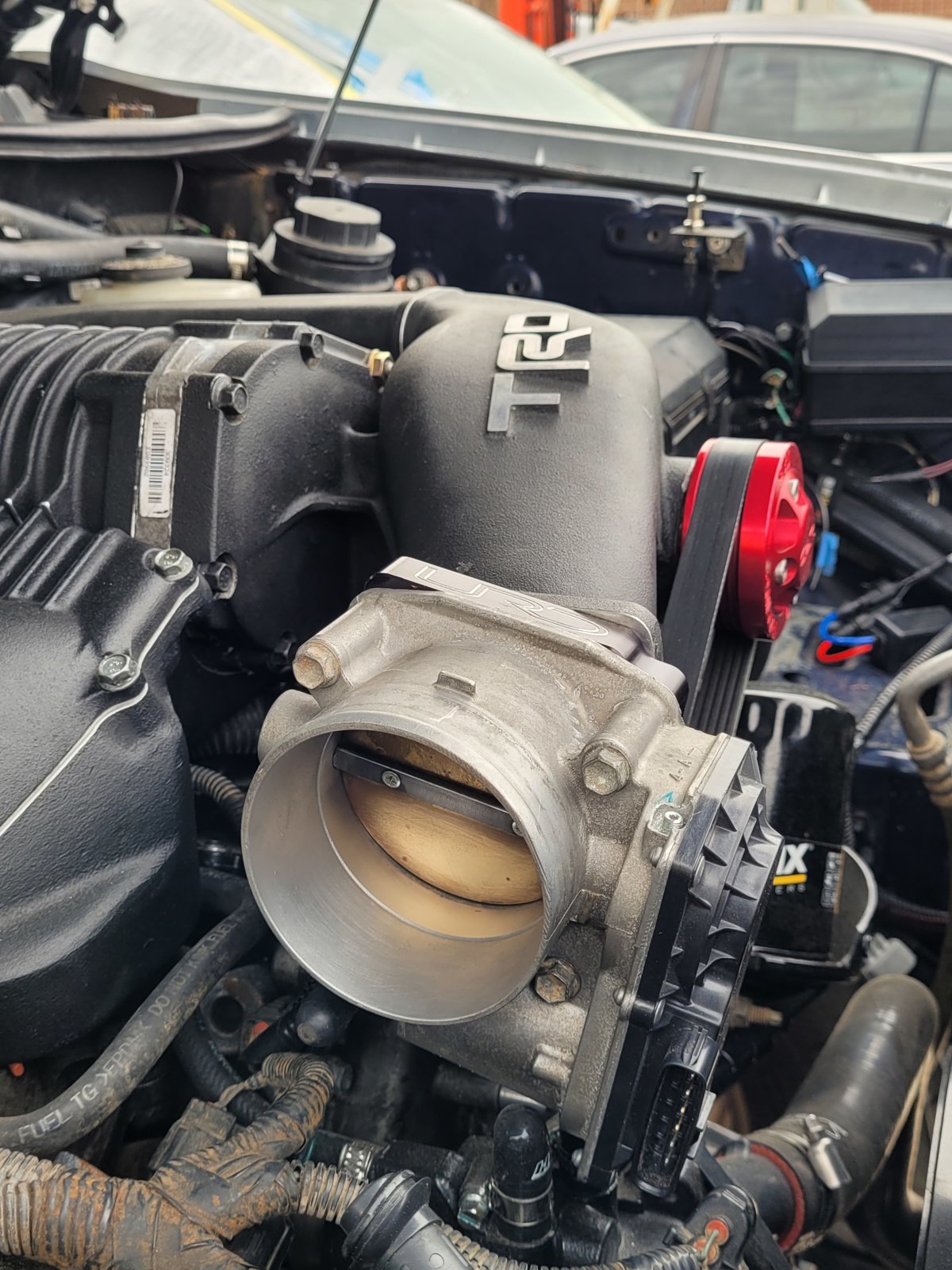

    Got an OEM 76mm tb in from ebay today. Install went super smooth. Throttle response is fantastic! Epoxy wasn't that bad to chip off at all.

    You work fast! That's some good work. 65->76mm right?
