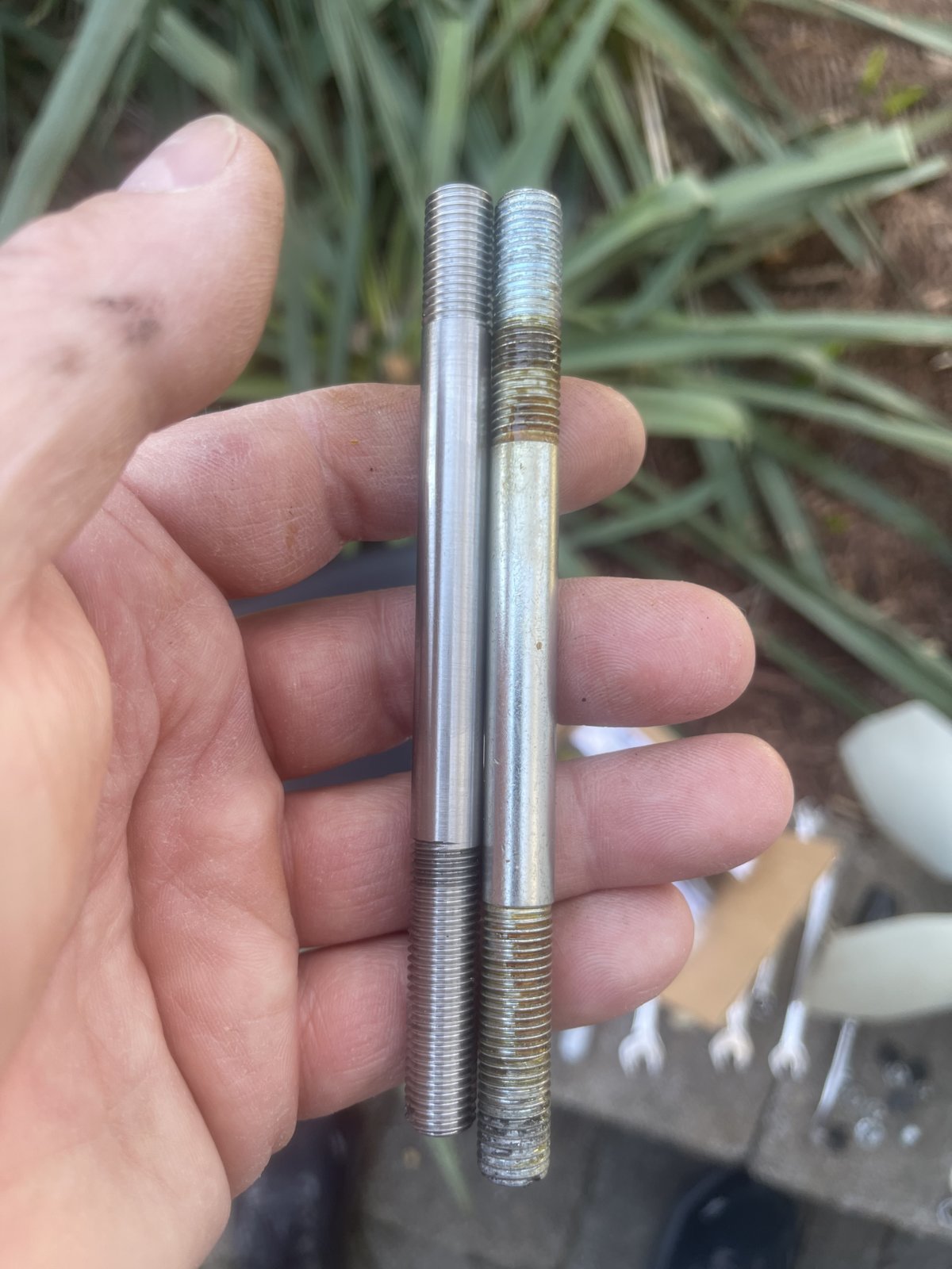

    I’m getting there, this sure as hell beats doing demo in my attic!
    Just noticed this, new studs look quite a bit different from what came off, original is on right. Hopefully this won’t be a problem

    No it will not be a problem. The redesign was to help with problems people were having.

    Gotcha, I figured the shorter inside threads help strengthen the stud, I was just a little worried when I saw the overall length was shorter, and the outside threads went in further. I’m just finishing up getting the new studs in, then that’s it for the day, back to family stuff

    I installed new studs as well. Wasnt an issue. the upgraded lower idler pulley #2 from SCOL was also revised to increase strength.

    Less threads due to breakages happening in the threaded section of the original part. Original part had more threads than needed.
