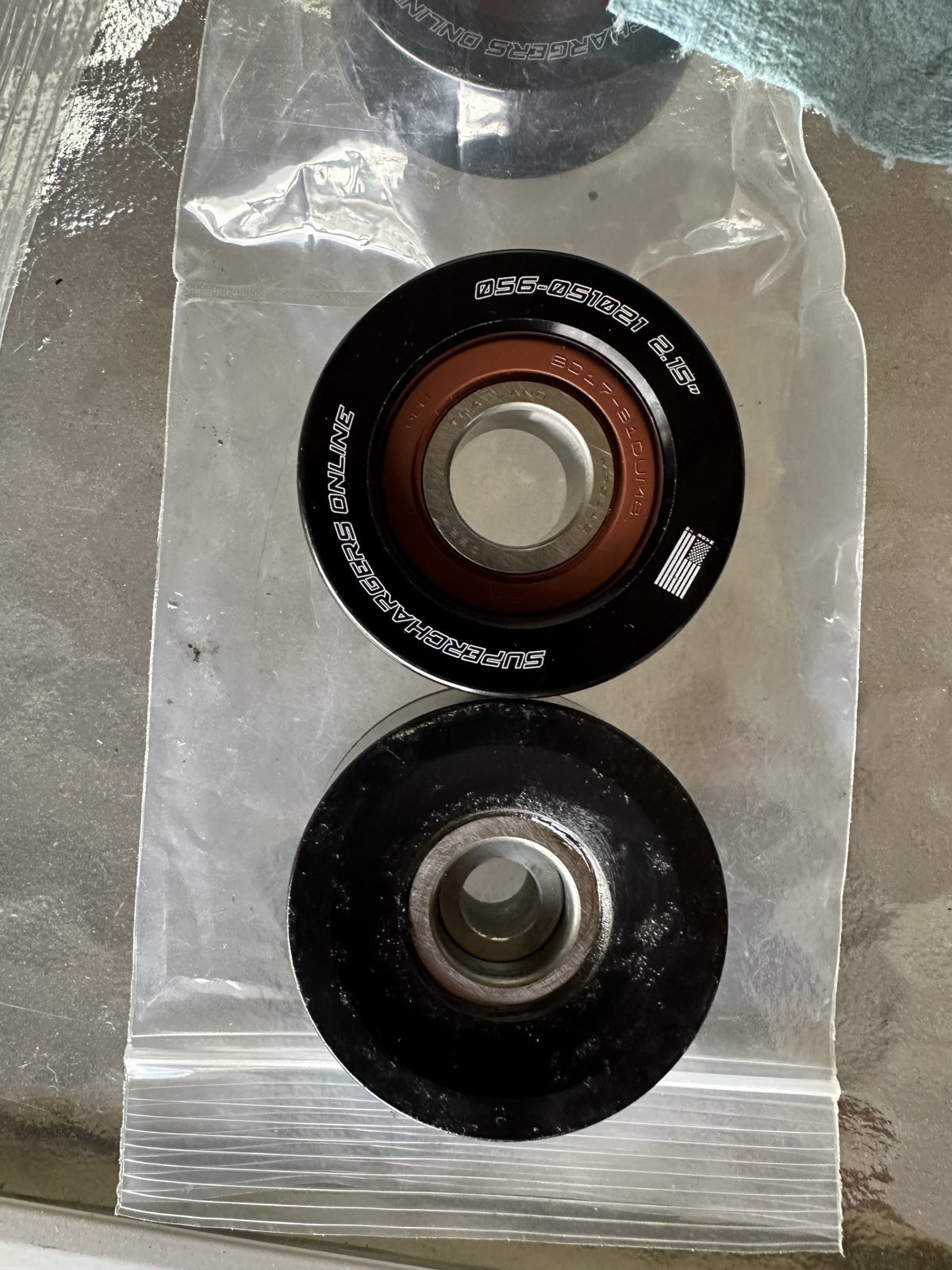

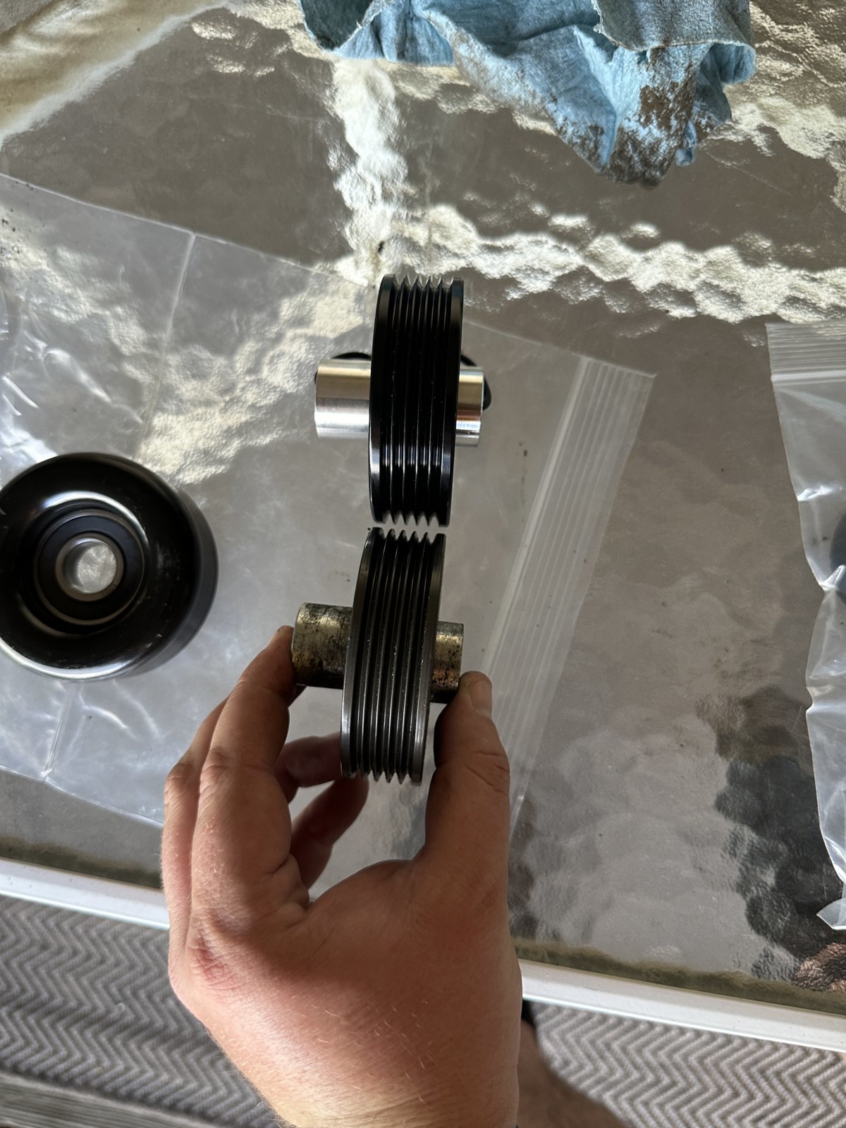

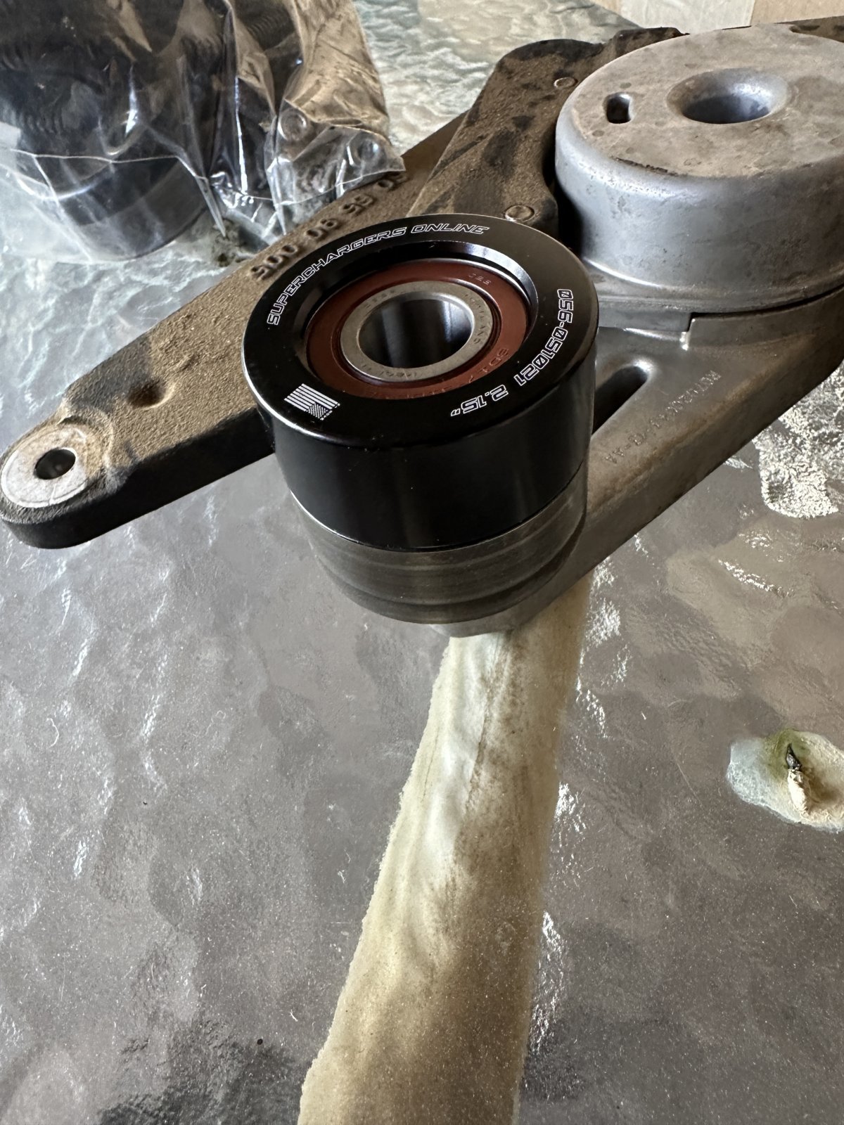

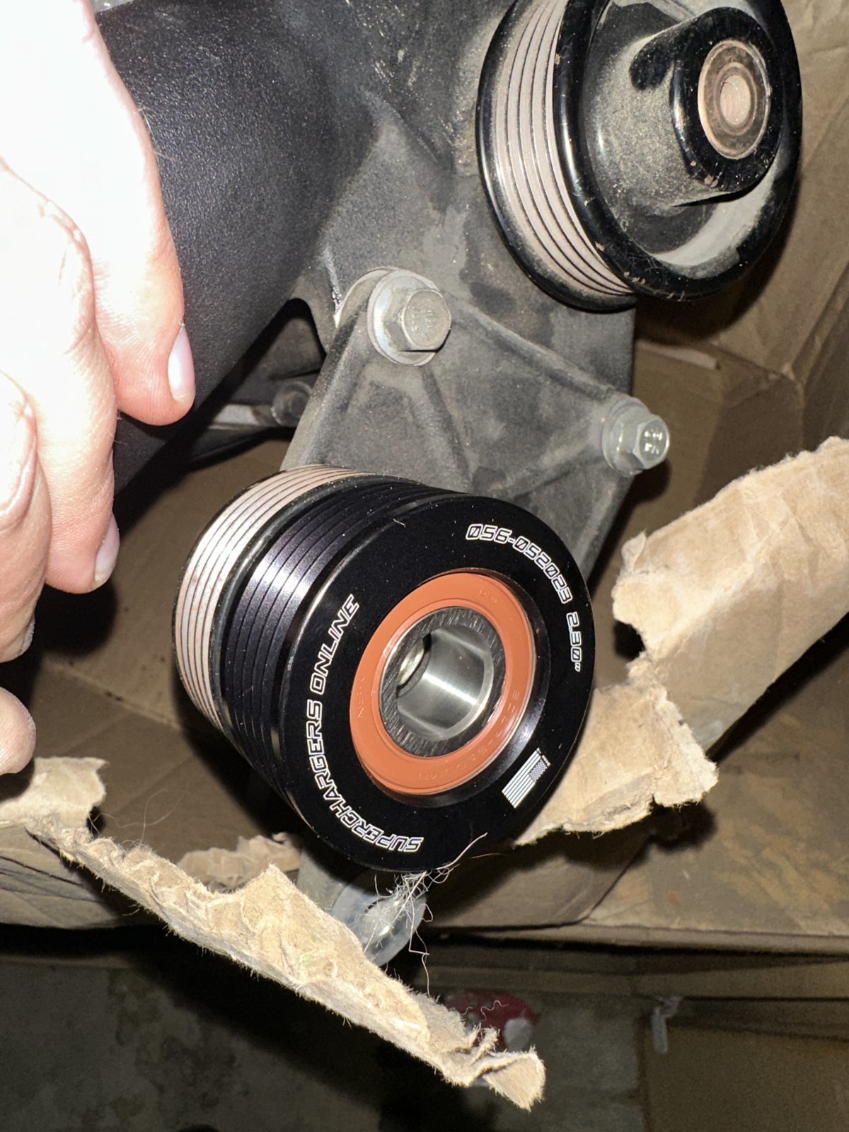

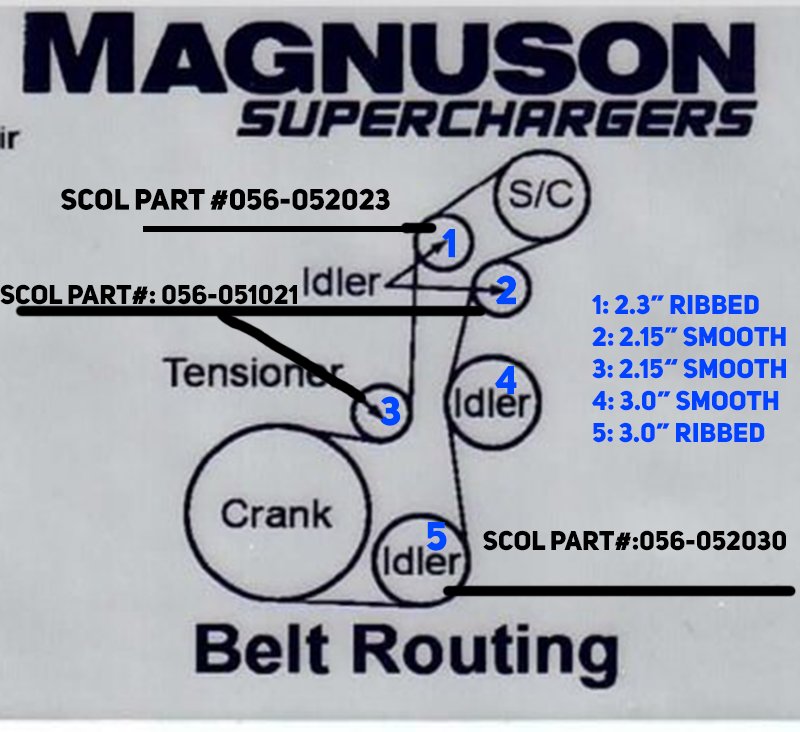

    For those who are interested in the Superchargers Online pulley setup which has beefer nsk bearings than stock, here is what is available.
    SCOL Part #056-052023
    2.3” Ribbed Pulley (Fits upper sc bracket, top pulley)
    SCOL Part#: 056-051021
    2.15” Smooth Pulley (Fits upper sc bracket - bottom pulley, also fits the tensioner.)
    SCOL Part#:056-052030
    3.00 Ribbed Pulley (Lowest Idler Pulley on lower stud next to sc crank pulley). Comes with new machined spacers to fit properly with wider bearing.

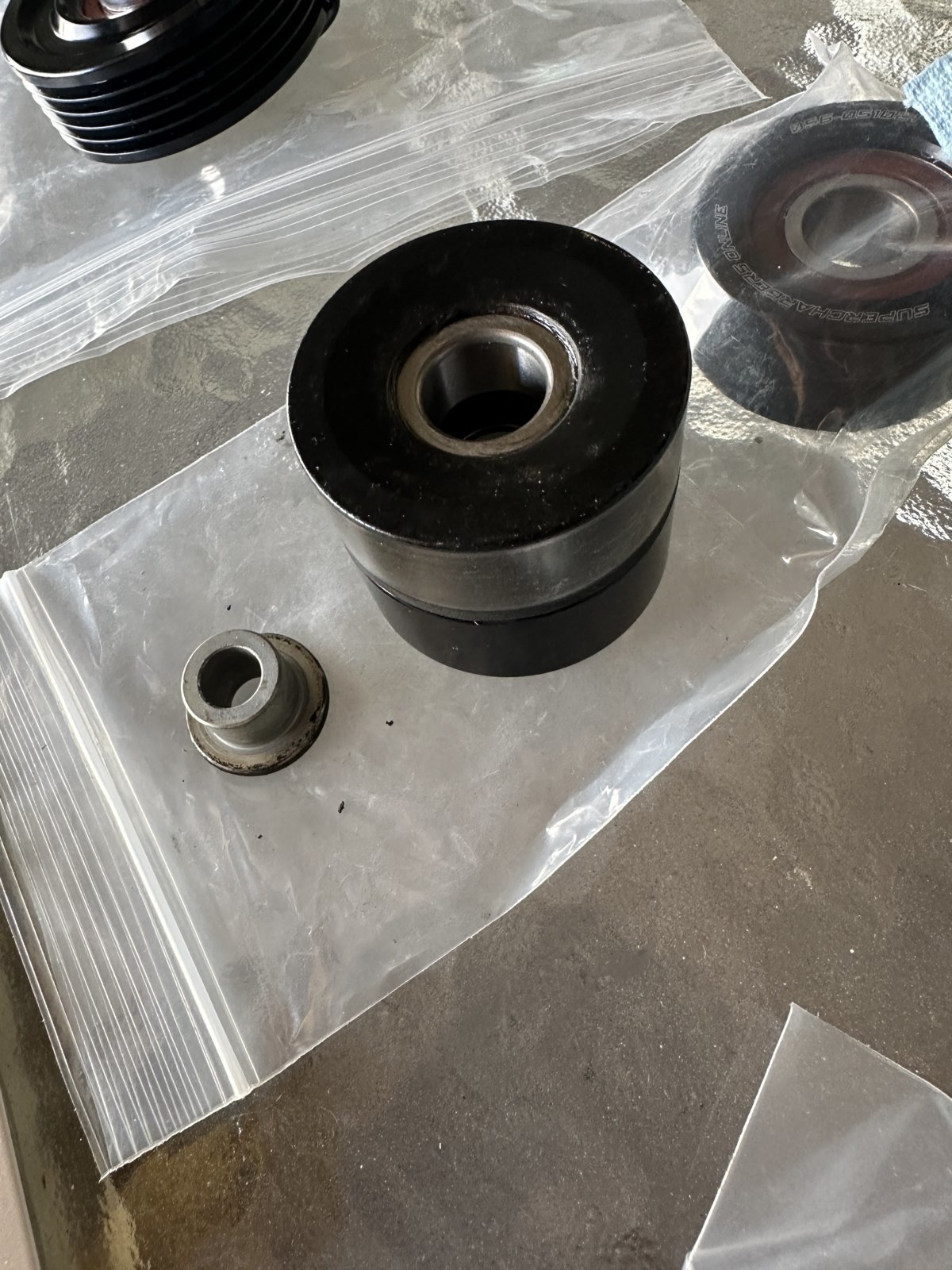

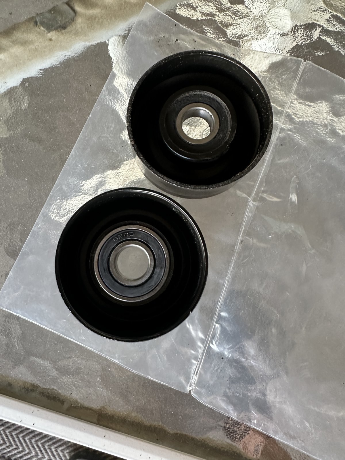

    So the only pulley we do not have a replacement for is the middle idler pulley (Smooth 3” pulley). I am not sure why SCOL didn’t create this, they could have just copied the ribbed pulley and made it smooth and it would be a perfect setup. It would most likely require a new machined spacer as well. This bearing has a better chance at life since it’s a 3.0 sized it doesn’t have to spin as fast as the 2.15 and 2.3 counter parts how ever it is only using a 6203 bearing instead of a 6303 for some reason. I ordered a new pulley as well and I noticed magnuson has changed the design imo for the worst. Check these photos:

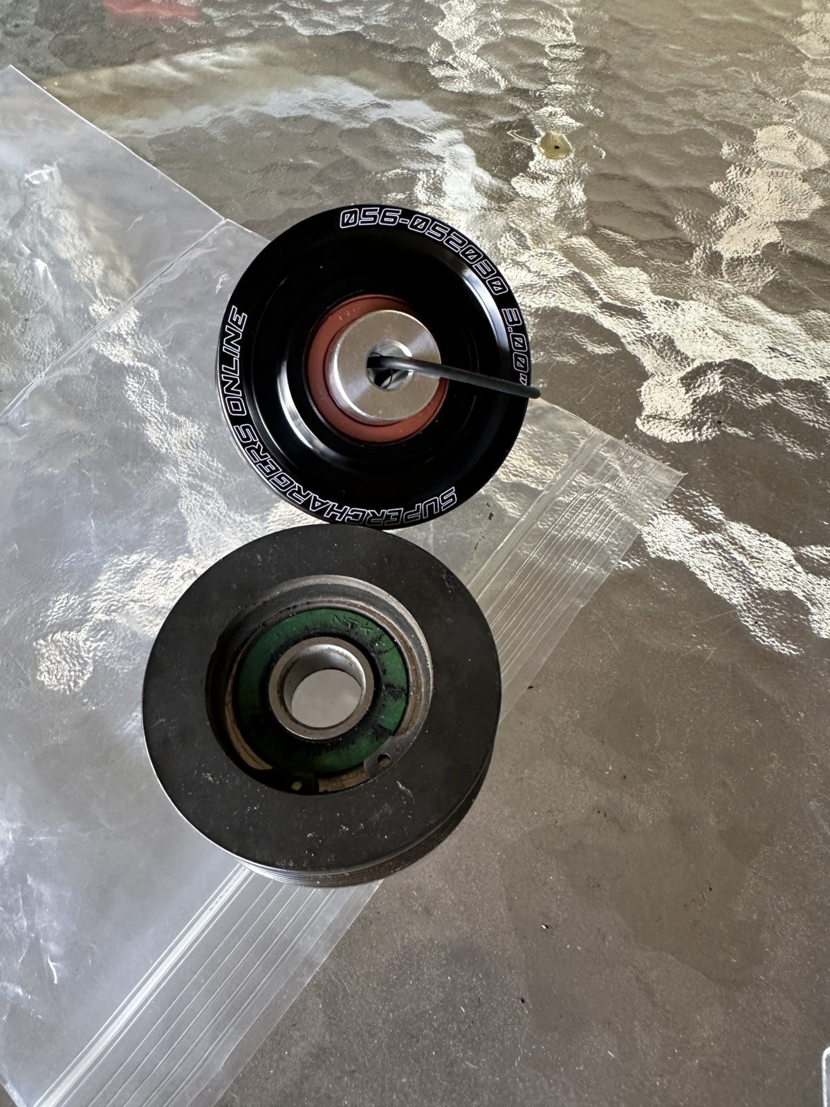

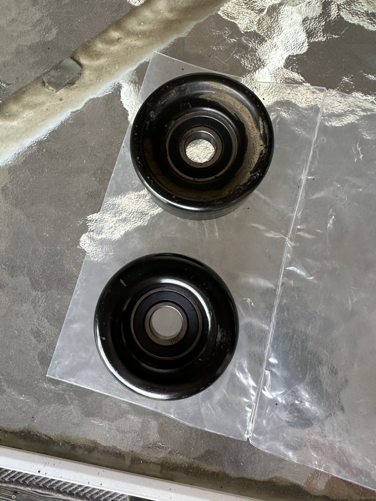

    It may be hard to tell from the lighting, how ever the back no longer has a stop for the bearing. This means it can be pressed in/out from both directions, the down side of this being you can potentially press it too far in or too far out. At the time of writing this post the pulley/bearing combo was $40 at SCOL which isn’t horrible. I just think we can do better. There is a ton of room to work with in this pulley so I don’t see why we cannot have someone make a simple 3.0 pulley that houses a double roller bearing with a groove for a snap ring. This would greatly improve bearing life in my opinion. I haven’t started searching to see what specific bearing SCOL is using for their double roller bearing setup, I know they are using nsk bearings though so I just need to determine what specific size they are. Nsk is notorious for making it difficult to find as most of these bearings have little useful information written on them. I didn’t get a chance to install these today as I wasn’t expecting them to show up on a Sunday. I am going to edit this post in a moment with a picture of the stock pulley setup and which part numbers go where in case anyone is confused.

    @Murphinator rad man! Thanks for taking the plunge. Those look exactly like I was thinking. With the 3.0 smooth. I feel like it's better just to order a replacement bearing if the pulley is in good order. And maybe should have waited instead of ordering a LFP tensioner to avoid grinding. Now I know!

    I agree lol. I think SCOL is using a 2203, 5203, or 3203 bearing. It's really hard to say for sure because my dial caliper battery is dead, so I'm having issues getting a 100% measurement on width. It's definitely 40 mm OD and 17mm ID, width I am having trouble measuring for sure unless I sacrifice one of these bearings and press it out. I just emailed Nate I will see what he thinks about all this.
