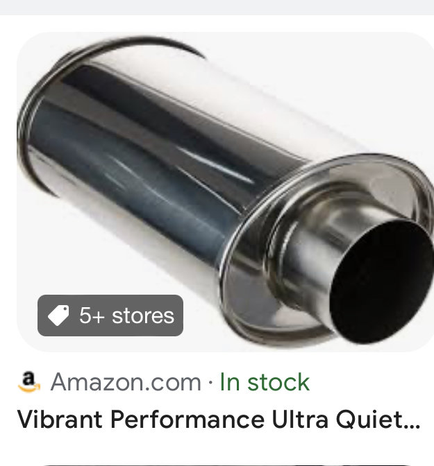

    The goal is to reduce rasp at higher rpm, im no stranger with drone with the last few decades of motorsport modifications and personally raspiness is so much worse. My end goal is to tune the ehxaust note a bit more and how i see it is that more resonators is better than none.
    I was going to go with dynomax race series but saw some good reviews on these total flows. We'll see how the Amazon resonators do. I have everything mocked and tacked up. Going to have it all welded up tomorrow in the morning and installed.
    I did actually do this a couple of years back but eventually got used to the exhaust combo. I do have some trick quarter wave resonators i want to install post y pipe in addition to these mini y pipe resonators. But to answer your question no, I was not as scientific about it this time.
    I just have some vibrant and mbrp resonators, dynomax and thrush mufflers in addition to the welded up stuff i have now. hopefully this iteration is closer to what i imagined.

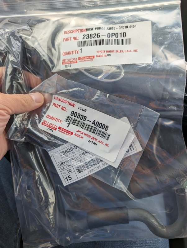

    Just in case anyone needed the part name/numbers for the VSV hose that routes to the s/c and the port cap. My hose split so I figured I'd replace the bits.
    VSV hose purge (pn#23826-0P010)
    Vac plug (pn#90339-A0008)

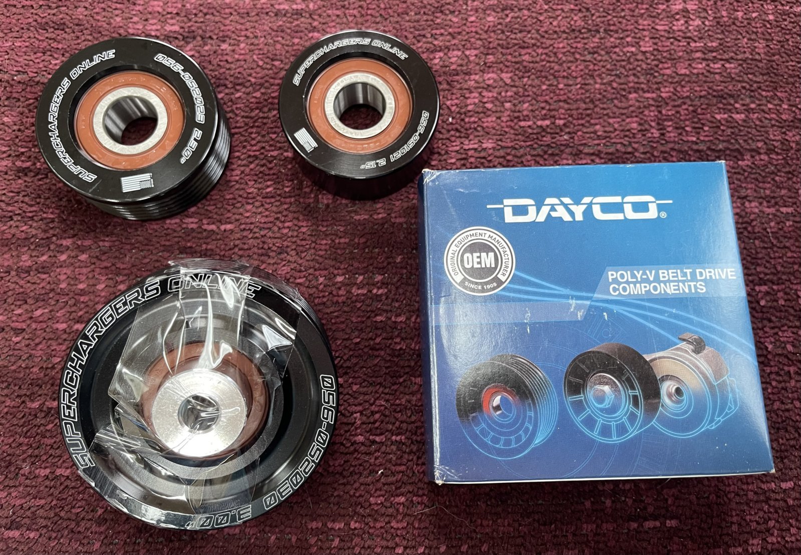

    These just showed up, I’m glad now I have a good spare set.
    My only concern was what @Murphinator mentioned about the big pulley not fitting over the upgraded longer stud. I’m thinking that when it comes time to installing these, I may try lightly sanding the bore of the pulley as opposed to taking anything off the stud. I’m wondering what anyone else’s thoughts might be. I’d be afraid of weakening the stud, even if by a little bit (but hey, what do I know? lol).

    I’m not sure if mine was just a one off issue or what but if you have a drill press just find a bit that can drill out the spacers a tiny bit more. I considered if it would weaken the stud but I was comfortable with the amount I took off
