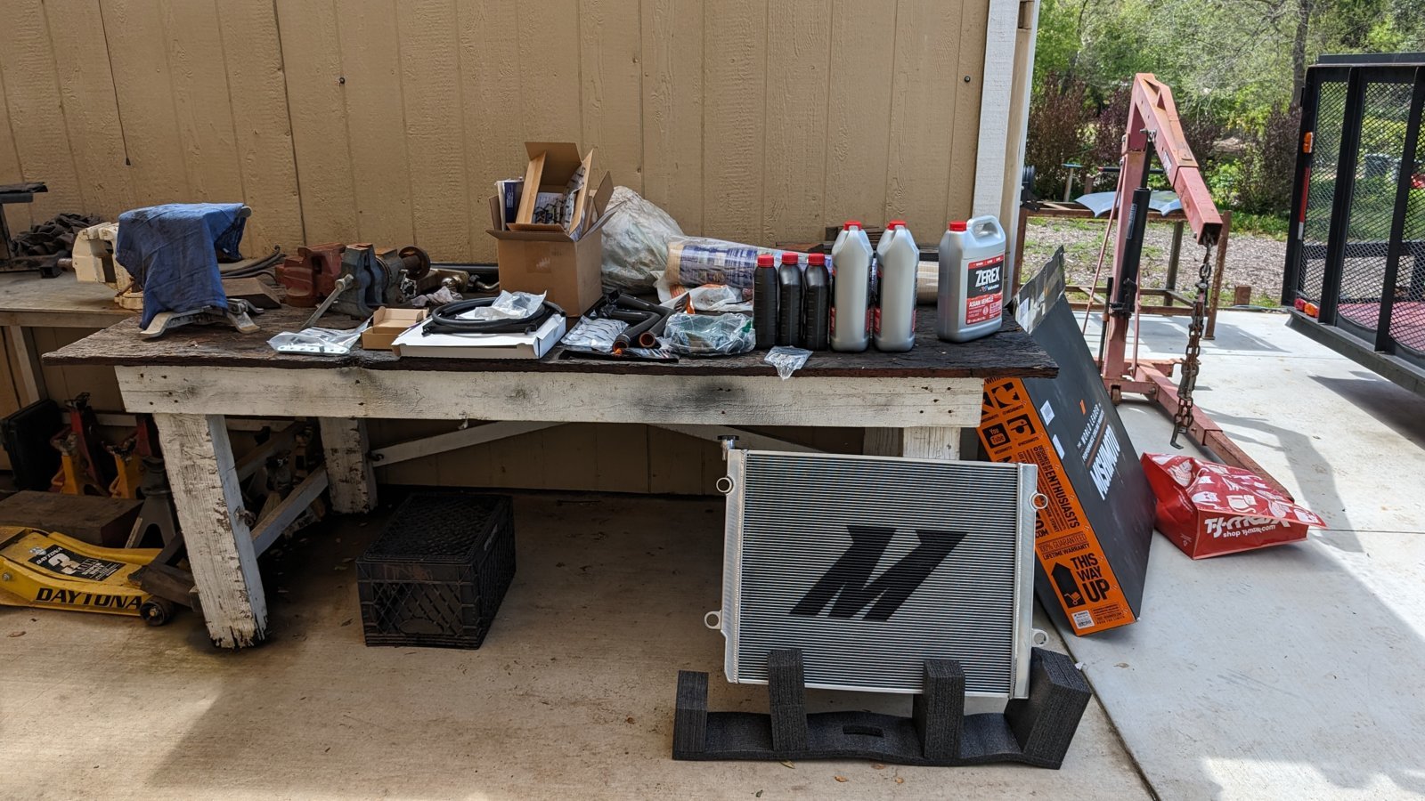

    I'm about to be doing a lot better with a major cooling overhaul hahaPXL_20240406_182730102.MP.jpg

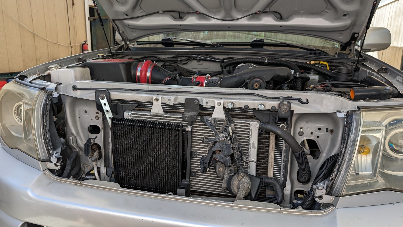

    Well the cooling works haha, couldn't get above 140 on the hour drive home lol I can't believe how effective a $60 little cooler is. Im sure the mishimoto radiator helped too, the size on that thing is huge PXL_20240406_220901499.MP.jpg

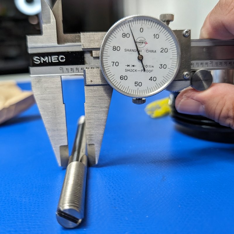

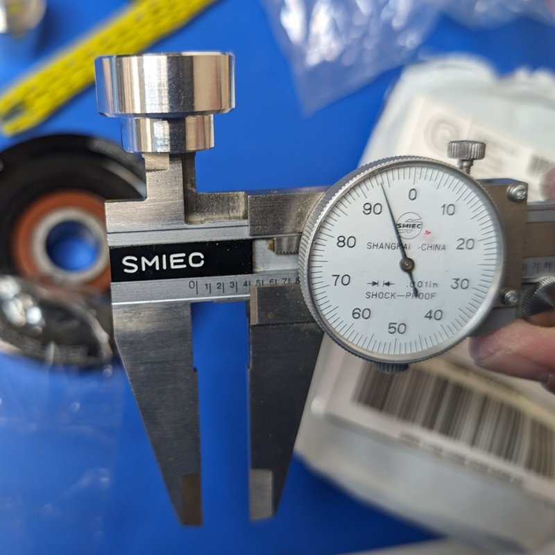

    Just about less than a hair .394 vs ~.3935 1000016546-01.jpg1000016549-01.jpg
