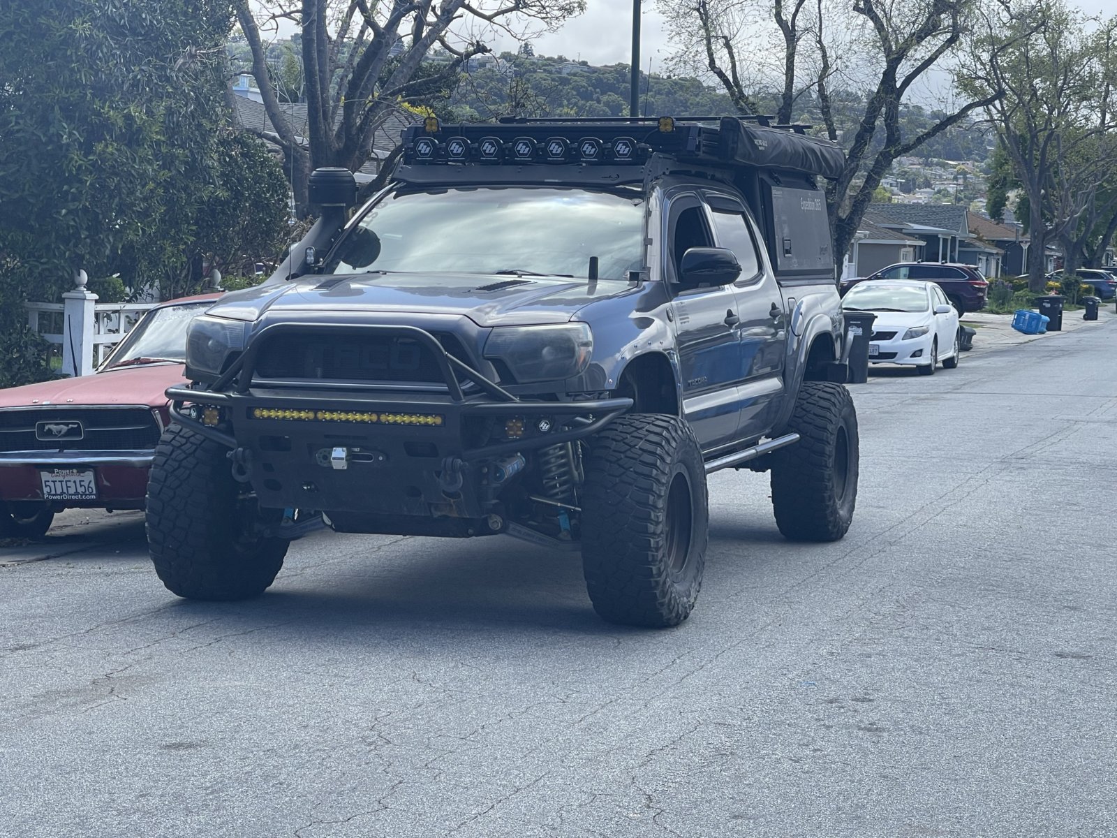

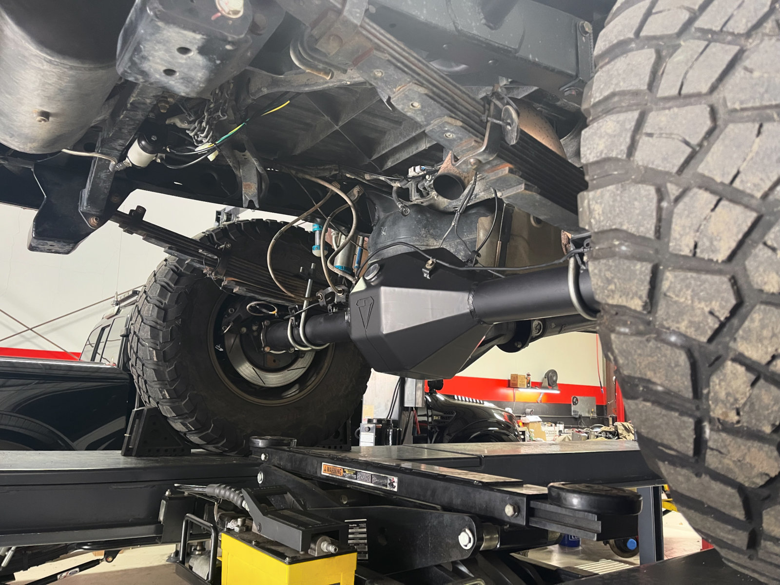

    Yes finally got my truck back! Almost a year of shit! @12TRDTacoma fuel pump is in too! Ha!
    For the folks running the AEM320 pump how loud is it in your setup? My pump is fairly loud. I haven’t ran aftermarket before so wasn’t sure.
    New steering, new gearing and new rear end!

    Holeee Sheeet! Even with the (years in the waiting) fuel pump! Nice rear end buddy hahaha!

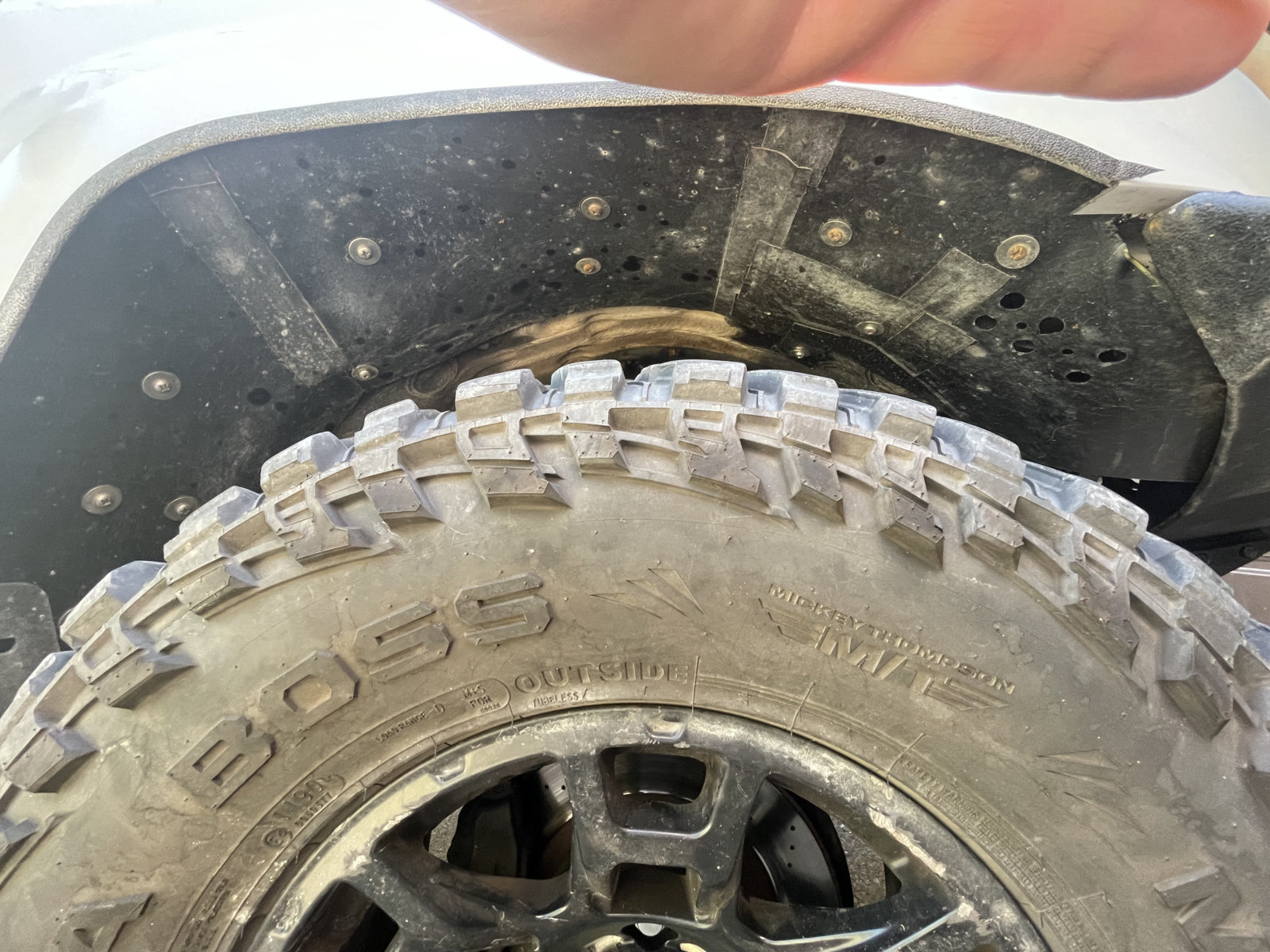

    Just make your own liners. You can buy abs sheets, cut and mold to fit. When I cut my fenders I left the original mounting holes for the flare and bent them inward. The liner profile butts up to the inside of the flare and seals it up ok. Stainless screws, fender washers, and gorilla tape holds it all up. Air mostly comes from the front of the fender well but I added holes to supplement. Held up for a few years now. I have the aFE intake.
    I spend way too much time on gravel to leave open. I'd have rocks hitting my legs in the cab by now.

    That's actually a really good idea and it looks clean. How thick of sheets did you use 1/4"?

    1/16". Took 2, 12"X24" sheets per side.
    Used a heat gun with a wide putty knife to mold it tight to the contours. I put the shiny side out to help the salt and snow wash off easier.
