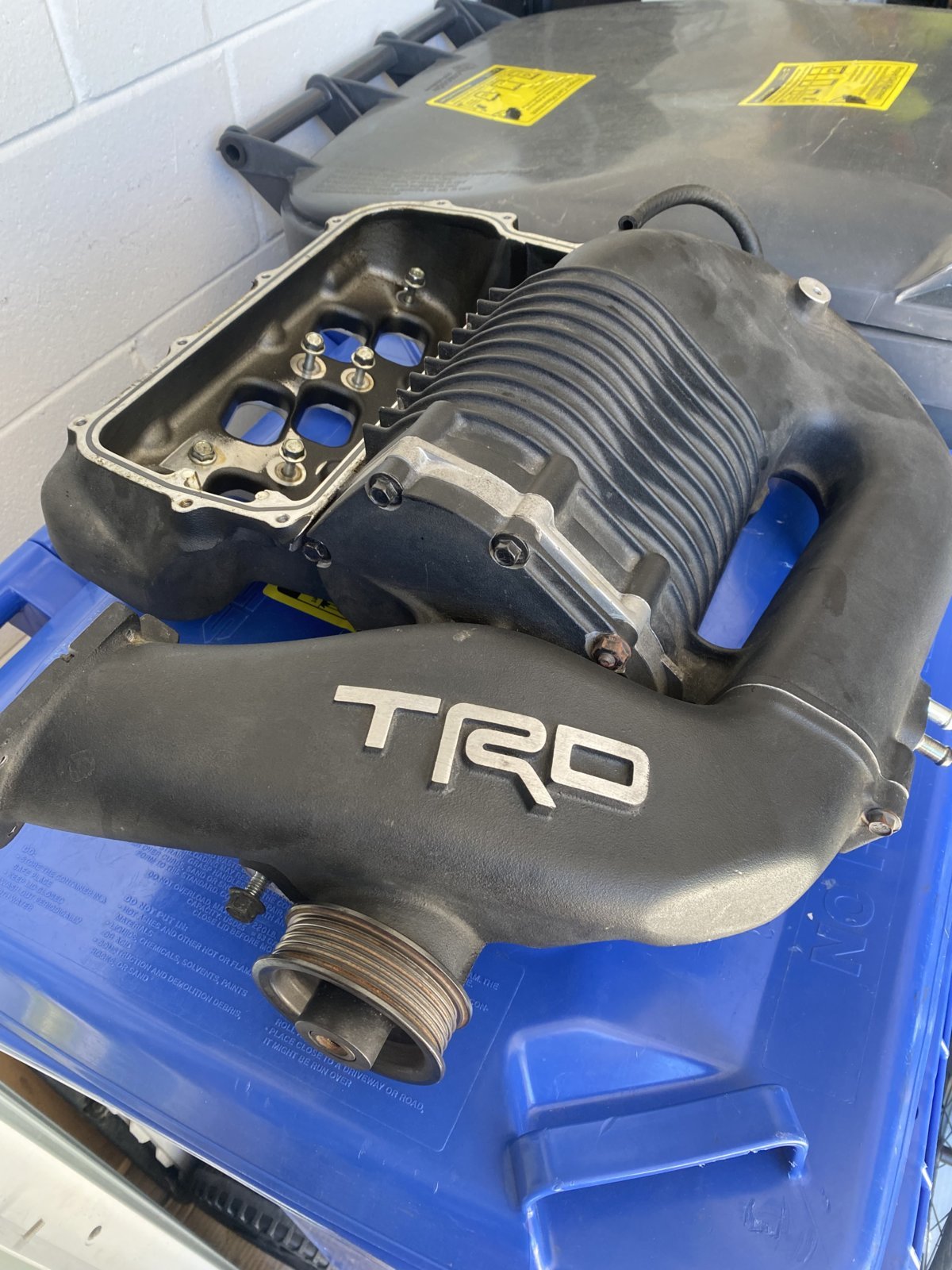

    Turns out only after 20k miles after a rebuild, it’s leaking oil into the rotor pack :facepalm: Going back to the shop. I might pull the plugs and check them hopefully their still good.

    Do you have a catch can? I'm curious if that isn't just blow by from the engine. Then again if it is supercharger oil you would know by the smell.. it smells horrid.

    No catch can, I don’t know to much about the system. Where would the oil be coming from PCV valve?

    Now that you mentioned it I did check the oil on the charger and it was ok looked to be at the bottom of the fill hole.

    Yeah you are getting engine oil blow by. Not s/c oil.

    Issue or is this normal?

    Some blow-by is normal without a catch can.

    like norton said it’s normal. Think most people have about a cup fullish maybe in between oil changes. Depends on how your pcv is acting.

    Totally normal. Your pcv is dumping right into the inlet before the rotors. Mine looked similar when I pulled it off with around 70k miles. I really need to do a catch can. While you have the blower off it’s cheap insurance to replace the pcv valve. Mine was still good but I know people say to swap them out every 100k miles or so. Also clean the intercooler out, I had so much oil stuck to mine it was gross.

    copy, thanks brother will do!
