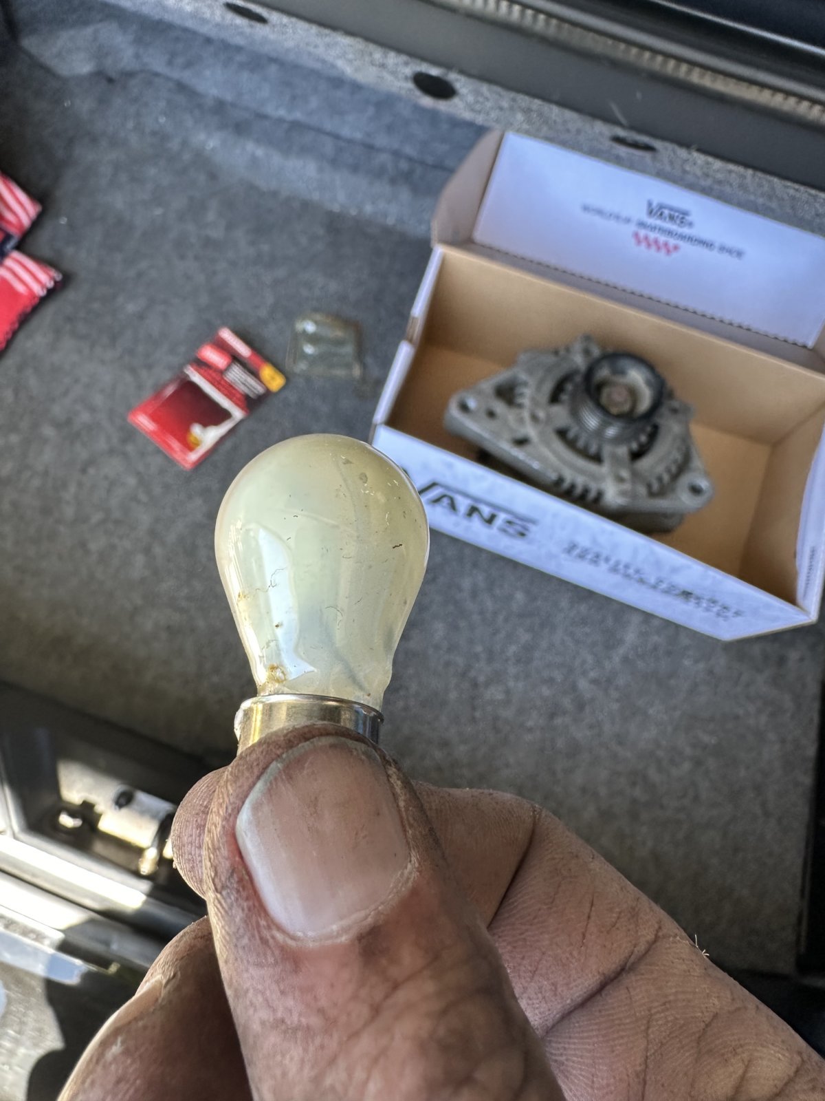

    The alternator can be removed without removing the supercharger belt or tensioner, just need some depth in your vocabulary.
    Hopefully I don't have to do this again for another 12 years or 110,000 miles.
    Billy182 likes this.

    Did you install a 130a? I’ve got the lower output alternator, I’m trying to decide if it’s worth pulling the oem unit and installing a 130 amp. The only upgraded electronics I have are a better fuel pump and a small amp that drives a sub.

    I had the 130 and that's what's going back in later this evening. I was looking at higher output options but I don't want to have to pull the alternator again anytime soon and everything I came across seemed to have mixed reviews so I'm off to the dealer now to pick up the replacement.
    Had an advanced case of brake light glaucoma to deal with in my other car first.
    Athlaos likes this.

    Ok gotcha. I was looking at some of the Toyota dealerships that sell online and all I was seeing for 130 amps were rebuilts. Is that what you decided on or is there a new one still available from the factory that I wasn’t seeing?

    They are rebuild denso units. As far as I know there are no longer new alternators available through Toyota.
