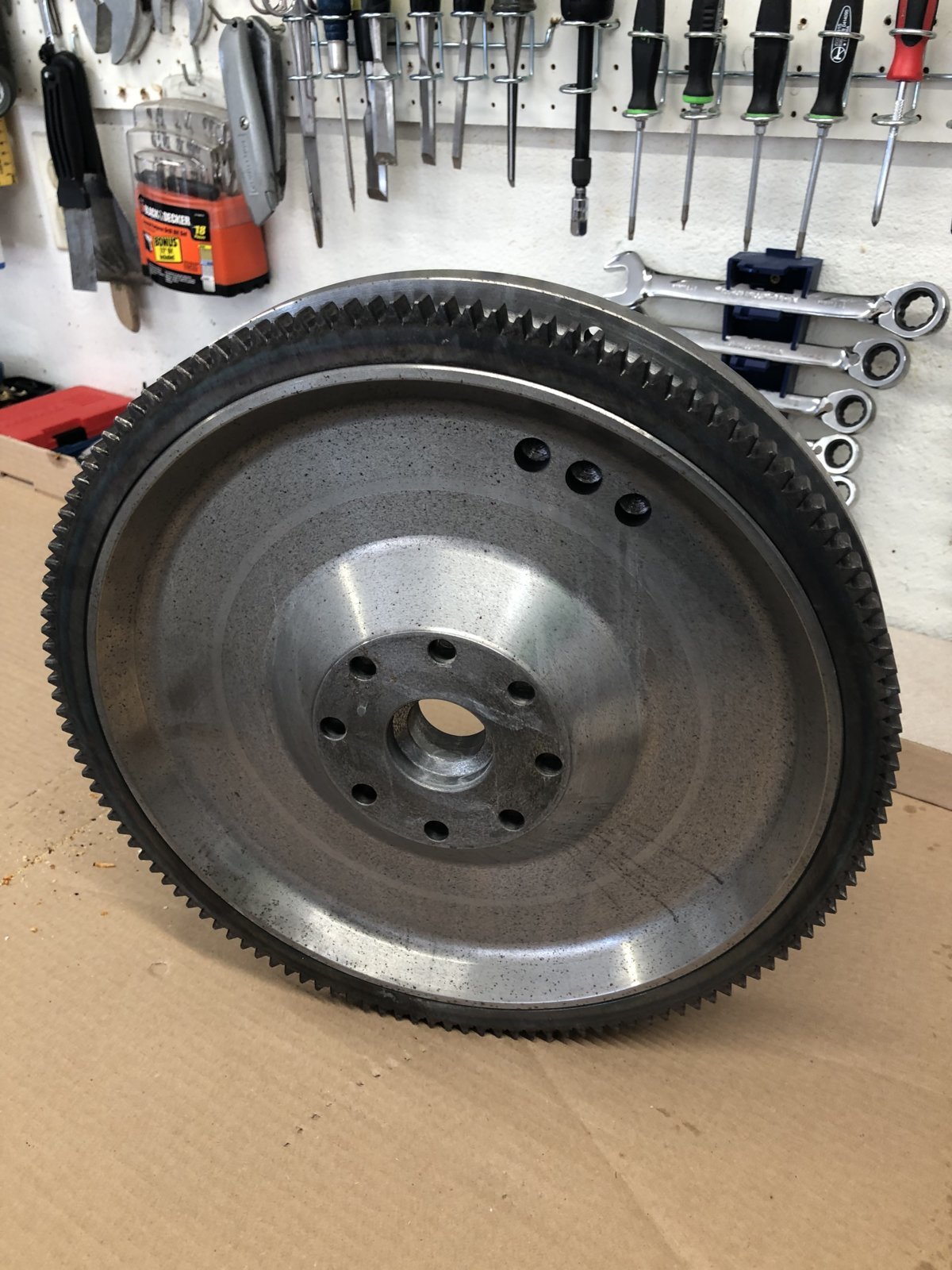

    Anyone looking for a URD flywheel? A Colorado member has one.

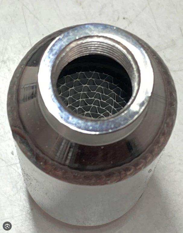

    Spacers or minicats?

    Just spacers. I have seen the mini cats and those are pretty sweet. I don't remember why I didn't do those way back when. Something drove me away from doing them.
