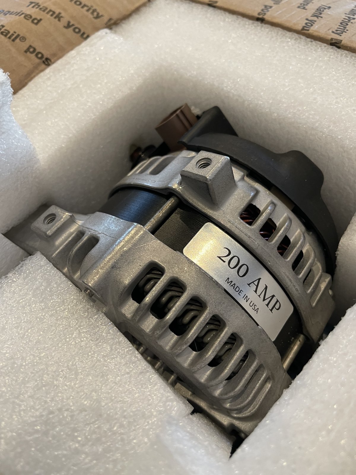

    This came in yesterday, now I don’t have an excuse not to take things apart again. My truck is an x-runner, and nothing big electrical wise other than a small amp, and high watt h4 bulbs. I don’t even need anywhere near 200 amps, but it’s new, and will definitely charge the battery faster. I think the oem alternator that’s still on the truck is a 90 or 100 amp? Either way, hopefully it will be a big improvement.
    ps: from what I’ve seen, high amp alternators tend not to charge well at idle and low speed, thus the usual need for smaller pulleys on the alternator, and resulting higher drag. Just wondering what other members experiences with these BMR alternators are regarding charge at idle speed?
