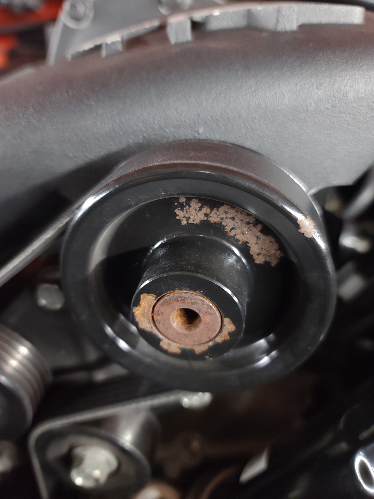

    This rust concern anyone? Lol i dont think it could be that bad as this setup is only 4 years old? Truck was in North Carolina and Texas before that. 17145525606249089091391117149826.jpg

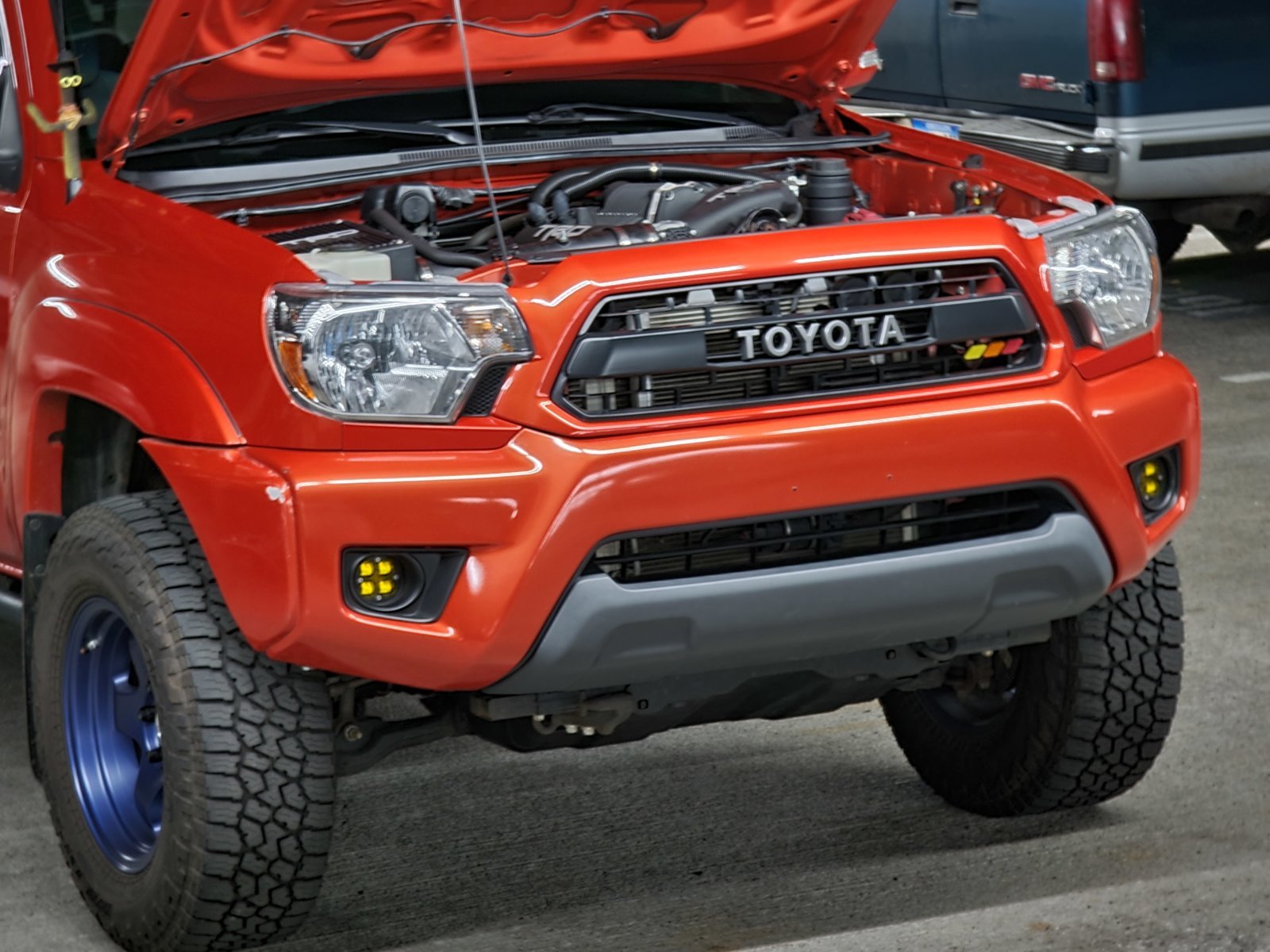

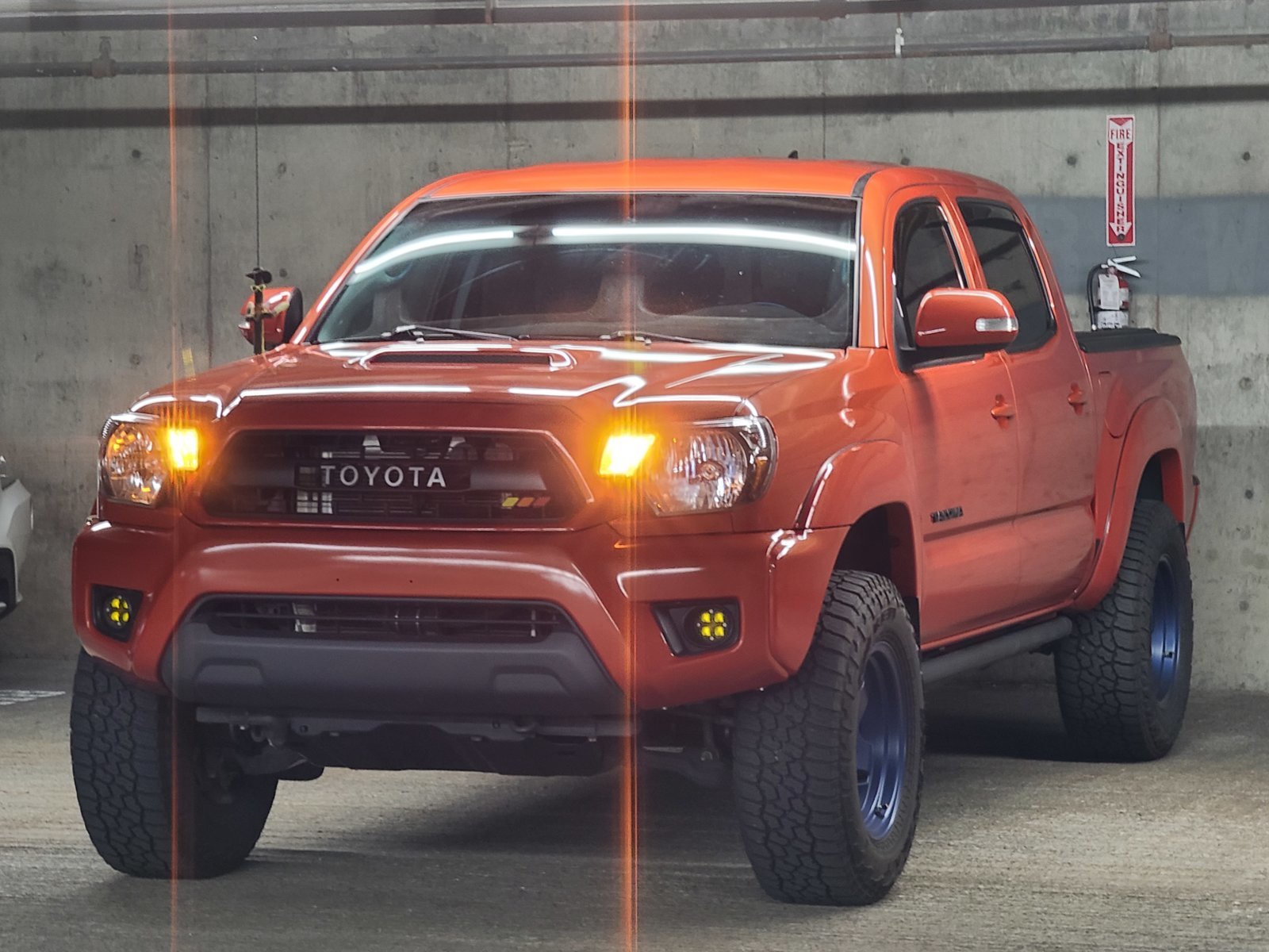

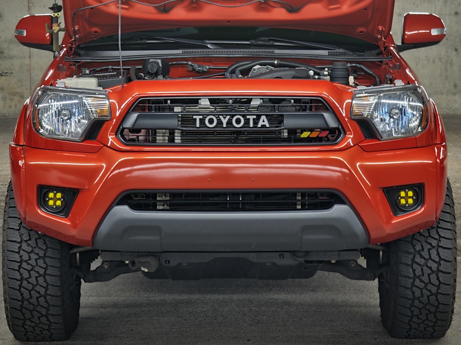

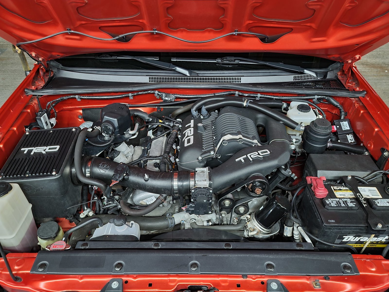

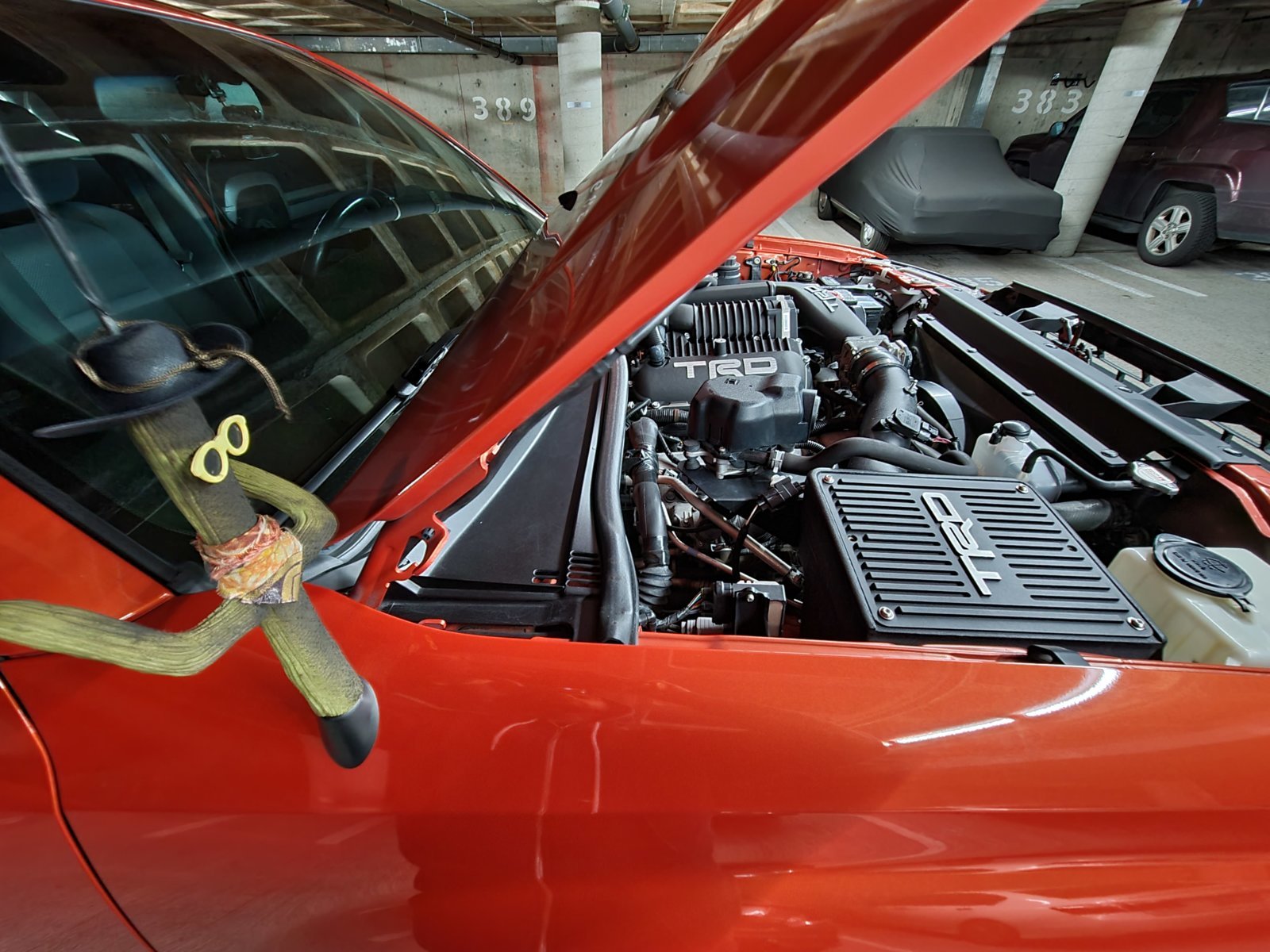

    Some eye candy :) following fresh belts
    20240501_020346.jpg 20240501_020930.jpg 20240501_021048.jpg 20240501_014557.jpg 20240501_021152.jpg
    Can't forget the cactus dudeeeee
