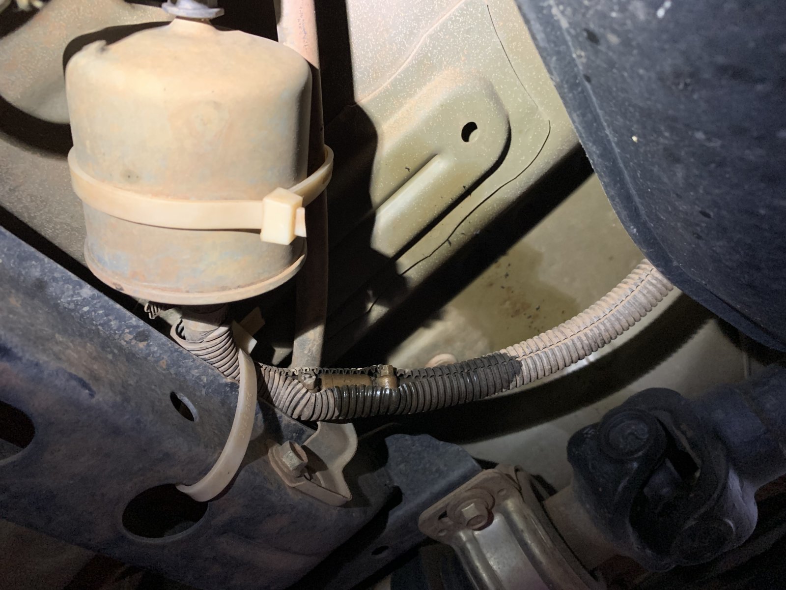

    Do you know if the NAPA one they use has the same fitments and if so I just unclip and clip this one in yah? do i need more fuel line for this or just the filter?

    Where are folks adding the check valve for the fuel pump?

    Ya just drops right in. It's a pretty widely used filter.

    Right in front of the tank at the crossmember. Ignore the leak from the old photo, I was inspecting and ensuring things were all snugged up. Easier than going out to take a new photo.

    ok nice so I can get the filter clip that in then clip line to filter and add the check valve right after it. @SUMOTNK may need to finally stop by and check your setup out.
